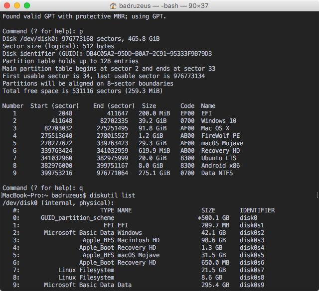

This seems not "Clover Problem", but my fault.
So, I just "DISKPART > CLEAN" my whole HDD via Windows PE, #OFC after made backups: except.. my ESP -_-
I then recreated new GPT scheme with DiskUtility, got new ESP, restoring OS'es partitions etc.
Bootup to macOS via USB Pendrive then install "Clover for UEFI only" onto ESP.
Now, I'm having this issue on UEFI Shell when navigating to ESP (FSX):
cd [DIR] is not a directory
(no issue with Legacy EFI Shell, though)
I've followed dmazar guides as well:
newfs_msdos -v EFI -F 32 /dev/rdisk0s1
or
sudo newfs_msdos -F 32 -b 1024 -v EFI /dev/rdisk0s1
// also manually:
dd if=/dev/disk${1}s1 count=1 bs=512 of=/tmp/origbs
cp boot1f32 /tmp/newbs
dd if=/tmp/origbs of=/tmp/newbs skip=3 seek=3 bs=1 count=87 conv=notrunc
dd of=/dev/disk${1}s1 count=1 bs=512 if=/tmp/newbs
I've also remade "EFI" (/dev/sda1) with gParted under LinuxLive as well, set as: boot, esp.. install Clover using dd commands, writing EF00 as Type code with GPT Fdisk, but weird is.. still get this issue. So, I'm unable booting UEFI mode #atm. I've placed "FAT-64.efi" on ..\drivers64UEFI too.
Is there any missing steps? Thanks.
Edited by Badruzeus
Share this post
Link to post
I think that you did not create that EFI partition correctly as that is not the GUID that an ESP should get but just a basic data partition. There is an issue with ESPs because of FAT being absolutely terrible to determine which version is being used and lots of drivers make assumptions that are not always correct instead of detecting. I think your best bet is to allow an OS installer to create the EFI partition, I personally usually use gparted in linux because it has never failed to work for me on any computer if I just erase and reinitialize the disk to gpt but I also know that windows, macOS, and (all variants I know of) linux allows this in the installer.
Share this post
Link to post
Ah OK, let me try again from scratch with gParted and not using any Partition Label neither named as "EFI". Thanks.
Edited by Badruzeus
Share this post
Link to post
Your partition is 411647 - 2048 = 409599 sectors, but FAT uses clusters. What is your sector per cluster for the volume when you created it? Because
Microsoft's EFI FAT32 specification states that any FAT file system with less than 4085 clusters is FAT12, else any FAT file system with less than 65525 clusters is FAT16, and otherwise it is FAT32.
If you didn't change the cluster size to be like 2 or 4 (-b 1024 flag should be 2) then you end up with less than 65525 clusters and a driver that properly follows the specification would try using FAT16, seems weird that it would be able to display the root directory but just happens to be a weird bug. The volume contains the same information for directories and causes the root directory to be found at cluster 2 where it almost always is because its the first thing.
Share this post
Link to post
Problem #SOLVED, thank you.
I formatted selected Partition 1 (/dev/disk0s1) under Windows PE's DISKPART >
format fs=fat32 quick unit=2k
Manually copy-paste EFI contents into it w/o any extra steps; and created Clover entry from BIOS is able booting Clover (UEFI). Strange is diskutil list it's partition type as "Microsoft Basic Data / 0700: NO NAME", so I then change Type code with gdisk as "EF00" and named as "EFI".
Just bit curious; Isn't it similar to this command under Mac? Weird it didn't work for me previously.. guessing, I did wrong step (or it' s just Windows applied special attributes to ESP?):
sudo newfs_msdos -F 32 -c 2 -v EFI /dev/rdisk0s1
..and I just realized that gParted's mkfs.fat created FAT32 with 1 cluster size for my ESP.
But now, I'm unable booting LEGACY Clover. Previously, this was my Boot Order list:

There's a gpt partition tool gdisk
It is available on Linux
and for Windows
https://sourceforge.net/projects/gptfdisk/files/gptfdisk/1.0.4/gdisk-binaries/gdisk-windows-1.0.4.zip/download
and version for macOS can be complied from the sources
https://sourceforge.net/projects/gptfdisk/files/gptfdisk/1.0.4/gptfdisk-1.0.4.tar.gz/download
It is parallel of fdisk, but for gpt and knows how to do anything you may need to do with gpt.
Edited by Zenith432

11 minutes ago, apianti said:
The cluster size doesn't matter as long as it's 1, 2, or 4, so you end up with more than 65525 clusters. You didn't create an EFI partition, in both gparted and diskpart there is a special way to create an ESP, that you must specify you want an ESP. Google how to make an EFI partition in either. Not sure how newfs_msdos determines whether to make an EFI or basic data volume but probably just the first partition on a GPT or something, or maybe macOS just assumes because of the PMBR that it is an EFI but it actually is not because it did not have the EFI GUID when you showed the device path in the shell.
OK, that's why with diskpart formatted FAT32 I was unable to rebuild Windows BCD;
cd /d z:\EFI\Microsoft\Boot\
bootrec /RebuildBcd
//System Partition not found
I think bcoz it uses "MS Basic Data" type (0700) instead of "ESP" (EF00), right?
Till I manually changed it's type code with gdisk.
Share this post
Link to post
