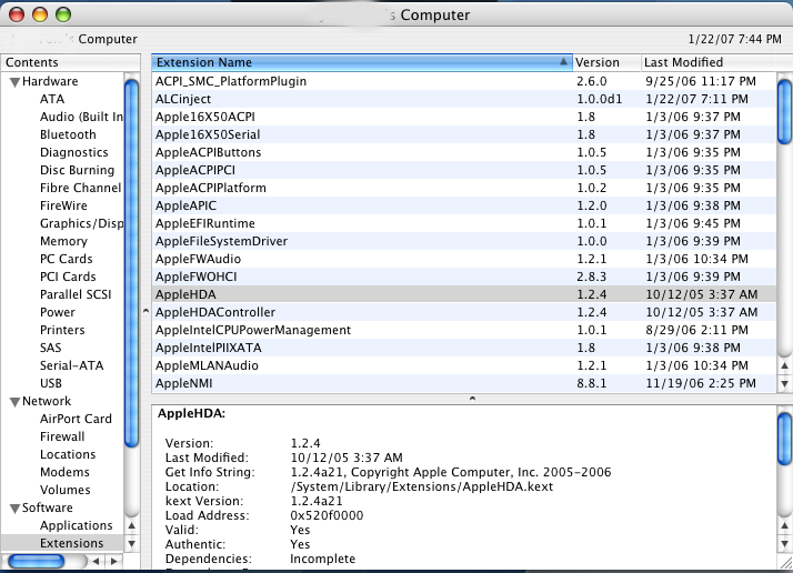

Hi, Taruga, I try your patcher in a Intel915gux, RealtekHDA, 10ec0880, 0x26688086 with no success, attached are snapshots and the codec dump, also, after patching with no success, I replace the AppleHDA inside MacOS and repaired the permissions, trashed the extensions, rebooted and get sound again, but only output 2 channels an input, no mic. Oh, I'm using the Semthex kernel, no panic.
PSD. The patcher detected my computer as a notebook wrongfully, is a desktop.

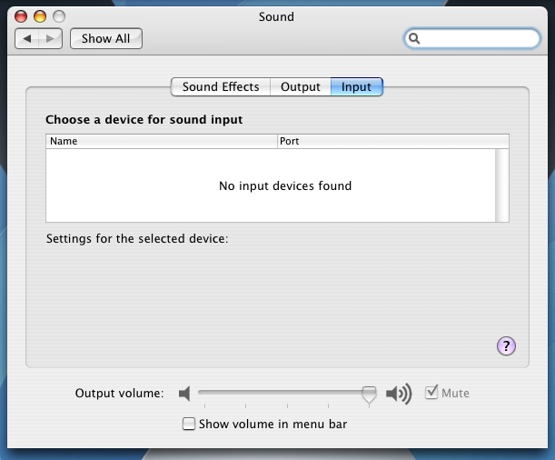

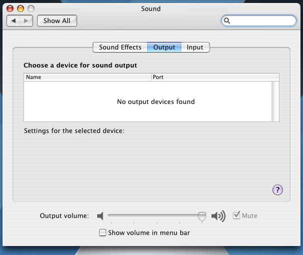

But no sound, no output/input options to select in System Preferences.
Yep, patcher didn´t get all the needed info, the Line In part has only one number (12) there should be two numbers
Best you can do right now to test it, is to edit AppleHDA Info.plist and remove all the lines from Line In, just leave Mic and Speaker to try out
Or look in the line in part for <integer></integer> and replace with <integer>3</integer>
