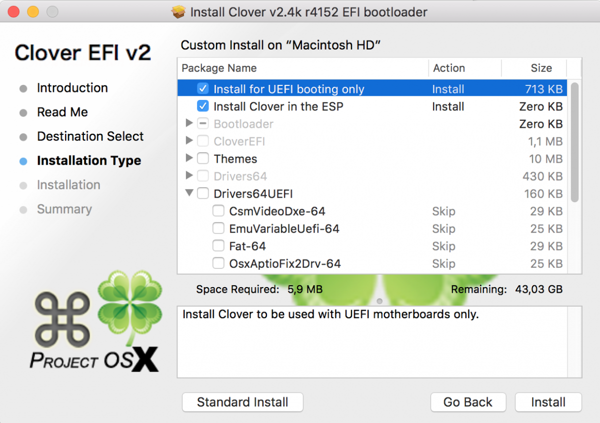

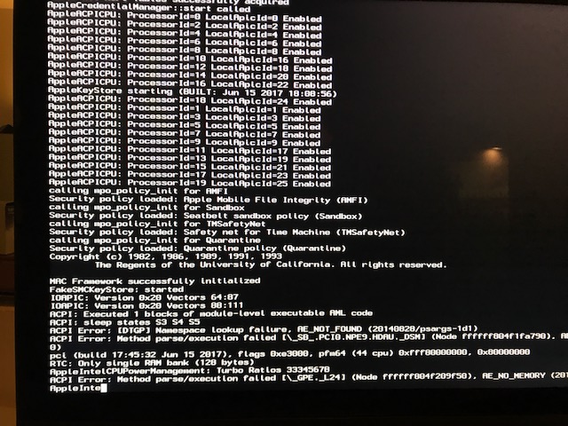

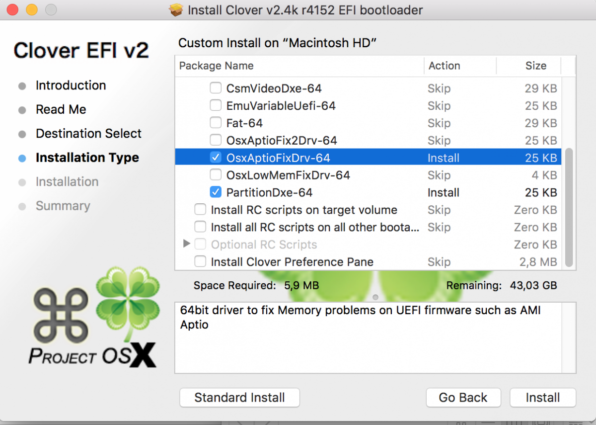

fabuffm Posted August 11, 2017 Share Posted August 11, 2017 Hey folks, i got a stable hack with 10.9.3 (Mavericks) and need an immediate update to 10.12. because my Adobe apps wont work with 10.9. anymore. No i really tried everything what i know, to get this thing updated. Nothing really worked, i cant get through to the install. My System: • ASUS Z9PE-D8 WS (dual xeon platform - only one cpu used) • Xeon E5-2680v2 10x2,8Ghz • 32 GB 1600mhz DDR3 • GTX770 4GB Now i bought a new 500GB SSD to install Sierra 10.12.6 and tried the following: • Formatted 8GB USB -> GUID Mac journaled • Downloaded OSX from the Appstore (on my Macbookpro) • Installed OSX with terminal: sudo /Applications/Install\ macOS\ Sierra.app/Contents/Resources/createinstallmedia --volume /Volumes/USB --applicationpath /Applications/Install\ macOS\ Sierra.app • After installed OSX on the USB Stick, i open Clover -> for EFI and choose two drivers from drivers64efi (screenshot) • Then edited the config.plist one the EFI/CLOVER • Added fakesmc (newest version) into EFI/CLOVER/kexts/10.12 • BIOS settings modified (VT-D disabled, etc. like in my working Mavericks hack) • Booted the stick -> -v Stuck at: PCI Configuration begin (Screenshot) I added my old smbios.plist from my mavericks system, maybe you need this? Please can u help me get this to work? Thx in advance, fabu config.plist.zip Link to comment Share on other sites More sharing options...

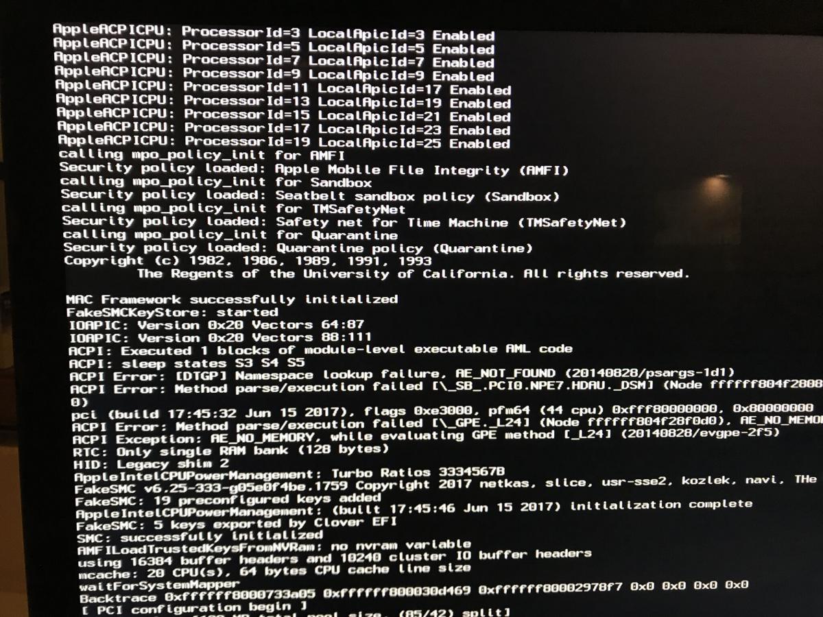

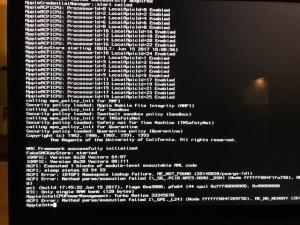

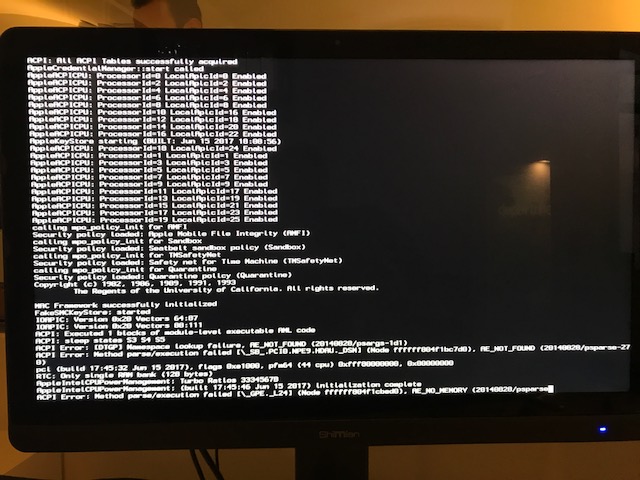

fabuffm Posted August 11, 2017 Author Share Posted August 11, 2017 No - thx. No its going further and stops at "AppleIntelC....." After AppleIntelCPUPowerManagement: Turbo Ratios 3334567B ACPI Error_ Method parse/execution failed Link to comment Share on other sites More sharing options...
fabuffm Posted August 12, 2017 Author Share Posted August 12, 2017 I only installed fakesmc, nothing else. I dont know what clover needs to get thos board running. Link to comment Share on other sites More sharing options...
manumental Posted August 12, 2017 Share Posted August 12, 2017 I'm on a different machine at the moment, but my Z9PE is running well at 10.12.5. This board is very picky about PCI locations, try to plug your GPU in slot 5 and make sure to add the "npci=0x2000" or "npci=0x3000" boot argument to Clover. 1 Link to comment Share on other sites More sharing options...
fabuffm Posted August 14, 2017 Author Share Posted August 14, 2017 On slot 5 i dint get any picture... i got my GFX card in Lane 3 normally (working with 10.9.) Slot 4 got a picture. Do i need to check all slots and try to get to the installer? I booted with: -v npci=0x3000 PCIRootUID=1 (fail) -v npci=0x2000 PCIRootUID=1 (fail) -v acpi=off npci=0x3000 PCIRootUID=1 (fail) -v npci=0x3000 (fail) -v npci=0x2000 (fail) -v nvda_drv=1 (fail) -v nvda_drv=1 dart=0 npci=0x2000 (fail) Link to comment Share on other sites More sharing options...
