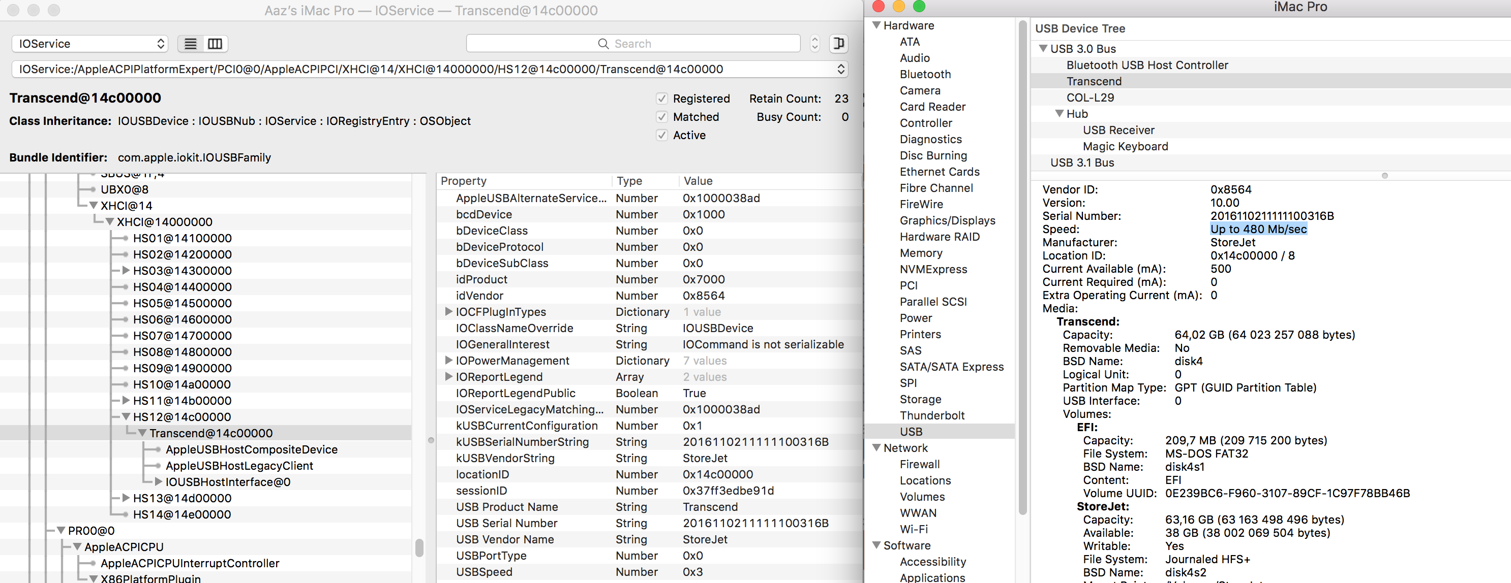

It's too big to attach so I've given you config.plist and a couple of screenshots...

Guys, Hi!
Anybody made usb 3.0 working in HighSierra 10.13.6 (Aorus gaming 3 x299)???I spend a lot of time and now i have everything works fine instead USB 3.0 (it works
as usb 2.0)
Have anybody fully working EFI?
1991886508_ScreenShot2018-11-10at13_31_04.thumb.png.d593be9efb928c37a97b4e4c051e932d.png
