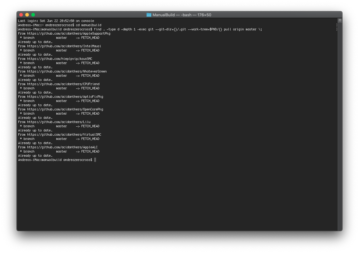

Just now, Matgen84 said:
I use several tools. Can you post your script, please.
First make git clone many github source into one directory, eg "ManualBuild"
After that open your terminal and "cd ManualBuild" press enter, then type "find . -type d -depth 1 -exec git --git-dir={}/.git --work-tree=$PWD/{} pull origin master \;" and press enter,, automatic check now :)
Share this post
Link to post
Thanks a lot :)

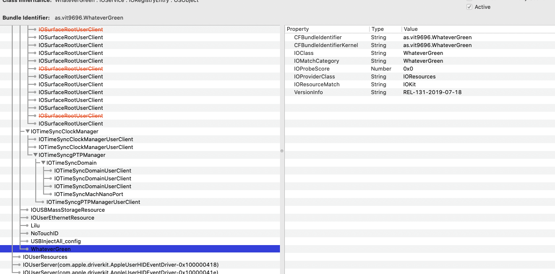

Hello, I have an issue which I wonder if could be fixable via WhateverGreen, or at least maybe an idea of what's going on.
- My system is a Z390, with an Nvidia card. Both iGPU and NVIDIA are enabled via BIOS. Primary card set is iGPU.
- I have a displayport switch, that helps me connect the monitor to one of the GPUs.
- With iGPU selected via the switch, after rebooting or shutting down from Windows, when system reboots or turns on, POST appears normally via iGPU. So far so good.
- For OSX, I disabled NVidia (using WhateverGreen, or DSDT - I tried both methods), as no driver is available. After rebooting from OSX (booted with iGPU), system reboots successfuly (I hear the startup "beep"), but no POST appears via iGPU. This will persist even if I turn off the system and turn it back on. I must switch to nVIDIA to see POST.
However this happens only after OSX was loaded. Any idea what's going on?

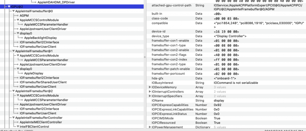

Hi
If I disable my Optimus graphics card with disable-external-gpu property, I don't have any video output through my usb c displayport (connector-type in ioreg seems correct: 00040000).
With Nvidia GPU enabled, I see the external monitor at display @1 under IGPU@2, so the port is wired to the integrated GPU.
The only difference between the two configurations is the one line used to disable the DGPU.
I attach ioreg + log with both DGPU on and off along with my config.plist and kext folder.
Laptop specs:
Dell G3 8750H with Intel UHD 630 + GTX 1060 MaxQ
Let me know if you need more info.
info.zip

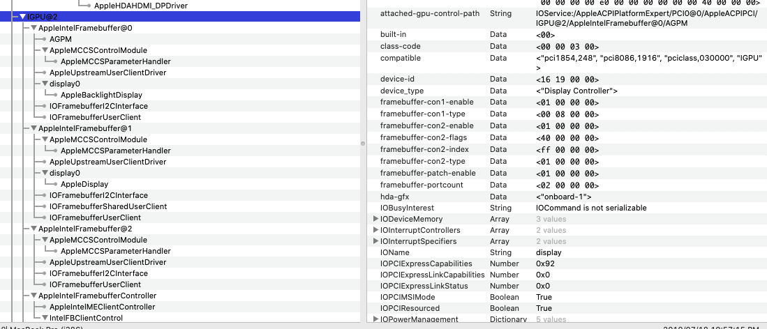

hi. latest WEG is not working framebuffer patch. very strange. i can't disable port and patch hdmi(00 08 00 00)
나의 SM-N960N 의 Tapatalk에서 보냄
here is proved pic
previous lilu 1.3.7 + WEG 1.3.0 are no problem.
lastest other kexts source are no problem. now only WEG happens this issue.
Edited by Sherlocks
