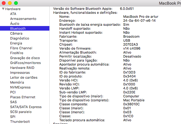

artur_pt Posted July 17, 2017 Share Posted July 17, 2017 olá eu uso esta AzureWave AW-CE123H alguma info sobre o assunto http://www.insanelymac.com/forum/topic/292542-airport-pcie-half-mini/ bom hack Link to comment https://www.insanelymac.com/forum/topic/325375-wifi-bluetooth-ar9565/#findComment-2464936 Share on other sites More sharing options...
