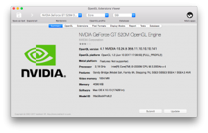

Positif test and result macOS High Sierra EVGA GT 610 2048 Mo ➤ Testing by me  you need to Connect to View image
