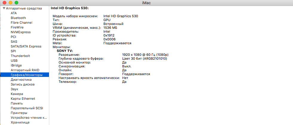

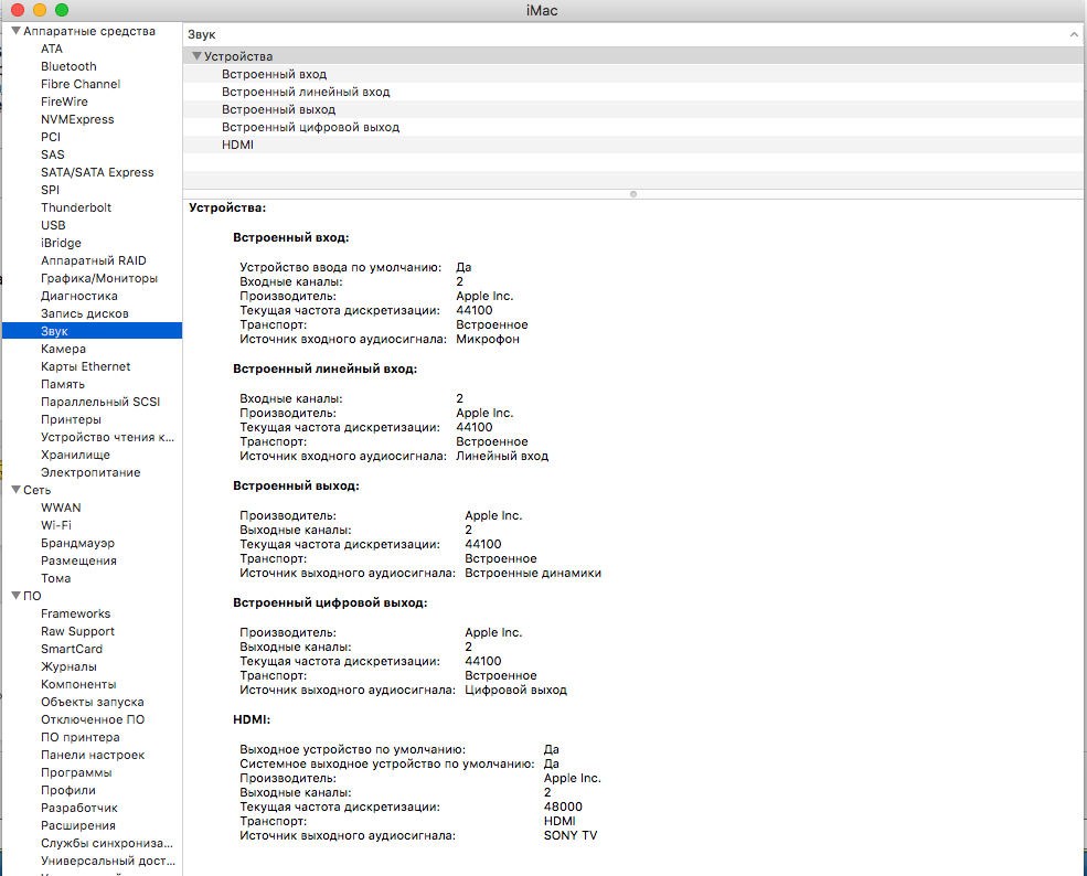

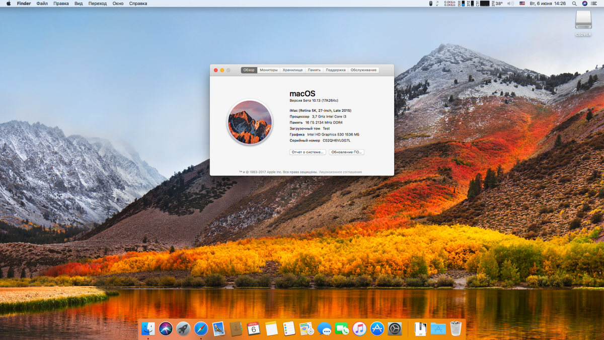

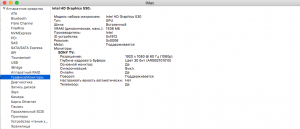

I've installed macOS High Sierra too. Have the same problem with OSInstall.mpkg appears to be missing. Just restore image from real mac.
Image was taken before user creation by @m-dudarev from applelife.ru [Link Removed]
Clover by @denskop Clover_r4079_High_Sierra.zip This version don't work on 10.12... Start it from USB drive.
Intel HD 530 have the same problem as in 10.12.5. But Lilu.kext + IntelGraphicsFixup.kext deals with this :thumbsup_anim:
Used boot arguments for Lilu an Plugins
-lilubeta -igfxbeta -alcbeta
Graphics is working. So smoooooth with metal2 :P
Audio is working. ALC887 with AppleALC, HDMI - native with ig-platform-id 0x193b0000
Don't work hardware acceleration on HD 530 with Shiki.kext and -shikigva bootarg. Problem is Shiki hangs entire system when open QuickTime or iTunes. Need further research.

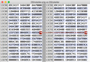

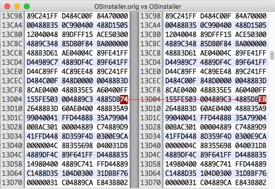

Just for the temporary solution, you can patch OSInstaller to bypass firmware update and check's, but I'm not sure about this
JE - > JMP here
Nice try, but still error as same as OSInstall.mpkg.
