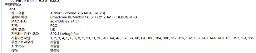

hello
airport extreme fix here
enjoy :)
BCM4352-Airport-Extreme, (credit skvo)
com.apple.driver.AirPort.Brcm4360
6b100000 750d
6b100000 9090
10.13.x
BCM4352-Airport-Extreme, (credit Sherlocks based on skvo original)
com.apple.driver.AirPort.BrcmNIC
6b100000 750d
6b100000 9090
BCM4352-fvco, (credit Sherlocks based on the-darkvoid original)
81f952aa 000074bf
81f952aa 00006690
BCM4352-iovar, (credit Sherlocks)
85db4c8b 65c87971
85db4c8b 65c8eb71
4883c410 89c385db 7946
4883c410 89c385db eb46
com.apple.driver.AirPort.BrcmNIC-MFG
6b100000 750d
6b100000 9090
81ff52aa 000074c4
81ff52aa 00006690
0f896201 0000
0f886201 0000
4883c410 89c385db 7944
4883c410 89c385db eb44
Share this post
Link to post
hello
enjoy :)
BCM94352-Airport-Extreme, credit Sherlocks based on skvo original
6B100000750D
6B1000009090
6B100000750D
6B1000009090
BCM94352-fvco, credit Sherlocks based on the-darkvoid original
81F952AA000074BF
81F952AA00006690
81FF52AA000074C4
81FF52AA00006690
apply these in addition to those used in Sierra or use only these patches and omit earlier ones.
