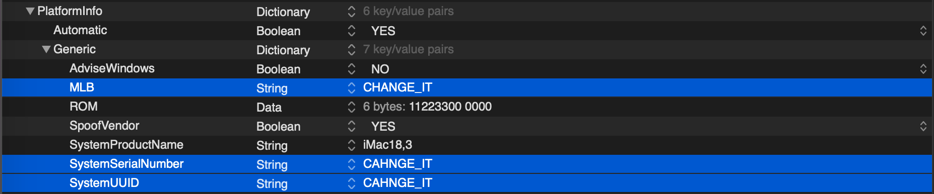

Ok guys, as promised here's my EFI folder for macOS Mojave with clover revision r4679
You need to add the serial numbers, MLB, and other private data. Just reselect the iMac17,1 SMBIOS to generate the new data.
Cheers

Great. Thank you. After I create the new Serial, MLB etc and save the config, do I have to replace or merge the EFI Folder on the Boot Stick with yours?
Share this post
Link to post
You can replace your EFI with mine but you might need to add your own DSDT/SSDT files, or just replace the config.plist, kexts and the drivers if you like.
Just make sure you backup your own EFI before replacing it.

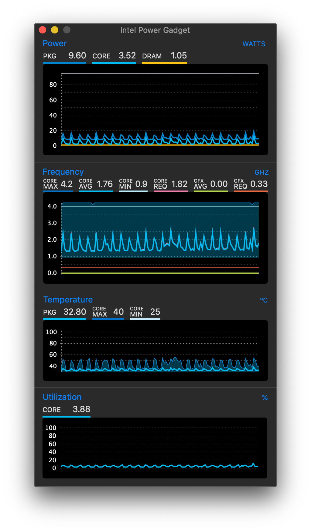

      What is working:
      BCM94360HMB Wifi and Bluetooth AirDrop, Handoff, FaceTime, Messages, App Store, iCloud, etc. Intel HD 530 (QE/CI tested, but now I'm using it in headless) Sleep RX 5700 (QE/CI with 2 1080p monitors connected) Sound (all ports) USB Ports Two Ethernet ports macOS with a light OC (4.12 GHz - 4.5 Ghz, XMP, ASUS optimal) No problem so far ASUS HyperKit with a KINGSTON NVMe SSD - 250 GB Hardware decoding/encoding on both HD 530 and RX 5700 iGPU QuickSync is used in the default config.plist To use dGPU for hw decode/encode you need to disable iGPU in BIOS and boot with "config_dgpu_enc_dec.plist" (this will use iMacPro1,1 SMBIOS, so you may need to resign in to use your iCloud) System Integrity Protection is Enabled by default. If you need to boot with SIP disabled you may use "config_debug.plist" or disable it manually in Clover settings. If you want Enabled SIP but with allowing unsigned kexts you may boot with "CsrActiveConfig = 0x01"
      What is not working:
      Not tested:
      Thunderbolt (no equipment)
      Issues:
      None

      Download Clover Configurator and generate a new Serial Number for yourself

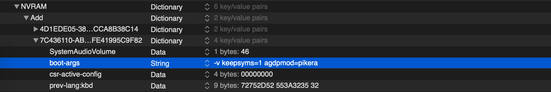

      2020.04.22: Deleted unnecessary boot-args, can boot without any custom boot-args (except agdpmod=pikera for RX 5700), updated bootpack
