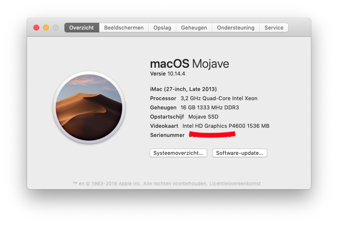

The system boots fine, but iGPU does not work. It is listed under PCI devices in System report, but not under graphics. Also I got a kernel panic:

EDIT:
I changed the platform id to 0d220003 and now the iGPU works :D
85103122_Schermafbeelding2019-04-12om09_40_45.png.a32de7a26b9fcfac2ff1138225d5f8e2.png
The only issue that's left seems to be that upon reboot from macOS, the system hangs upon Clover initialization. I have to hard reset in order to boot up
