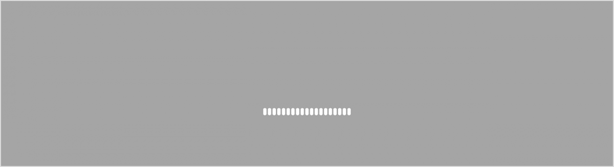

One little step ahead: I found out that SSDT.aml was causing problems with size of /var/vm/sleepimage, after removing it I was able to get more consistent size of 4GB that corresponds with size on my Macbook where sleepimage is always 1/2 of memory.
Also, waking up from hibernation is more consistent now: I get grey hibernation logo with progress bar the the bottom (like in attached pic).  progress bar fills up but then machine freezes there. I have USB mouse with LED inside and while progress bar fills up LED light is on but when machine freezes led is turning off, so seems like entire USB system gets shut down.
There are no log entries into system.log after machine wakes up.
Another interesting aspect is that when I power off / on the machine after freeze it goes through normal boot sequence but once OSX starts I am not present with usual login screen for all users, I get to input password for my user that was active when I put machine into hibernation. There are also all applications I had open but they are clearly freshly restarted.
Anyone has a idea what could be happening?
