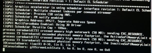

Anyone tried upgrade to the latest beta with single HD 530/630 graphics? After update graphics didn't start. Can't reach desktop.
Stops on this lines. Tried all available ig-platform-id's and booting without graphics injection at all. Nothing :(

Already made a comparison between the IntelHD kexts?
Maybe something has changed there.
Yes. Too many changes. They are completely different. Change AppleIntelSKLGraphicsFramebuffer.kext from 10.12.5b1 to enter desktop.
