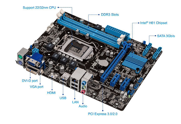

[Guide] macOS Sierra 10.12.x on ASUS H61M-A / DSDT
