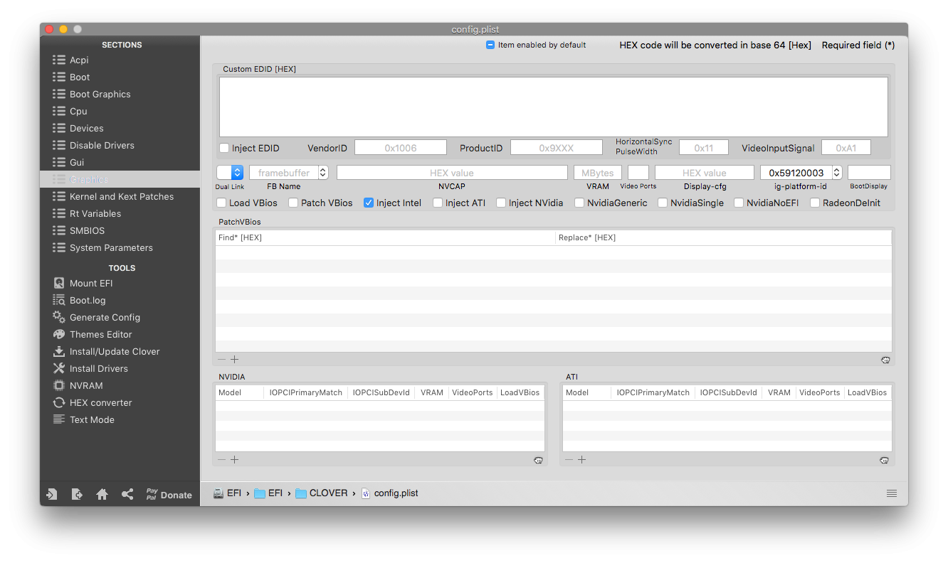

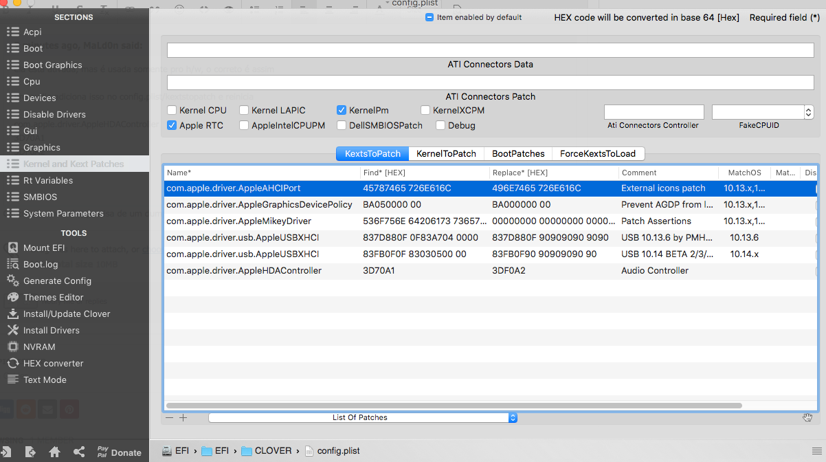

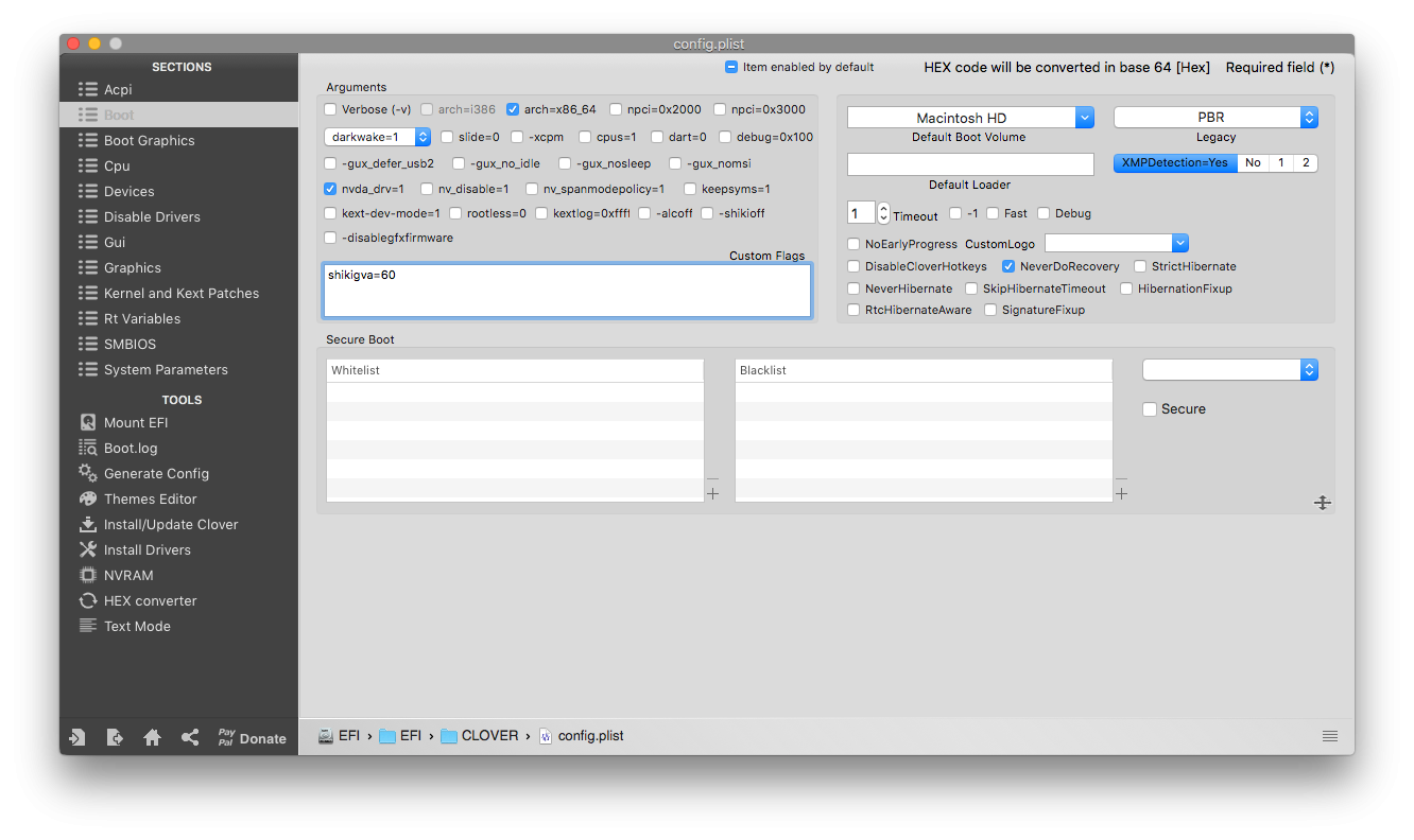

On 7/28/2018 at 11:49 AM, MaLd0n said:
:yoji:
Hi
I can't play DRM-protected video on iTunes. iTunes shows black screen and stops position of playing marker at '0'.
Here is my spec:
NVIDIA Geforce 1060 GTX i5 8400 + UHD 630
I have turned on iGPU + Discrete GPU setting on BIOS and seems to work on playing video using iina with hw-decoder perfectly (Imgur)
I also checked VDA Decoder if working using VDADecoderChecker and, it shows 'Intel plugin detected. HW Decoder is fully working' (Imgur)
I try to make it work with the following: I installed the kext shiki.kext (in recent, it was ported into part of WhateverGreen.kext) and set boot args with shikigva=12.
Force AppleGVA to use Intel or Nvidia decoder and reset DRM But none of them makes it to work. Is this issue relevant to DSDT? Thanks!

On 8/11/2018 at 7:55 PM, MaLd0n said:
Send me iMacs-iMac.zip
Oops! this is the good version :)
thank you again!

1 hour ago, awert_65 said:
Hi
Here is my spec:
try with intelgfx 59128086, ig platform id 59120003 and shikigva=60
