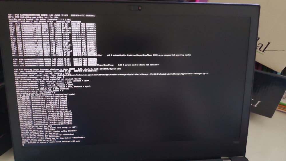

Thanks Maldon, unfortunately your DSDT has not solved my startup problem. As I wrote you, you need to modify the dsdt to make
the _REG accessible before the other codes that access the EC. Also Rehab told me not to use the H_EC to EC patch as it is not
needed on my laptop.
Finally, if you look in the attached folder you find an SSDT-1.aml where there is a patch for the battery, the patch must be inserted
in the SSDT as the embedded control is not in the DSDT but is in the SSDT
The only way to start with DSDT, for now, is to delete two lines in LID0, so it does not automatically restart during boot, the problem is that in this way I do not have LID.
I hope you understood what I wrote to you
I need to remove:
17175  Method (_LID, 0, NotSerialized)  // _LID: Lid Status
                    Return (ECR2 (RefOf (LSTE)))
Let me know...
Thanx
I need to remove:
Let me know...
Thanx
21/5000
all hacks need a device with EC name for solve log errors, correct usb properties, don't forget it
clear lid device and use power button for Lid wake too
use my clover folder, remove lines from LID and extract new send_me

1 hour ago, gigibatt said:
here it is.
Using this SMBIOS I have lags / pauses / unresponsiveness shortly after boot. This usually clears up after about 10/20 seconds. The solution appears to be removing unused connectors from the ig-platform into the framebuffer kext, are you able to solve?
I did not understand what you write, I have to fix the usb? I wrote an SSDT to fix the usb (see patchded folder)
I await your answer!
p.s. my kext are in Library/Extensions like a rehabman guide
Send me MacBook-Pro.station.zip
is a correct usb properties inside AppleBusPowerController
remove xosi(wth) and pnlf, have patches in dsdt
remove plugin type, have in DSDT too
use it, gigibatt device added lol
DSDT.aml.zip
SEND ME NEW SEND_ME AFTER REBOOT

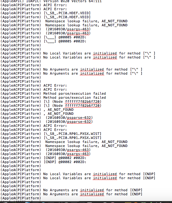

DSDT.aml.zip
attecched
i've read the send me files, with your dsdt we have too many errors in the AppleACPIPlatform, also on ACPIErrorWarning...
Let me know
Share this post

attecched
Let me know
Don't have anyy error or warning, is clean now
Extract boot log from 2018-08-9 09:06:46
