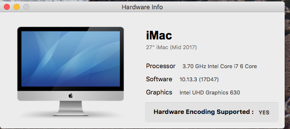

i see others users with same problem with 4k
u can se both gpus for hardware acceleration
-IntelGFX 0x59128086
-InjectIntel
-ig-platform-id 0x59120003
-IntelGraphics enable in bios
-DVMT to 128
-IntelGraphicsFixup.kext
Intel UHD Graphics appears visible under Hardware\PCI
However VDADecoderChecker gives an error:
GVA info: Successfully connected to the Intel plugin, offline Gen95
An error was returned by the decoder layer. This may happen for example because of bitstream/data errors during a decode operation. This error may also be returned from VDADecoderCreate when hardware decoder resources are available on the system but currently in use by another process.
VDADecoderCreate failed. err: -12473
I tried a Bootarch "shikigva=12" but no difference and causes iTunes to crash, "shikigva=4" no difference and iTunes stable.
Thanks!
Thanks!
P.S. the wake from sleep is solved... you never believe it... I had always used the equipped Dell cable. This was a Displayport to Mini DisplayPort Cable. I swapped it for a DisplayPort to Displayport Cable and wake from sleep is working... This is so terrible stupid but I'm so glad I found the issue!
Celebrated to soon ... Sometimes it still doesn't wake it looks cable related because with original I can't wake at all. The older cable does... sometimes...
work for me

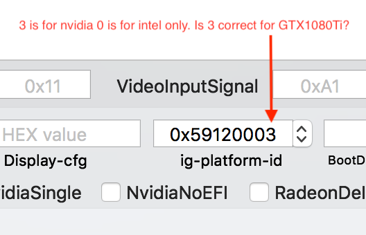

29 minutes ago, MaLd0n said:
It looks different. @my IGPU@2 I have 2 times AppleGraphicsDeviceControlClient. Is that related with the amount ports?
Thanks! How can I verify if Encode / Decode works ok with UHD630?

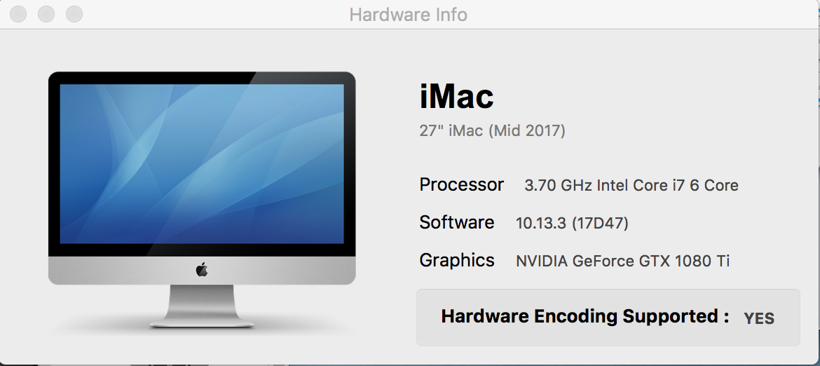

check with MacX Video Converter Pro.app
Share this post
Link to post
I see nVidia GT1080Ti only there so its not working correctly.
Can you please look into my clover files if I mistyped or forgot something?
https://we.tl/YQ2srimo5h
Cheers!
i think is a bios config or smbios, i use iMacPro and beta 10.13.4
u need a tests

MalD0n, Do you only have integrated graphics installed or do you also have a nVidia discrete in your system?
In the acX Video Converter Pro.app I see behind graphics: nVidia GTX1080Ti and I do see hardware encoding supported: yes. Does this mean that video encoding is done with the nVidia card or does it mean the intel is doing the job? (In older version you could explicit turn off encoding platforms to enforce another platform to be used if I'm correct).
Cheers
Cheers
RX 580 now, nvidia provide a bad driver, i changed ;)
