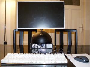

After some other mod there is my latest one...
Specs :
HW :
  - iMac G4 sunflower 17"
  - ASRock Z170M-ITX/AC
  - Core i3 3.7
  - 8GB DDR4 2133
  - mSSD Kingston SSDNow mS200 120GB
  - PSU Shuttle 250w
  - 24" LCD from old TV
  - Controller board inverter kit
  - USB male and female solder
  - HDMI cable 60cm
SW :
  - OS X Sierra  10.12.2
  - Clover (dont remember which build)
  - Office 2016
  - Adobe CC 2017
  - + some other
OTHER :
Some times and a lot of patience

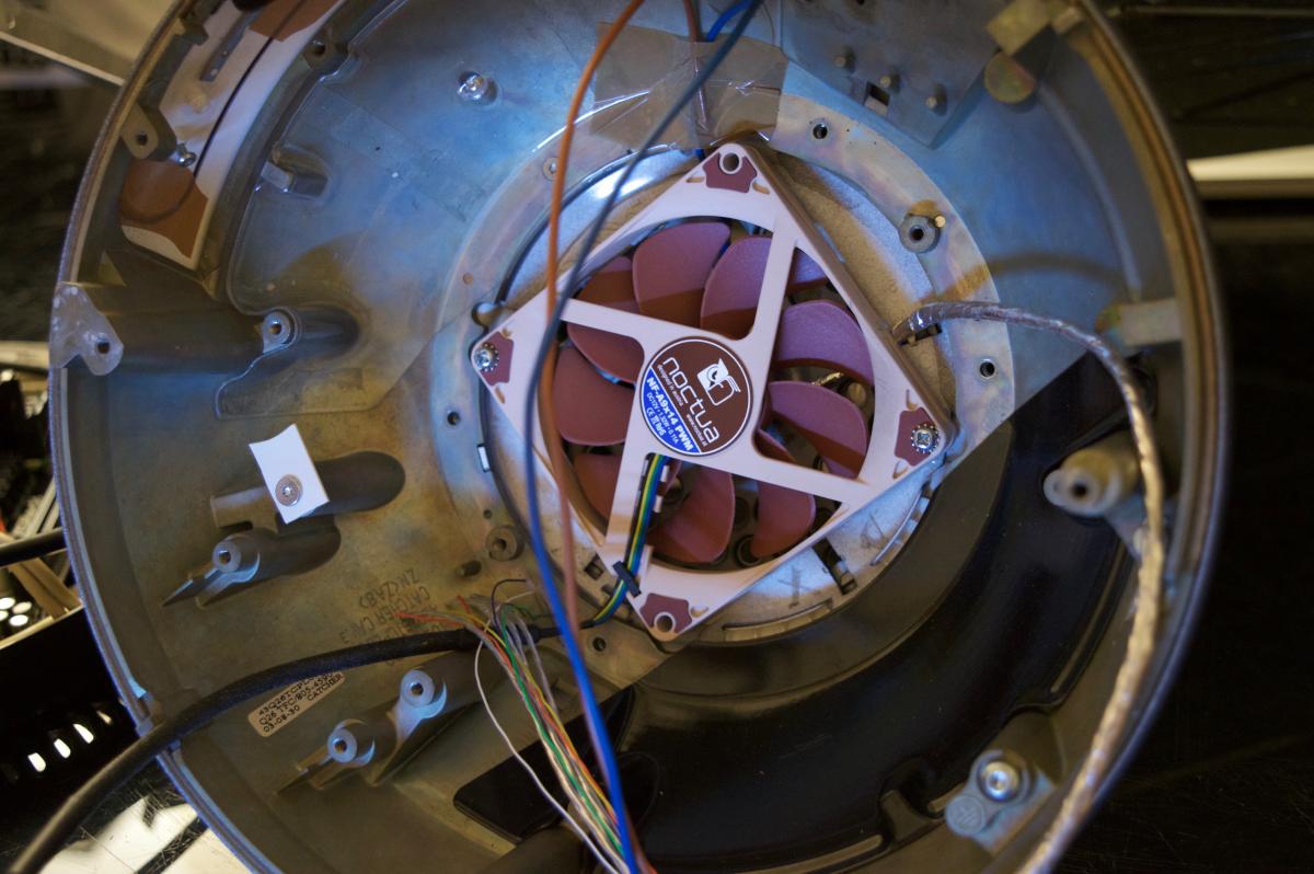

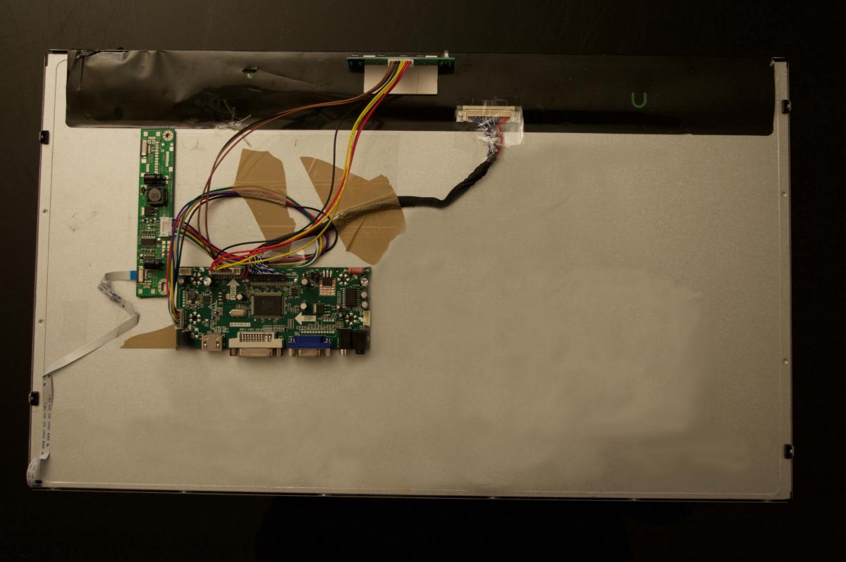

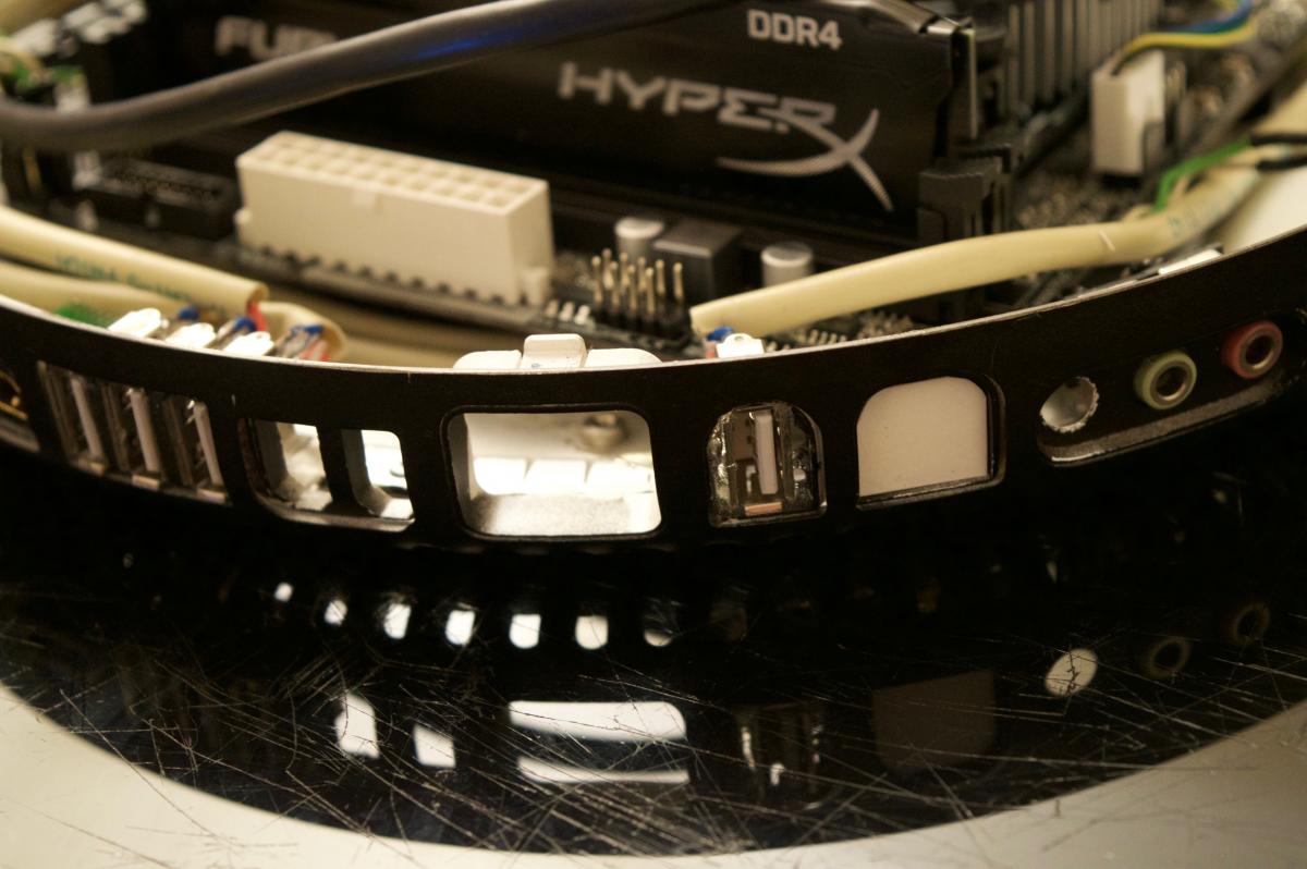

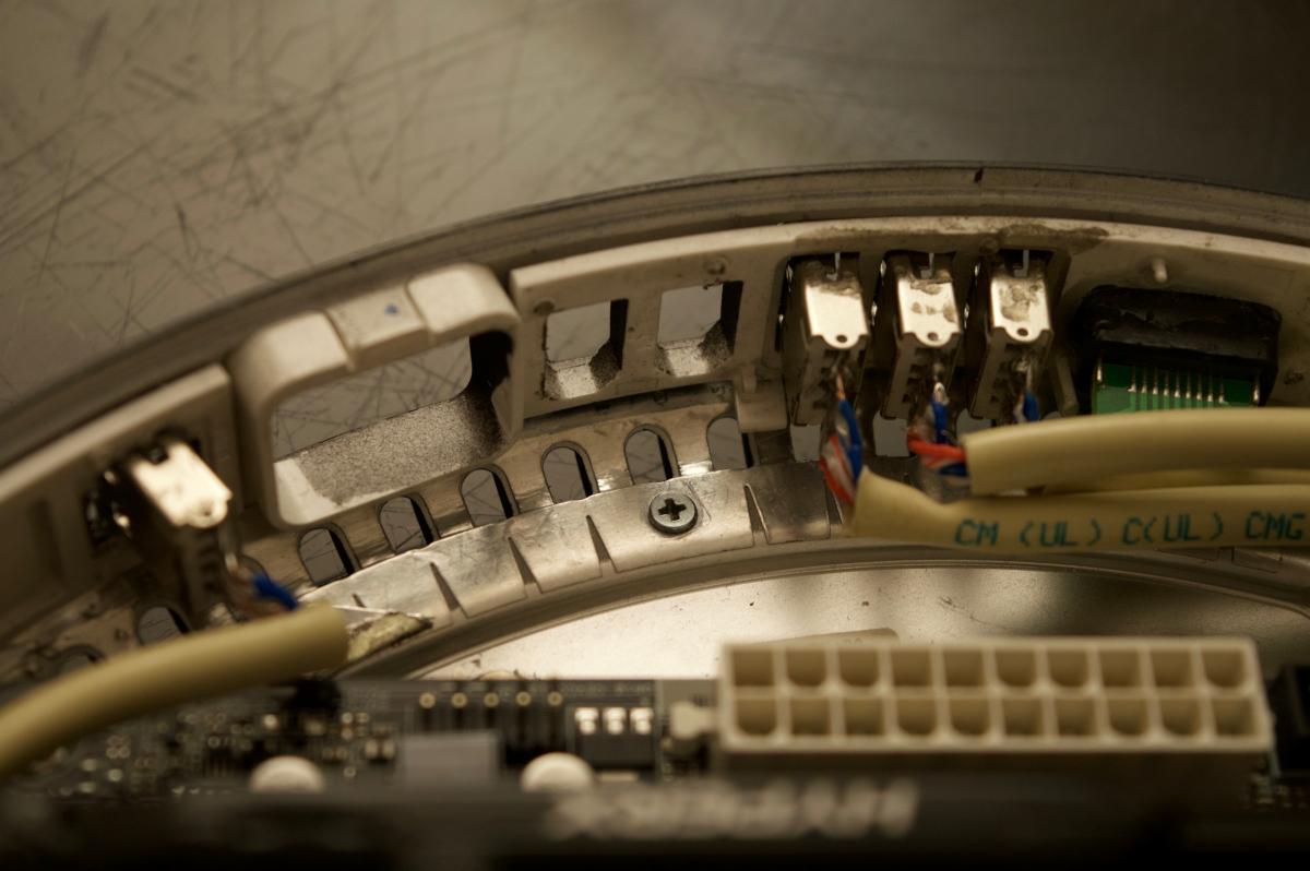

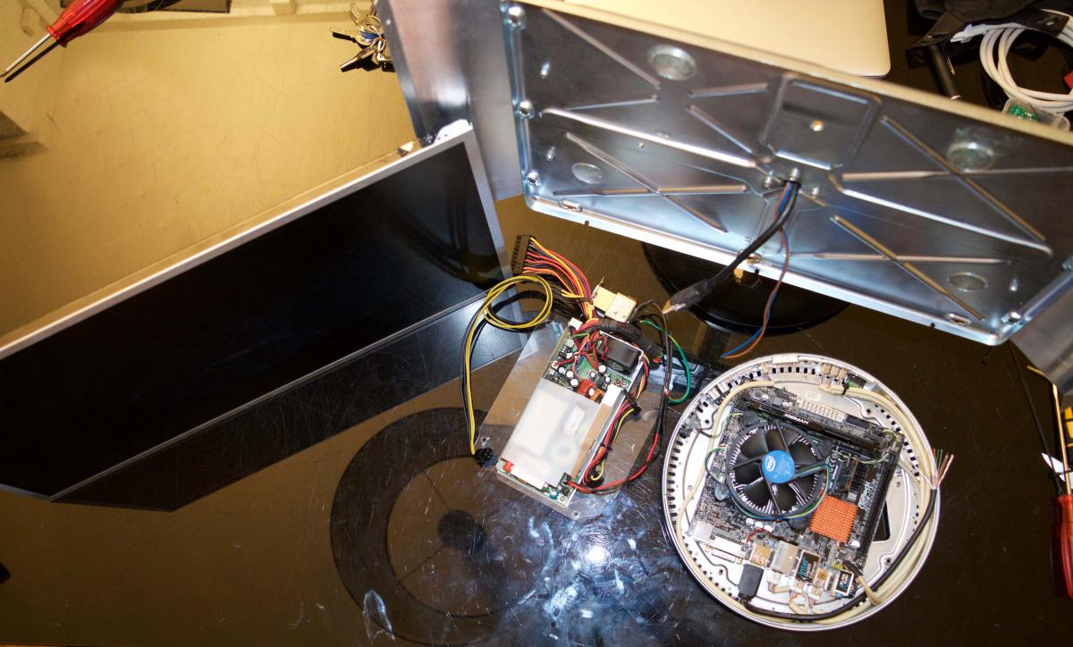

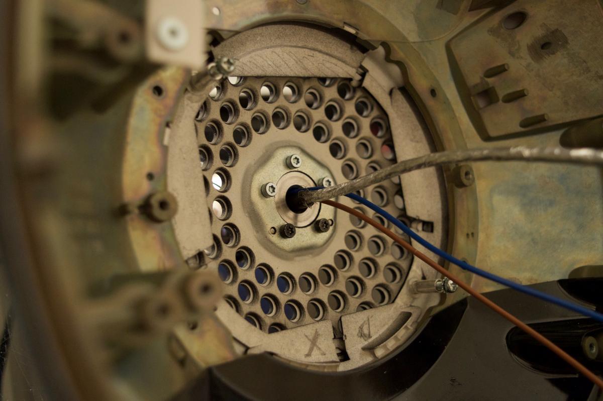

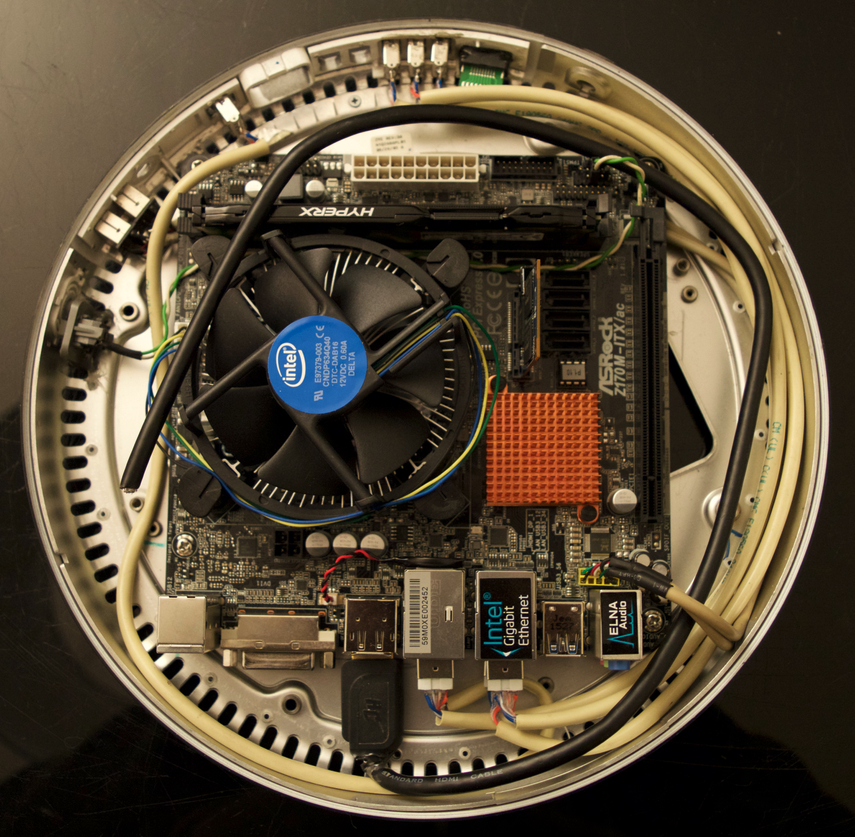

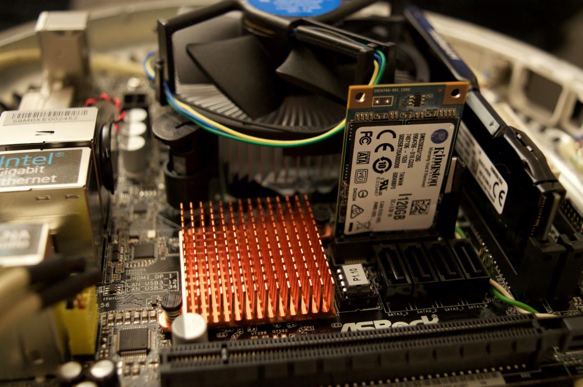

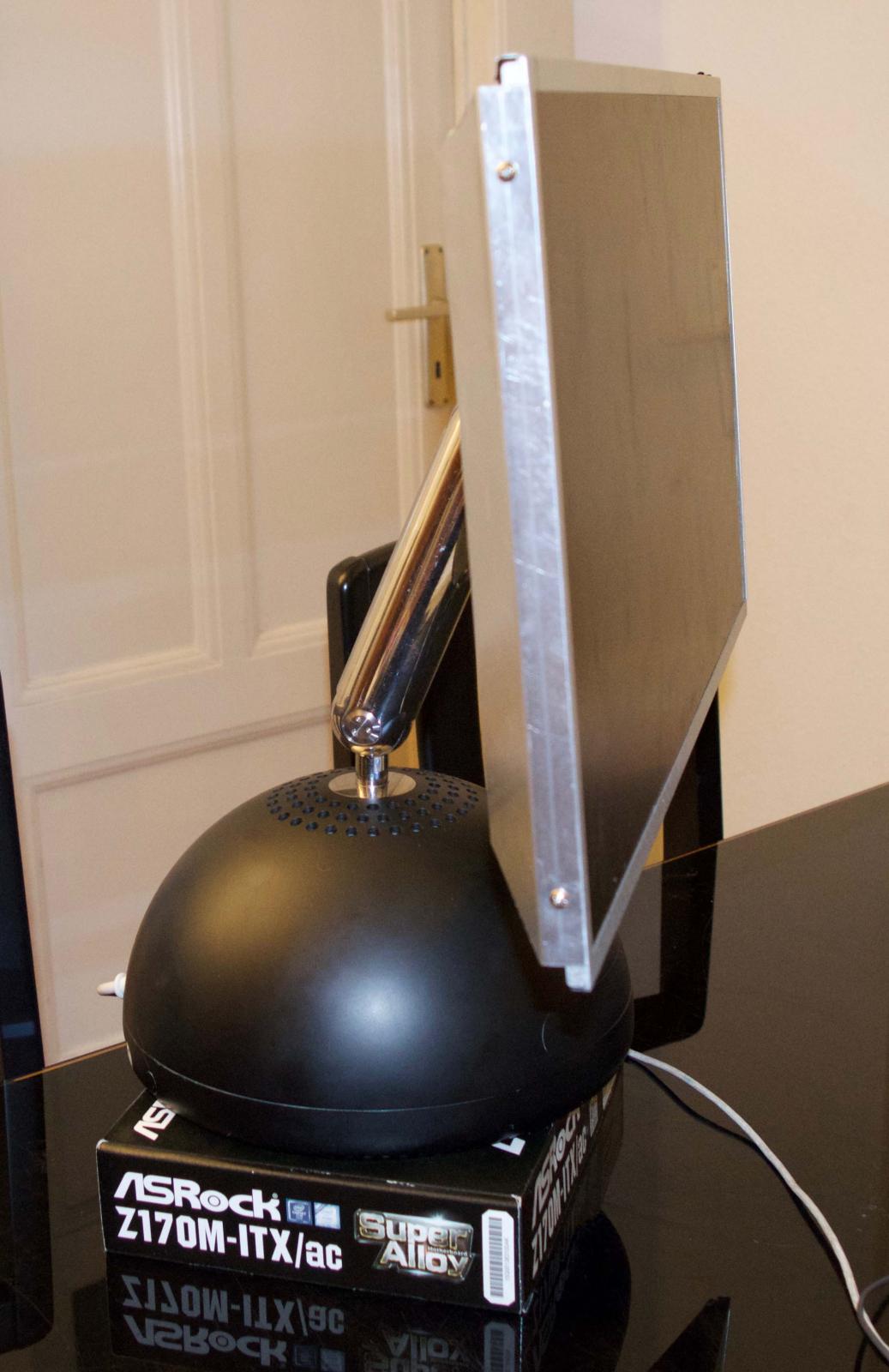

after opening and emptying the old iMac G4 that was not working anymore, i started to place the mainboard to see it would be better... then placed and glued some support from an old PC case and it started to look nice  :P.

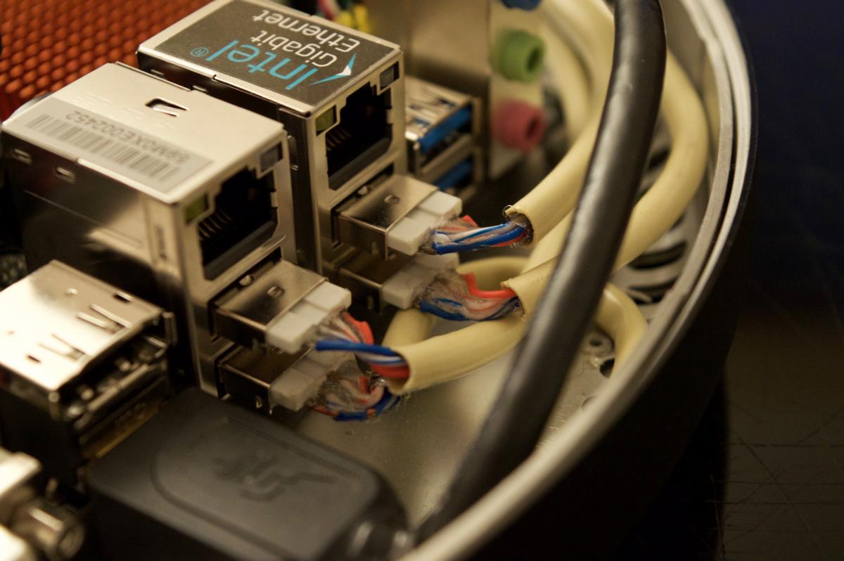

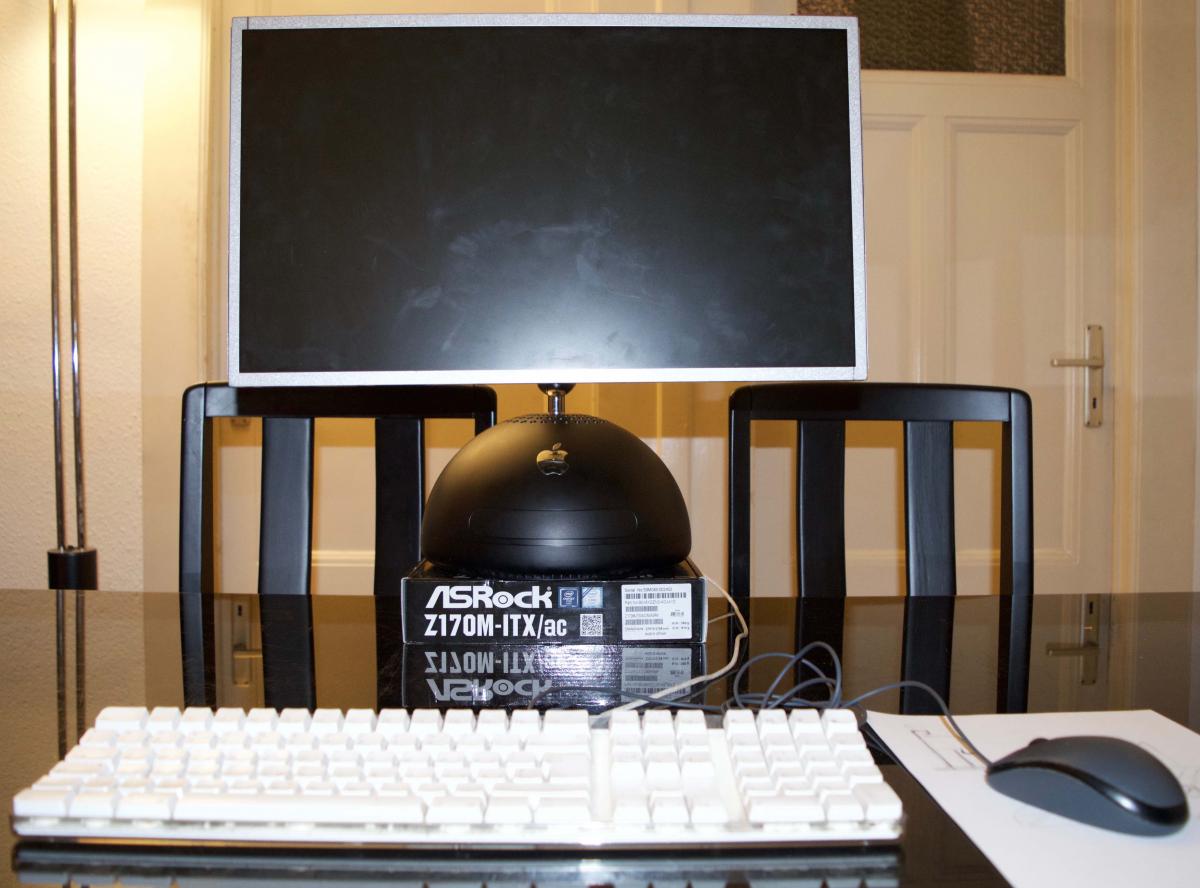

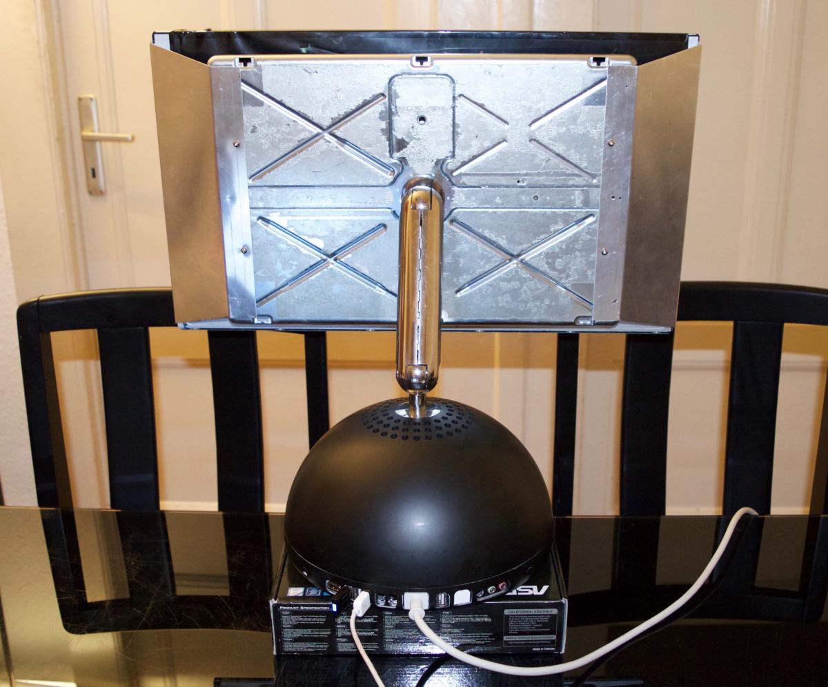

Then placed my old screen (kept from an "old" TV going to trash) over the original support with adapter i made placed the inverter, cut and solder the HDMI cable that would go from mainboard and screen inside the chromed foot screwed all that soldering the power cable to PSU (on 12v out) ans booted the newly created iMhack 24"
