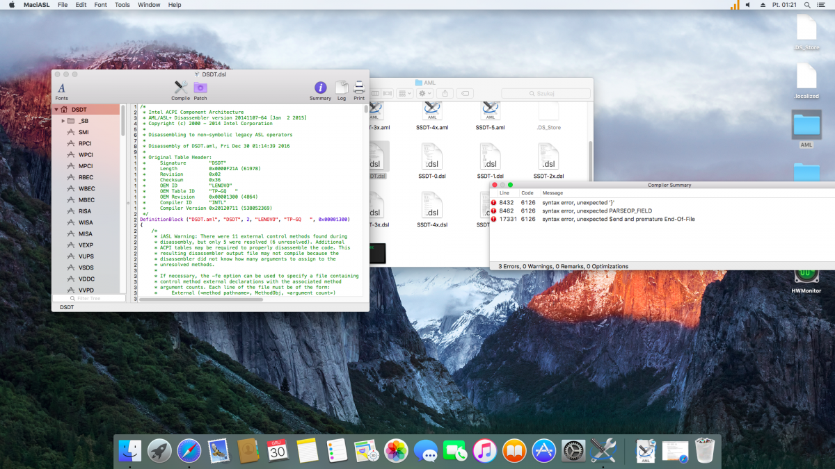

jarek1100 Posted December 30, 2016 Share Posted December 30, 2016 I have a problem with the patch DSDT. Here I have a screenshot of the information about the error. Attached is a file with my patch. Who will help me? DSDT.dsl.zip Link to comment https://www.insanelymac.com/forum/topic/319743-problem-dsdt-lenovo-thinkpad-yoga-s1-battery-fix/ Share on other sites More sharing options...

nawcom Posted December 30, 2016 Share Posted December 30, 2016 On line 8430-8431: Return (MDBG) Arg0 that's not a correct statement. it should be: Store (Arg0, MDBG) Return and on line 8461: Method (HRPR, 0, NotSerialized) { OperationRegion (HRPE, SystemMemory, \_GPE.MMTB (0x04), Field (HRPE, DWordAcc, Lock, Preserve) { VDPC, 32 }) should be Method (HRPR, 0, NotSerialized) { OperationRegion (HRPE, SystemMemory, \_GPE.MMTB, 0x04) Field (HRPE, DWordAcc, Lock, Preserve) { VDPC, 32 } fixed version attached DSDT.aml.zip Link to comment https://www.insanelymac.com/forum/topic/319743-problem-dsdt-lenovo-thinkpad-yoga-s1-battery-fix/#findComment-2341350 Share on other sites More sharing options...

RehabMan Posted December 30, 2016 Share Posted December 30, 2016 On line 8430-8431: Return (MDBG) Arg0 that's not a correct statement. it should be: Store (Arg0, MDBG) Return No. MDBG is actually a method that takes a single argument. You would need to change the External declaration appropriately: External (MDBG, MethodObj)And fix the code in ADBG: Return(MDBG(Arg0))You can use the iasl -fe option (during disassembly) and provide it with a refs.txt: External(MDBG, MethodObj, 1) It will then never have that issue... Or, since we know that CondRefOf(MDBG) is always false, you can simply remove the code within the CondRefOf block, such that ADBG reads: Method (ADBG, 1, Serialized) { Return (Zero) } Link to comment https://www.insanelymac.com/forum/topic/319743-problem-dsdt-lenovo-thinkpad-yoga-s1-battery-fix/#findComment-2341614 Share on other sites More sharing options...
