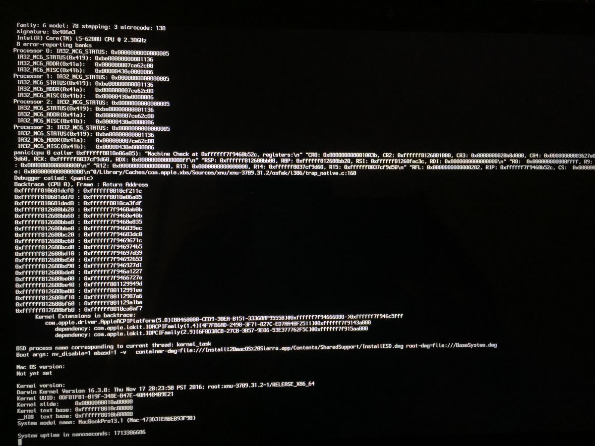

Nightdrive Posted January 16, 2017 Share Posted January 16, 2017 i don't get it. i think i followed all the steps as described but im still get this error. i generated the spoof HackrNVMeFamily-10_12_2.kext today on a MPB Late 2016 15". Does it matter that its not 13,1? I really apreciate your help Thanks ND EDIT: my HackrNVMeFamily-10_12_2.kext is 292KB (Version 92.1.0) Link to comment https://www.insanelymac.com/forum/topic/319656-guide-xiaomi-mi-notebook-air-13/page/2/#findComment-2350847 Share on other sites More sharing options...
JahStories Posted January 16, 2017 Author Share Posted January 16, 2017 You have to use mbp13,1! but said that, are you sure you created the file from a 10.12.2 machine? If yes I don't know why it panics, but as I said many times I don't support NVME drives on the file pack.... :/ Link to comment https://www.insanelymac.com/forum/topic/319656-guide-xiaomi-mi-notebook-air-13/page/2/#findComment-2350851 Share on other sites More sharing options...
kevin_1351 Posted January 16, 2017 Share Posted January 16, 2017 i don't get it. i think i followed all the steps as described but im still get this error. i generated the spoof HackrNVMeFamily-10_12_2.kext today on a MPB Late 2016 15". Does it matter that its not 13,1? I really apreciate your help Thanks ND EDIT: my HackrNVMeFamily-10_12_2.kext is 292KB (Version 92.1.0) The machine u generate Hackr on is irrelevant, all that matters is that it's on 10.12.2. If the tool said that the md5 is correct, then you generated the correct file. Be sure to add the ssdt to config (sortedorder), and to the acpi folder. Sent from my iPhone using Tapatalk Link to comment https://www.insanelymac.com/forum/topic/319656-guide-xiaomi-mi-notebook-air-13/page/2/#findComment-2350857 Share on other sites More sharing options...
Nightdrive Posted January 16, 2017 Share Posted January 16, 2017 thanks for your fast reply guys. maybe there was a MD5 error, i'm not sure about that. I'lll check that tommorrow again. But the machine is on 10.12.2 for sure. How would i prevent a MD5 error? Link to comment https://www.insanelymac.com/forum/topic/319656-guide-xiaomi-mi-notebook-air-13/page/2/#findComment-2350868 Share on other sites More sharing options...
kevin_1351 Posted January 16, 2017 Share Posted January 16, 2017 thanks for your fast reply guys. maybe there was a MD5 error, i'm not sure about that. I'lll check that tommorrow again. But the machine is on 10.12.2 for sure. How would i prevent a MD5 error? The patch clearly states if the md5 is correct or not. (If it's the same as it expected) Link to comment https://www.insanelymac.com/forum/topic/319656-guide-xiaomi-mi-notebook-air-13/page/2/#findComment-2350872 Share on other sites More sharing options...

Nightdrive Posted January 17, 2017 Share Posted January 17, 2017 Hi everyone, today i generated a new HackrNVMeFamily-10_12_2.kext and the md5 was OK. Unfortunately i still get the same error as mentioned before. Is this error even related to HackrNVMeFamily-10_12_2.kext. Are ther any other possible reasons? Thanks ND Link to comment https://www.insanelymac.com/forum/topic/319656-guide-xiaomi-mi-notebook-air-13/page/2/#findComment-2351537 Share on other sites More sharing options...

kevin_1351 Posted January 17, 2017 Share Posted January 17, 2017 Hi everyone, today i generated a new HackrNVMeFamily-10_12_2.kext and the md5 was OK. Unfortunately i still get the same error as mentioned before. Is this error even related to HackrNVMeFamily-10_12_2.kext. Are ther any other possible reasons? Thanks ND Try to use .06 (not .07) acpi patches instead. Report your findings. I'm currently working on fixing the acpi issues, thus fixing the lid issue and nvme issues (.06 should work fine though). Sent from my iPhone using Tapatalk Link to comment https://www.insanelymac.com/forum/topic/319656-guide-xiaomi-mi-notebook-air-13/page/2/#findComment-2351610 Share on other sites More sharing options...
Nightdrive Posted January 17, 2017 Share Posted January 17, 2017 @ClaudesTech: I just dont't want to spend exra money right now @Kevin_1351: did that already - same error. Right now im installing Sierra in a VM wih the same installer-version i'm using for the Hackintosh. I'll generate the file again and try again Link to comment https://www.insanelymac.com/forum/topic/319656-guide-xiaomi-mi-notebook-air-13/page/2/#findComment-2351646 Share on other sites More sharing options...
kevin_1351 Posted January 17, 2017 Share Posted January 17, 2017 @ClaudesTech: I just dont't want to spend exra money right now @Kevin_1351: did that already - same error. Right now im installing Sierra in a VM wih the same installer-version i'm using for the Hackintosh. I'll generate the file again and try again That won't make any difference, same exact file (md5). @ClaudesTech: I just dont't want to spend exra money right now @Kevin_1351: did that already - same error. Right now im installing Sierra in a VM wih the same installer-version i'm using for the Hackintosh. I'll generate the file again and try again Btw, are u 100% sure that you're on a 10.12.2 installer? And not some other older {censored}? Link to comment https://www.insanelymac.com/forum/topic/319656-guide-xiaomi-mi-notebook-air-13/page/2/#findComment-2351651 Share on other sites More sharing options...

kevin_1351 Posted January 17, 2017 Share Posted January 17, 2017 Yes, it's the lastest version from the App Store And you have added the nvme ssdt to the acpi folder AND config.plist? Link to comment https://www.insanelymac.com/forum/topic/319656-guide-xiaomi-mi-notebook-air-13/page/2/#findComment-2351727 Share on other sites More sharing options...
Nightdrive Posted January 17, 2017 Share Posted January 17, 2017 SSDT-NVMe-Pcc.aml -> APCI/patched and in the config <string>SSDT-NVMe-Pcc.aml</string> at <key>SortedOrder</key>. correct? Link to comment https://www.insanelymac.com/forum/topic/319656-guide-xiaomi-mi-notebook-air-13/page/2/#findComment-2351742 Share on other sites More sharing options...
kevin_1351 Posted January 18, 2017 Share Posted January 18, 2017 SSDT-NVMe-Pcc.aml -> APCI/patched and in the config <string>SSDT-NVMe-Pcc.aml</string> at <key>SortedOrder</key>. correct?Correct. Have you already installed macOS? If you installed it using the incorrect version (shouldn't be possible) it most definitely has corrupted the drive. If so, just reinstall it again. Edit: I've found the issue. In the newer updates they've (OP) made the _DSM acpi method remain intact, this causes our NVMe inhibitor to not work. By using a simple rename to XDSM clover patch, it should work again. 1 Link to comment https://www.insanelymac.com/forum/topic/319656-guide-xiaomi-mi-notebook-air-13/page/2/#findComment-2351888 Share on other sites More sharing options...
Nightdrive Posted January 18, 2017 Share Posted January 18, 2017 No, i only have Win 10 Pro installed on the Xiaomi right now. I really have no idea. I uploaded my EFI folder (without themes). Maybe you can find some time to check if you can boot up the installer from USB? EDIT: just to make sure we didn't misunderstand. I get this error when i try to boot into the installer for a fresh installation from USB. There is no older MacOS installation CLOVER.zip Link to comment https://www.insanelymac.com/forum/topic/319656-guide-xiaomi-mi-notebook-air-13/page/2/#findComment-2351892 Share on other sites More sharing options...
kevin_1351 Posted January 18, 2017 Share Posted January 18, 2017 No, i only have Win 10 Pro installed on the Xiaomi right now. I really have no idea. I uploaded my EFI folder (without themes). Maybe you can find some time to check if you can boot up the installer from USB? EDIT: just to make sure we didn't misunderstand. I get this error when i try to boot into the installer for a fresh installation from USB. There is no older MacOS installation Read my edit. Sent from my iPhone using Tapatalk Link to comment https://www.insanelymac.com/forum/topic/319656-guide-xiaomi-mi-notebook-air-13/page/2/#findComment-2351897 Share on other sites More sharing options...
Nightdrive Posted January 18, 2017 Share Posted January 18, 2017 Edit: I've found the issue. In the newer updates they've (OP) made the _DSM acpi method remain intact, this causes our NVMe inhibitor to not work. By using a simple rename to XDSM clover patch, it should work again. Sounds great! But to be honest, i'm not familiar with these patches. Can you point me to some tutorial? Link to comment https://www.insanelymac.com/forum/topic/319656-guide-xiaomi-mi-notebook-air-13/page/2/#findComment-2351898 Share on other sites More sharing options...
kevin_1351 Posted January 18, 2017 Share Posted January 18, 2017 Sounds great! But to be honest, i'm not familiar with these patches. Can you point me to some tutorial? Neither was I 3 days ago. Anyway, there's no need to reinvent the wheel. There are a few problems with the filepack as of now. This is one of them. I'm trying to fix them in order to possibly get rid of the lid bug as well. It's not easy though, and I can't give u an eta. You should be able to use the .05 release though (maybe even .06). The DSM hasn't always been like this. Or maybe I'm just confused with my files right now... Link to comment https://www.insanelymac.com/forum/topic/319656-guide-xiaomi-mi-notebook-air-13/page/2/#findComment-2351900 Share on other sites More sharing options...
Nightdrive Posted January 18, 2017 Share Posted January 18, 2017 alright. Thanks a lot so far. I'll try that tomorrow and post what happend. btw: i really appreciate ClaudesTech an your work a lot. 1 Link to comment https://www.insanelymac.com/forum/topic/319656-guide-xiaomi-mi-notebook-air-13/page/2/#findComment-2351901 Share on other sites More sharing options...
