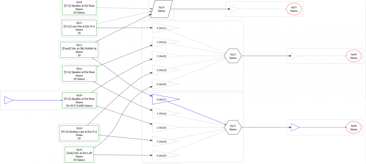

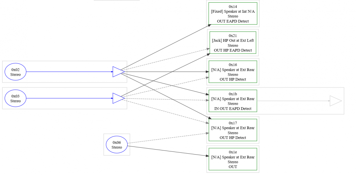

I haven't seen there is any topic about ALC295, so i tried to make a HDA kext,
but it is invalid.
There are some information and note about my hardware.
Codec: Realtek ALC295
Address: 0
Vendor Id: 0x10ec0295 (codecID),Decimal:283902613
OS X10.11.6
pathmap
0x12 3001a6b7: [Fixed] Mic at Oth Mobile-In   0x08>0x23>0x12        8>35>18
0x14 10011790: [Fixed] Speaker at Int N/A      0x14>0x02                 20>2
0x19 4010a103: [Jack] Mic at Ext Left              0x09>0x22>0x19       9>34>25       //MuteGPIO=50+0100+19=50010019>1342242841
0x21 20102103: [Jack] HP Out at Ext Left        0x21>0x03                 33>3
config
01271C30 01271D01 01271EA6 01271FB7
01471C10 01471D01 01471E17 01471F90
01971C40 01971D10 01971EA1 01971F03
02171C20 02171D10 02171E21 02171F03 01470C02
I'd appreciate your help. :)
codec_dump.zip
svg.zip

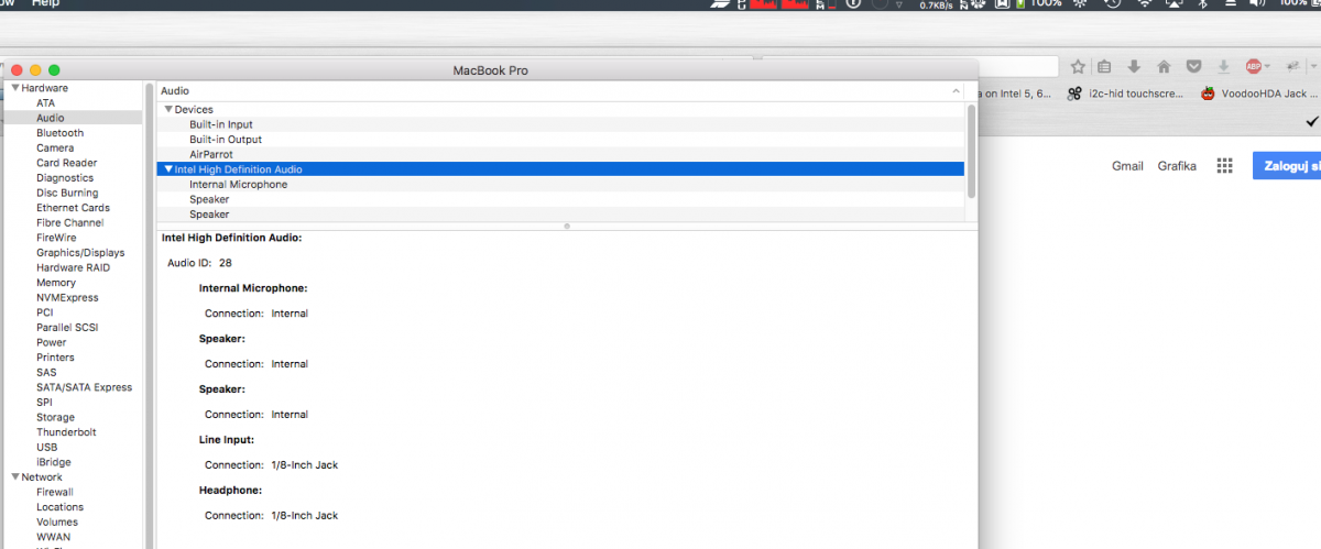

Hi, did you fiexed it?
I;m trying to fix ALC295 - AppleALC,kext + Clover inject audio = 28
I see devices in preferences, can control sound level but still there is NO sound from speakers or headphones ;(
Thank you
