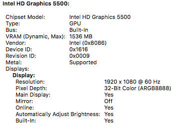

First time seen this
Hi. I wonder graphic artifacts on broadwell cpu.
Is it exist left top corner blackbar glitch?
Broadwell and skylake need to change more dvmt value.
Skylake internal graphic have this issue in Sierra.
I just confirm more this issue clearly.
Thanks in advance

no glitch at all after boot. At boot stage there is glitch (many apples....).

Try to rebuild kernel cache to see if it can fix glitches by:
sudo touch /S*/L*/E* && sudo touch /L*/E* && sudo kextcache -u /
syscl
Share this post
Link to post
Thank you. At boot stage glitch can fix. No problem.

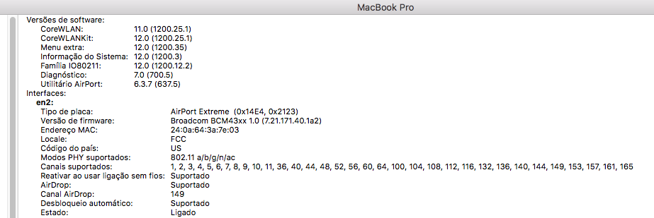

Hi! I've found 3 new patches for AirPortBrcm4360 for Broadcom BCM94352 Users.

Those worked for me.  I added them to the patches I used for Sierra (DP's and GM's) and all is working well.  Thanks for finding these so quickly.
i dont need to patch in 10.12.1 beta.
i use from 10.12 dp1 to 10.12.1 beta. it's no problem.
i use this patch blow
AirPortBrcm4360 (AirPortBrcm4360 - fcvo, 10.12.x (credit the-darkvoid)) - http://www.insanelymac.com/forum/topic/312759-fix-macos-sierra-dp1-bcm94532z-wifi/page-1
AirPortBrcm4360 (10.12-BCM94352-5GHz-US-FCC-dv) - toleda
AirPortBrcm4360 (AirPortBrcm4360 whitelist patch (board-id), 10.12.dp1, credit RehabMan) - rehabman

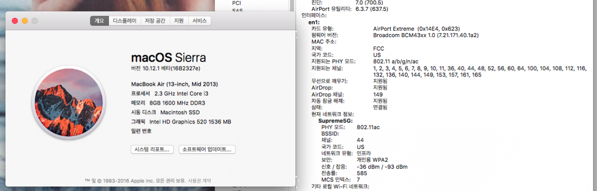

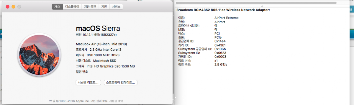

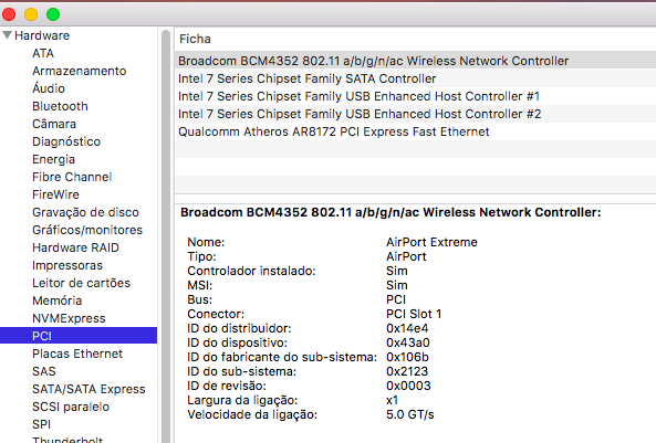

Do you have Azurewave AW-CE123H? Do you use FakeID Parameter in Clover? Because I have different Device ID(AirPort Extreme  (0x14E4, 0x2154)) and I need new patches.
Share this post
Link to post
My device ID is 14E4, 43B1.  I used a DSDT patch to make it compatible with 14E4, 43a0, which works with the BCM4360 kext.
Share this post
Link to post
My device ID is 14E4, 43B1.  I used a DSDT patch to make it compatible with 14E4, 43a0, which work with the BCM4360 kext.
the same is by me.
In new binary Apple introduced new Error in init-sequence
AirPort_Brcm43XX::start: Failed PCIe configuration, this[0x2dae1a3cc0a25b9b] vendor[0x000014e4] device[0x000043a0], chip: vid[0x14e4] did[0x43b1] bar0[0xf6a00004]
Maybe not all cards on BCM94352 need this patch, but Azurewave AW-CE123H does.
Share this post
Link to post
the same is by me.

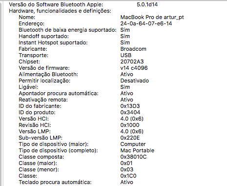

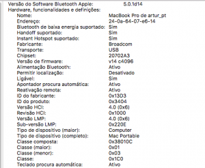

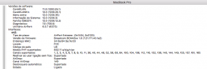

my device id. i use dsdt with compatbile "pci14e4,43a0"
my wifi card here
https://www.aliexpress.com/item/Broadcom-BCM94352Z-Wireless-AC-NGFF-Dual-band-802-11ac-867Mbps-WIFI-Bluetooth-BT-4-0-Card/32580045155.html?spm=2114.13010608.0.60.K1Mkfz
