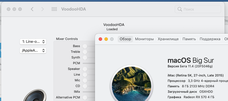

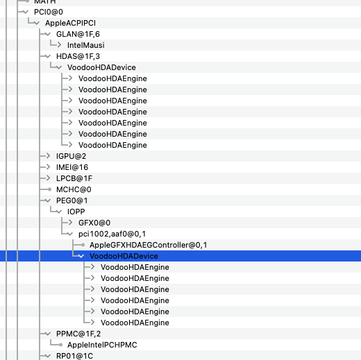

Slice Posted October 10, 2020 Author Share Posted October 10, 2020 I continue to support VoodooHDA. Now version 2.9.5 with some security check compiled under BigSur and now is working here. Be sure your sound device is not HDEF. This is the way to exclude conflict between AppleHDA and VoodooHDA because AppleHDA will be loaded only if the device named HDEF and if HDMI device is called HDAU. For VoodooHDA they can be any other names. For example ALC device will be HDAS. HDMI device on AMD graphics card will be named as HDMI. See 2 Link to comment Share on other sites More sharing options...

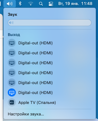

NEOSoftWare Posted January 19, 2021 Share Posted January 19, 2021 (edited) On 11/19/2020 at 10:39 PM, Slice said: I made one more fix in VoodooHDA to be working under BigSur. Now this is the version 2.9.6. VoodooHDA.kext.zip 95.64 kB · 53 downloads Tell me how to make it work? in Catalina, built-in sound worked for me (ALC662) and in Big Sur it does not work, only HDMI outputs are detected VoodooHDAGetdump.txt Edited January 20, 2021 by NEOSoftWare Link to comment Share on other sites More sharing options...
Slice Posted January 21, 2021 Author Share Posted January 21, 2021 On 1/19/2021 at 11:15 PM, NEOSoftWare said: Tell me how to make it work? in Catalina, built-in sound worked for me (ALC662) and in Big Sur it does not work, only HDMI outputs are detected VoodooHDAGetdump.txt 13.71 kB · 0 downloads VoodooHDA dump shows only HMDI sound. Check your BIOS settings. Probing codec #0... HDA Codec #0: ATI R6xx HDMI Link to comment Share on other sites More sharing options...

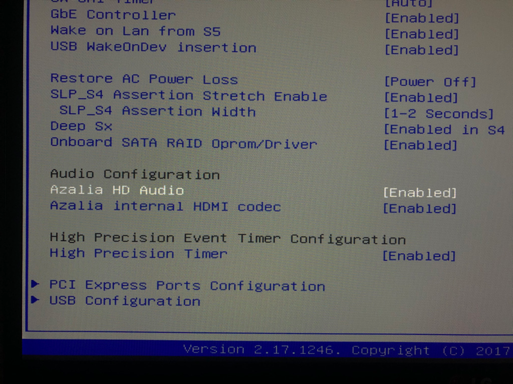

NEOSoftWare Posted January 21, 2021 Share Posted January 21, 2021 (edited) 2 hours ago, Slice said: VoodooHDA dump shows only HMDI sound. Check your BIOS settings. everything is included in bios. Spoiler Sound works in windows Edited January 21, 2021 by NEOSoftWare Link to comment Share on other sites More sharing options...
Slice Posted January 22, 2021 Author Share Posted January 22, 2021 Show me Clover's preboot.log if you can use Clover even though you can't boot. Link to comment Share on other sites More sharing options...

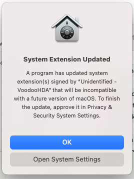

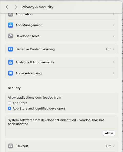

AntarcticP Posted April 29, 2021 Share Posted April 29, 2021 Hi Slice any plans yet to update VoodooHDA to get it working under Big Sur 11.3? Hope you can manage, still the only way to get sound working on my old AMD FX hackintosh. Thanks! 1 Link to comment Share on other sites More sharing options...
