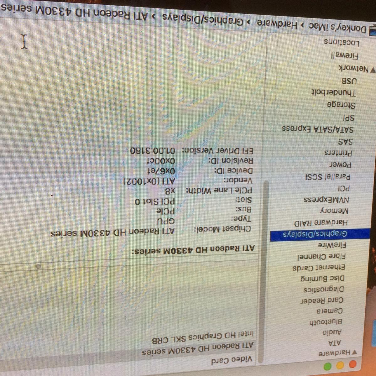

Gigamaxx
RX480 on Sierra now recognized.
19 posts in this topic

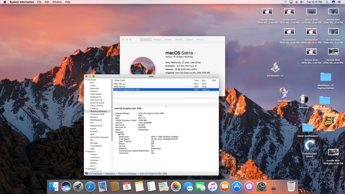

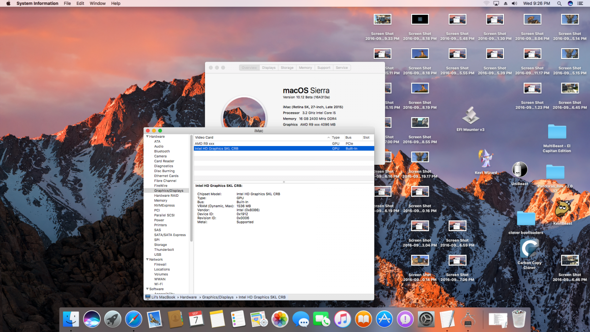

I had success on Sierra using one of my RX480 cards. At first it was black screen, but after loading Windows 10 on my build (separate disk), and downloading the AMD drivers and restarts and updates my bios recognized the card and it booted right into Sierra. The latest version of clover V3676 recognized my RX480 and gave it the device code 67df and of course 1002 for vendor. See pics.
post-1753549-0-52169300-1470242443_thumb.jpegpost-1753549-0-30998500-1470242495_thumb.jpegpost-1753549-0-30139600-1470242524_thumb.jpeg

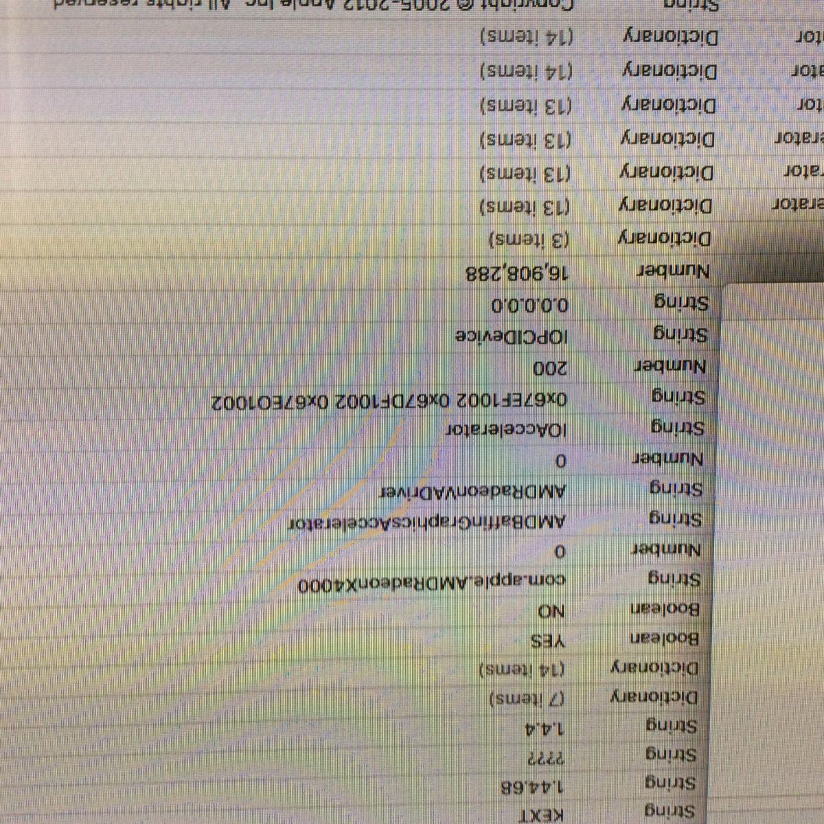

Yes it "works", but still no acceleration. (and w/o acceleration is useless)
If you type this command in terminal you will see no X4000 kext loaded:
kextstat | grep AMD
and:
http://www.insanelymac.com/forum/topic/312582-amd-polaris-ids-on-1012-sierra/
kextstat | grep AMD
and:
There are frame buffer fixes in the works on another site, there is progress. It's encouraging to know its recognized by OS, no ATI-disable at boot.

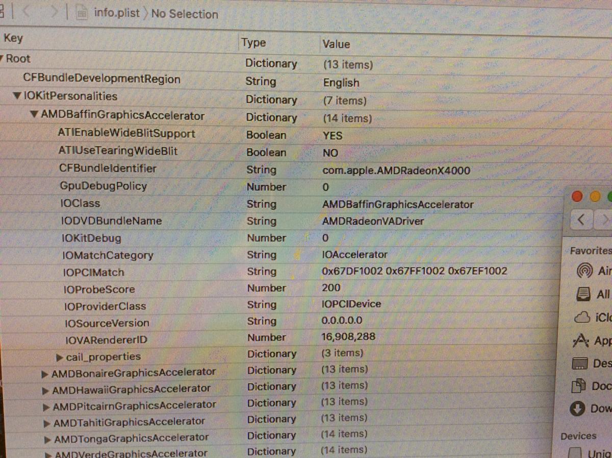

@Ciro82
could you confirm, that AMDRadeon4000.kext get loaded if you change the info.plist entry from:
0x67EF1002
into
0x67DF1002
If i do this change with my Sapphire RX480, this Kext wont get loaded when i check it within SystemMonitor.app

@Ciro82
0x67EF1002
into
0x67DF1002

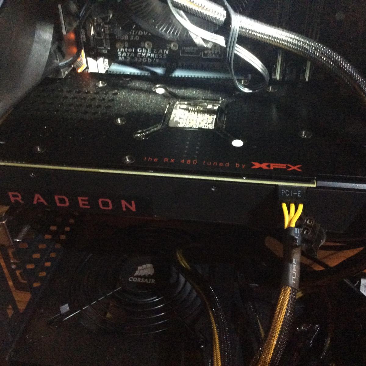

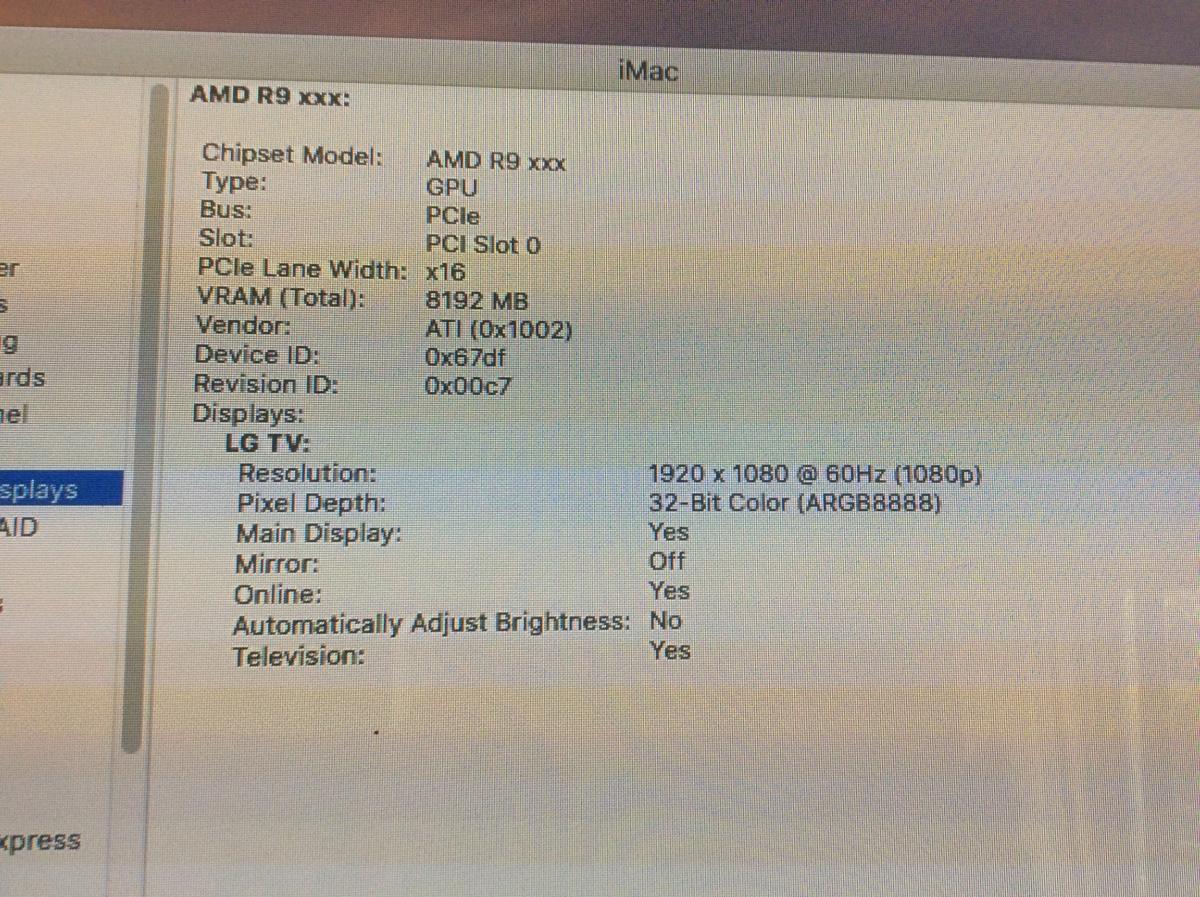

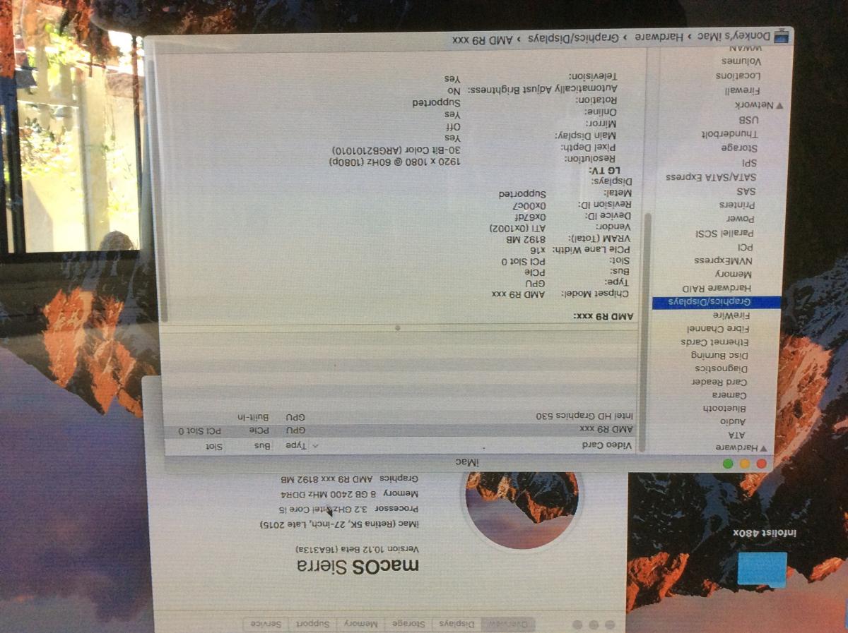

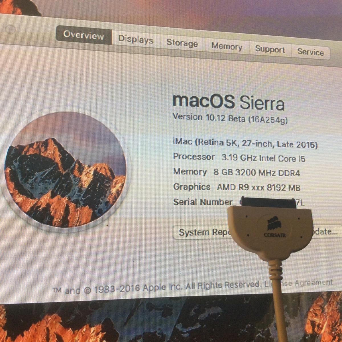

I changed the EO to DF671002 and got in last night. XFX RX 480 8g.
This was following the video on YouTube by the garage guy. The key is the csr disable or the fix won't stick.
post-1753549-0-14114700-1472931098_thumb.jpeg post-1753549-0-53853400-1472931123_thumb.jpeg. I also changed the order of the DF from first to second and it still works with no needed injections in clover. Clover 3688 at least recognizes the XFX 480 and it loads without fuss. I did this to see if my Asus and XFX 460 cards would get support, but no go for the Asus, I can't even no up anymore with it, I get the UEFI OS bug and have to boot dump it. The XFX card shows as a 4330 card. Same as before, so even though this change works for my RX480 it had no effect for he 460s.post-1753549-0-00496200-1472934521_thumb.jpgpost-1753549-0-00496200-1472934521_thumb.jpg
Share this post
Link to post
gigamaxx can you tell us if you are getting acceleration working with reference design version?
It's very minimal now, but the XFX 480 is accelerating. Maybe the Beta 8 will have the appropriate drivers for it. I'm getting the whoosh at boot up and have supported status after altering the 4000 kext. Baffin has 3 IDs 67EO1002, 67FF1002, 67EF1002. EF is the 460 and the Gigbyte RX460 gets support in this kext, not 100% but it's there. The other 2 IDs could be for the RX470 and 480 models or for67 future laptop variants. The EO and FF are not revealed yet as official. I changed the EO to 67DF and got the RX480 to boot, I also changed it to 67EF and tried my Asus and XFX 460 cards but they still don't work. By putting the 67DF change on both the EO and FF definitions in 4000 kext it boots the XFX RX480 without any clover injections needed. Just the board bios IGFX as primary and Auto for chipset setting. If you choose enabled in IGFX it won't load the RX kext and the card won't come up. Booting on pcie only gets clover screen and 70% of boot screen and then black abyss. It's an integrated graphics scenario that is kinda weird at this point.
Share this post
Link to post
Graphics acceleration tied to boot up connection.    With a single monitor you need to plug your cable into the card port before you hit return or enter at boot up.    If not you do not get full acceleration from the cards I've tested so far..
 HDMI connected to video card port at boot up.
HDMI connected to Motherboard port at boot up.
Sierra picks up the monitor signal and loads the drivers accordingly.   You can still have a supported card that doesn't accelerate if you don't do the black screen boot (HDMI connected to card at boot up).
