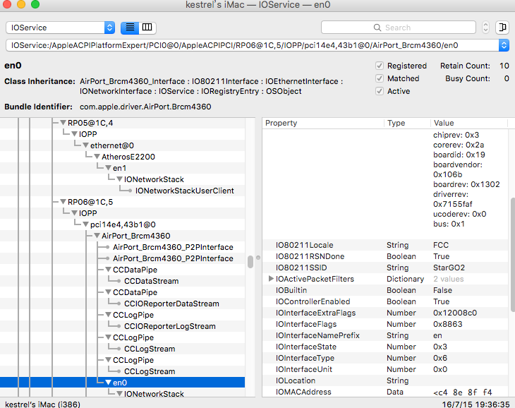

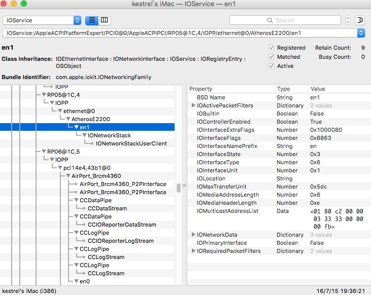

Kestrel.Bright Posted July 19, 2016 Share Posted July 19, 2016 i can't update software from app store, always get "your device or computer could not be verified". CLOVER.zip Link to comment Share on other sites More sharing options...

al6042 Posted July 19, 2016 Share Posted July 19, 2016 I love those threads which are solved by the thread opener themselves... Do all the other iApps (Messages, Facetime, iTunes) work as expected with your LAN-Device connected as en1? Link to comment Share on other sites More sharing options...
Riley Freeman Posted July 19, 2016 Share Posted July 19, 2016 Built-in ethernet shows up as en1 when the driver isn't available or doesn't load when the system is installed. To fix this, I put IONetworkingFamily in my Clover kexts folder alongside the ethernet driver. This way it will driver will load during setup. If you don't do this, then delete NetworkInterfaces.plist and preferences.plist in /Library/Preferences/SystemConfiguration/ and reboot. It will reinitialise the network settings and put ethernet as en0. Link to comment Share on other sites More sharing options...
