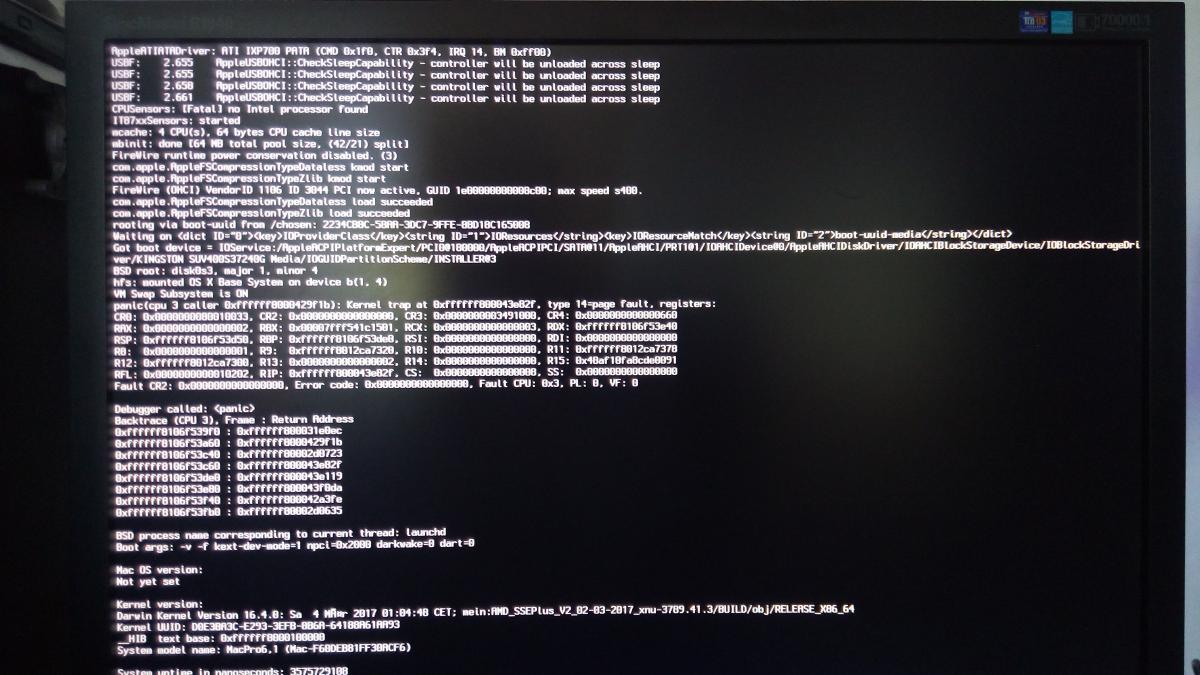

This isn't working on my Athlon but could Phenom users test. This should work on FX and be an improvement.

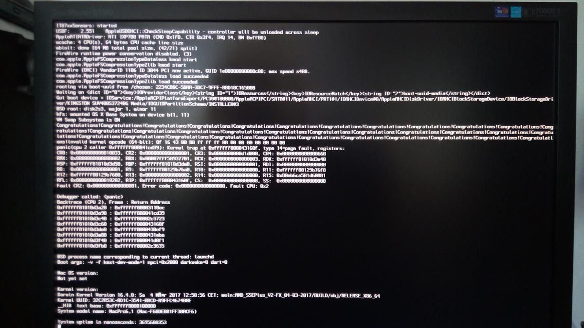

Thanks for this new AMD kernel and unfortunately it got too many invalid opcodes during booting for FX-6300 hackintosh at both 10.12.1 & 10.12.3.
Share this post
Link to post
Did you build the prelinkedkernel?
Sent from my SM-G920F using Tapatalk
Share this post
Link to post
Thanks for your hint which reminds me the correct way to test this new kernel.
After rebuild prelinkedkernel it can login desktop without issue now.
Thanks again !
I'll try it later for Phenom II hackintosh and wish it can work too.
[Edit]
Unfortunately it got KP after "VM Swap Subsystem is ON" & "HID: Legacy shim2" for Phenom II hackintosh.
Share this post
Link to post

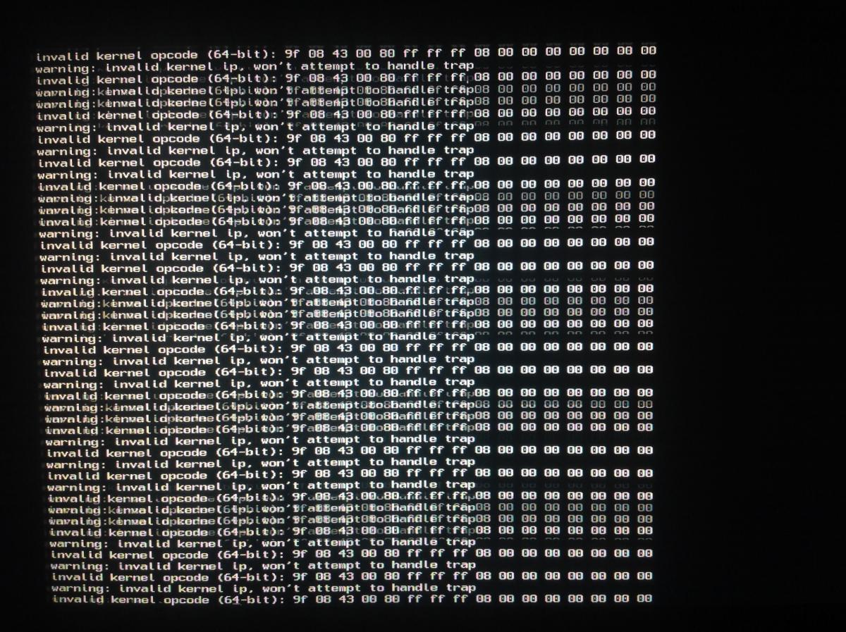

I am building a new test kernel, I think that I will be finished in about 2 minutes, then I upload the kernel
please check this
AMD10.12_SSEPlus_Older CPUs.zip
Share this post
Link to post
please check this

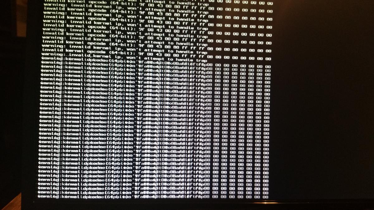

What version of 10.12 you want to test for this one ?
10.12GM, 10.12.1, or 10.12.3 ?
I have tested with all 3 versions and all got KP after VM Swap Subsystem is ON due to invalid opcodes.....
for Phenom II & FX-6300 hackintosh.
Share this post
Link to post

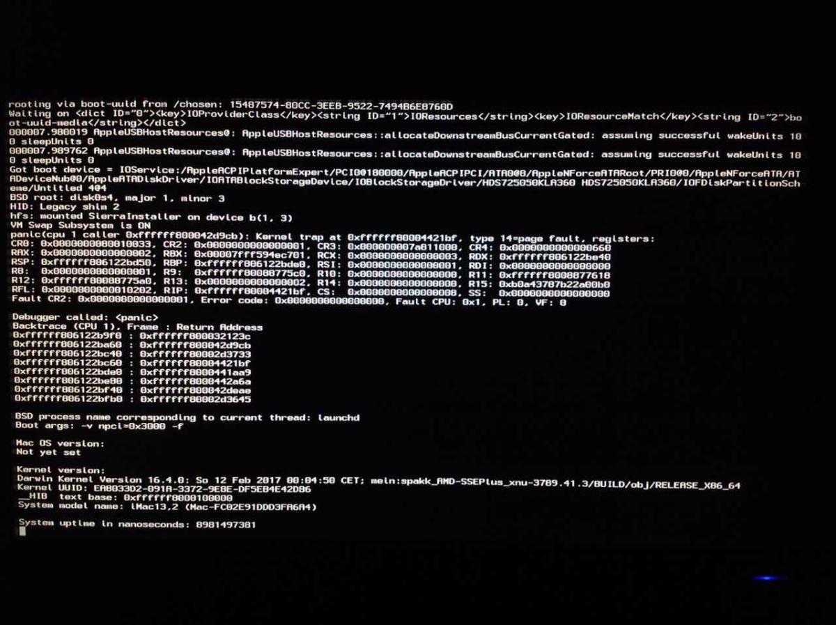

please check this
My other system AMD Athlon II X4 640
Results:
normal boot:
-f -v boot flag:
Share this post
Link to post
Results:
normal boot:
-f -v boot flag:
Hey BCBoy
make a backup of S/L/E and replace the AppleACPIPlatform.kext and IOPCIFamily.kext from El Capitan and generate a new prelinked Kernel then start the system again and report us
...or check this kernel (before) without changing the drivers:
10.12_SSEPlus_older_CPU.zip
Edited by spakk
Share this post
Link to post

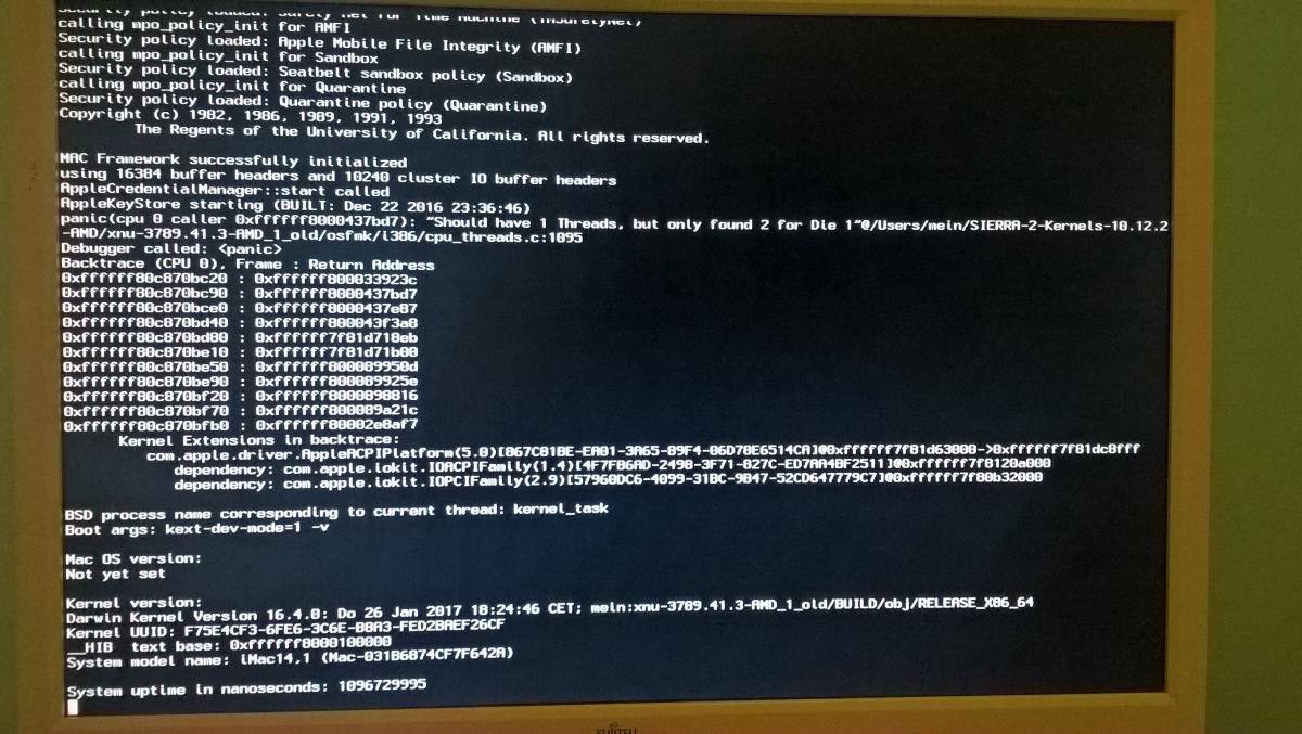

please check this

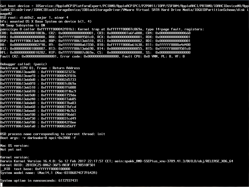

Hi!
My cpu AMD Phenom II B45.
My system 10.12.3 installer.
Share this post
Link to post
Hi!
Yes, i had a similar KP message with yesterday's kernel, please check the last kernel
Share this post
Link to post
Share this post
Link to post
Yes, that was a test,
I have an error in trap.c, which I've still to fix. Thank you for your quick report
Share this post
Link to post
Hey BCBoy
2 replaced kext receive an error message
Share this post
Link to post
Drivers replaceing brought unfortunately no positive results ... I try to fix the errors in the last kernel, then we look further.
Edit:
I had previously had problems with my hackintosh, system crashes :( , now continue to work at kernel building.
Edit:
I hope that something will happen, here my new kernel
EDIT.:
..... warning: invailed ip, won't attempt to handle trap
...invailed Kernel opcode (64-bit) ...........
but
check it with your CPU and report us your results, thx
Kernel.zip
Edited by spakk
Share this post
