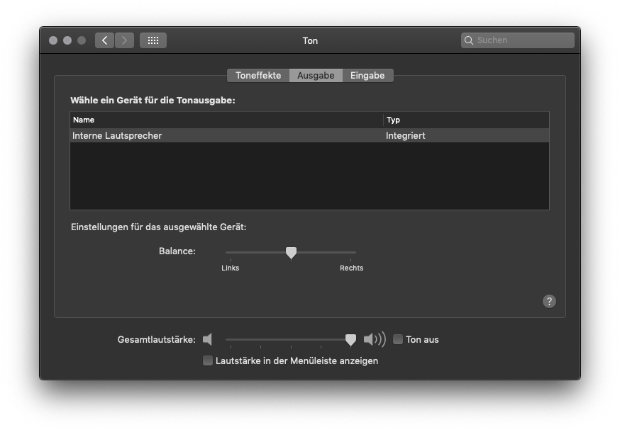

an3k Posted January 20, 2019 Share Posted January 20, 2019 9 minutes ago, Andres ZeroCross said: Try this,, keep using LayoutID=21 AppleALC.kext.zip No headset connected: output device -> "Internal Speakers" -> working input device -> none -> not working Headset connected: output device -> "Headphones" -> working input device -> none -> not working Link to comment https://www.insanelymac.com/forum/topic/311293-applealc-%E2%80%94-dynamic-applehda-patching/page/152/#findComment-2660210 Share on other sites More sharing options...
Andres ZeroCross Posted January 20, 2019 Share Posted January 20, 2019 22 minutes ago, an3k said: No headset connected: output device -> "Internal Speakers" -> working input device -> none -> not working Headset connected: output device -> "Headphones" -> working input device -> none -> not working Try this AppleALC.kext.zip Link to comment https://www.insanelymac.com/forum/topic/311293-applealc-%E2%80%94-dynamic-applehda-patching/page/152/#findComment-2660218 Share on other sites More sharing options...
an3k Posted January 20, 2019 Share Posted January 20, 2019 4 minutes ago, Andres ZeroCross said: Try this AppleALC.kext.zip Exactly the same behavior as with the previous kext. Link to comment https://www.insanelymac.com/forum/topic/311293-applealc-%E2%80%94-dynamic-applehda-patching/page/152/#findComment-2660220 Share on other sites More sharing options...

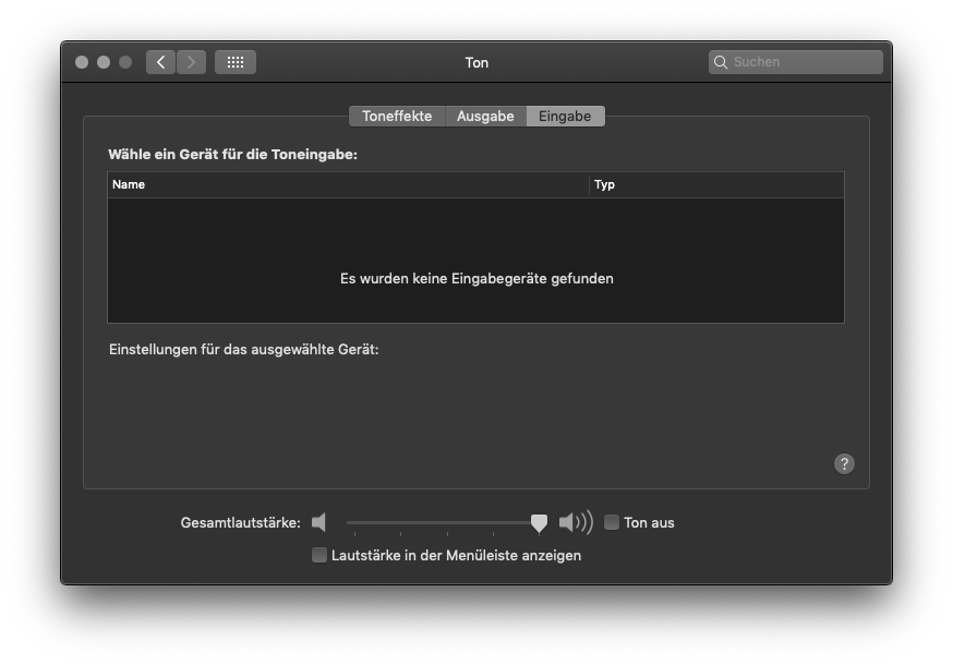

an3k Posted January 20, 2019 Share Posted January 20, 2019 (edited) 7 minutes ago, Andres ZeroCross said: Are you sure?? Check again your internal Microphone I am. Deleted all the AppleALC.kexts I had (in /System/Library/, in /System/Library/Extensions and in EFI/CLOVER) then re-downloaded the last kext and "installed" it. This is the result :/ EDIT: Well, I didn't had multiple AppleALC.kexts installed, was just making sure I actually didn't Edited January 20, 2019 by an3k Link to comment https://www.insanelymac.com/forum/topic/311293-applealc-%E2%80%94-dynamic-applehda-patching/page/152/#findComment-2660224 Share on other sites More sharing options...

an3k Posted January 20, 2019 Share Posted January 20, 2019 7 minutes ago, Andres ZeroCross said: Try this AppleALC.kext.zip Again the same No headset connected: output device -> "Internal Speakers" -> working input device -> none -> not working Headset connected: output device -> "Headphones" -> working input device -> none -> not working Link to comment https://www.insanelymac.com/forum/topic/311293-applealc-%E2%80%94-dynamic-applehda-patching/page/152/#findComment-2660234 Share on other sites More sharing options...
Andres ZeroCross Posted January 20, 2019 Share Posted January 20, 2019 2 minutes ago, an3k said: Again the same No headset connected: output device -> "Internal Speakers" -> working input device -> none -> not working Headset connected: output device -> "Headphones" -> working input device -> none -> not working Try this,, i remove LineIn Path map.. Check your internal microphone AppleALC.kext.zip Link to comment https://www.insanelymac.com/forum/topic/311293-applealc-%E2%80%94-dynamic-applehda-patching/page/152/#findComment-2660235 Share on other sites More sharing options...
an3k Posted January 20, 2019 Share Posted January 20, 2019 4 minutes ago, Andres ZeroCross said: Try this,, i remove LineIn Path map.. Check your internal microphone AppleALC.kext.zip No headset connected: output device -> "Internal Speakers" -> working input device -> "Internal Microphone" -> working Headset connected: output device -> "Headphones" -> working input device -> "Internal Microphone" -> working Link to comment https://www.insanelymac.com/forum/topic/311293-applealc-%E2%80%94-dynamic-applehda-patching/page/152/#findComment-2660239 Share on other sites More sharing options...
Andres ZeroCross Posted January 20, 2019 Share Posted January 20, 2019 3 minutes ago, an3k said: No headset connected: output device -> "Internal Speakers" -> working input device -> "Internal Microphone" -> working Headset connected: output device -> "Headphones" -> working input device -> "Internal Microphone" -> working Nice,, now try this. I put back LineIn path map but without AMP. Post the result AppleALC.kext.zip Link to comment https://www.insanelymac.com/forum/topic/311293-applealc-%E2%80%94-dynamic-applehda-patching/page/152/#findComment-2660241 Share on other sites More sharing options...
an3k Posted January 20, 2019 Share Posted January 20, 2019 4 minutes ago, Andres ZeroCross said: Nice,, now try this. I put back LineIn path map but without AMP. Post the result AppleALC.kext.zip No headset connected: output device -> "Internal Speakers" -> working input device -> none -> not working Headset connected: output device -> "Headphones" -> working input device -> none -> not working Link to comment https://www.insanelymac.com/forum/topic/311293-applealc-%E2%80%94-dynamic-applehda-patching/page/152/#findComment-2660243 Share on other sites More sharing options...
Andres ZeroCross Posted January 20, 2019 Share Posted January 20, 2019 3 minutes ago, an3k said: No headset connected: output device -> "Internal Speakers" -> working input device -> none -> not working Headset connected: output device -> "Headphones" -> working input device -> none -> not working I removed LineIn path map, and change input node for Internal Mic. Post the result AppleALC.kext.zip Link to comment https://www.insanelymac.com/forum/topic/311293-applealc-%E2%80%94-dynamic-applehda-patching/page/152/#findComment-2660248 Share on other sites More sharing options...
