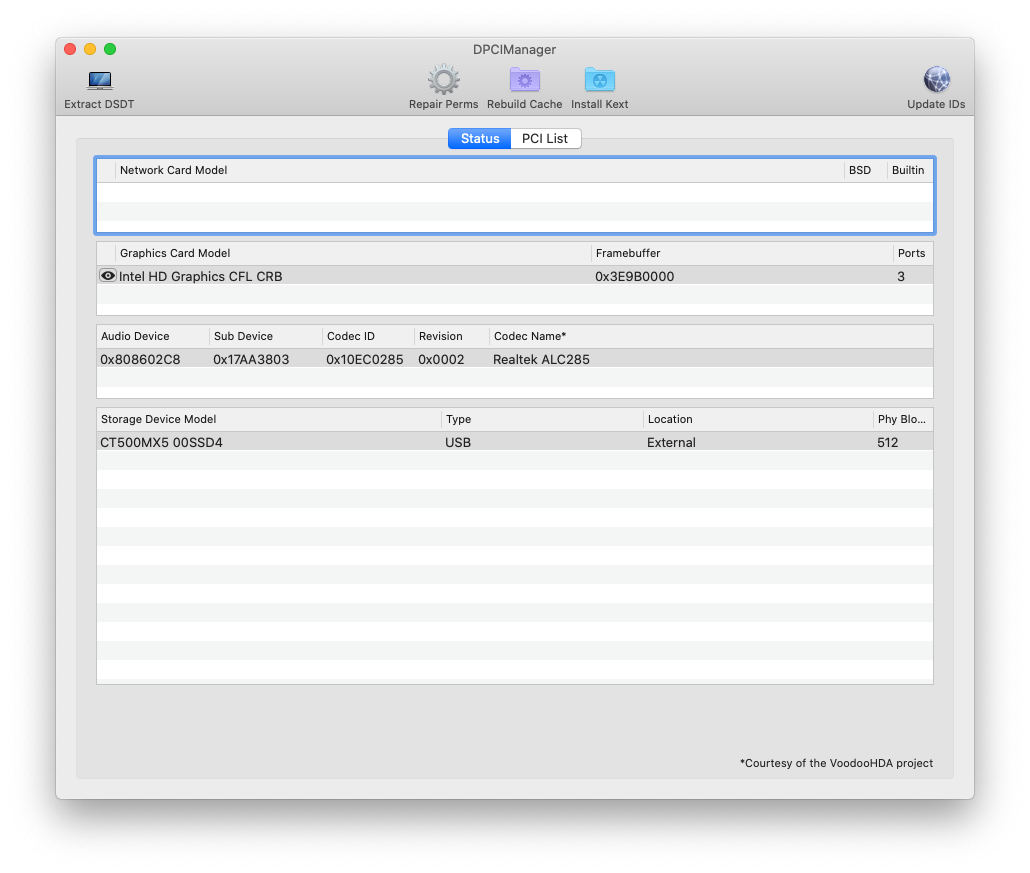

Howdy!  I'm working on a Lenovo Yoga C740 laptop and I'm having trouble with custom layouts.  I think I might need to add a controller since it's a Comet Lake machine but I'm not sure.  Here is all of the data I have available if you could provide a bit of guidance that would be incredibly helpful.
The report is meant to contain:
1. Laptop model/Motherboard model
Lenovo Yoga C740 (i5-10210u Comet Lake)
2. Codec name
ALC285
3. Layout used with the info what works for you (ideally if you try them all)

Audio Controller:
00:1f.3 Multimedia audio controller: Intel Corporation Device 02c8

Codec: Realtek ALC285
Address: 0
AFG Function Id: 0x1 (unsol 1)
Vendor Id: 0x10ec0285
Subsystem Id: 0x17aa3818

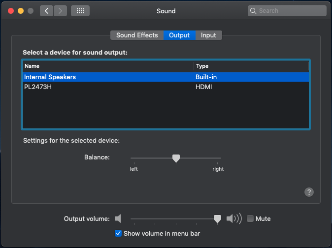

On 12/25/2019 at 7:06 PM, Andres ZeroCross said:
Try release version AppleALC.kext with LayoutID = 22
I was too fast with saying that it works, the internal speakers don't work. I didn't notice since I always have external speakers connected through AUX.
My internal speakers do show up, but no sound. Audio over AUX, HDMI, USB-C > HDMI and microphone all work.
I tried reverting back to the custom 1.3.3 attached to the previous post and changing Layout-ID back to 3, that didn't bring sound back either. (Internal speakers still work in Windows)
I remember I had this problem in the past, I solved it by updating my kext cache and a reboot but that doesn't work this time. (I did make a CloneZilla backup I could revert to worst case scenario)
Any idea why it stopped working?
