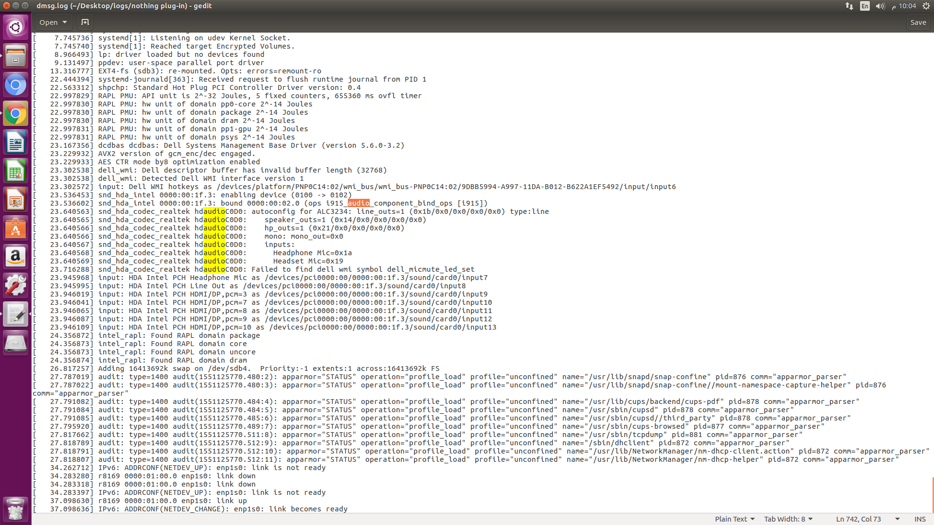

Posted (edited)
On 11/18/2018 at 4:43 AM, Andres ZeroCross said:
Use this config.plist,, remove your old config.plist and replace with this ones and reboot. Post the result and your IROEG Output too
config.plist
Hi I also have the Dell G7 with ALC256 however for some reason I tried that config and leaves me not even with ext audio. My main issue right now with clean AppleALC and CodecCommander both to /L/E/ is that built in mic doesn’t work and when headphones are plugged I get audio and no distortion noise however headphones mic doesn’t work either.
i also wonder why when I plug headphones I can’t seem to find internal speakers as output device so I can switch output device without having to disconnect headphones.
Here is my debug
Edit: I am using the ALC256 ssdt and just noticed that if I place CodecCommander in /S/L/E/ internal mic works fine but headphones are not even recognized.
debug_13640.zip
Edited by Darkrai1012

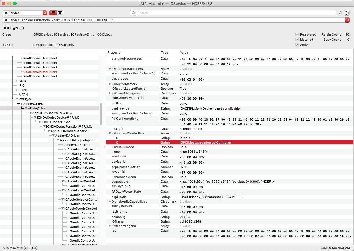

Hello everyone,
First of all, I started hackintoshing my Lenovo C530 Desktop about a month ago, so I'm not so experienced in this, if you want something you'll have to be more explicit about what do I have to do to provide it.
I have almost everything working now (except bluetooth and partially audio)
I heard about AppleALC and decided to give it a try (used VoodooHDA but the audio quality seems a little poor)
I have a special Audio Codec, Realtek ALC233, but the Vendor says something else: Vendor Id: 0x10ec0235 (ALC235 or ALC233?)
And from what I've found about these codecs is that they are made for mobile platforms (Laptops which have only 2 ports - one in one out), and my Desktop has 3 ports: one in back panel (think it's combo, and headphone and microphone in the front panel)
After installing AppleALC and trying all the layouts made for ALC233, only the 2 front jacks are working, the rear jack is not working at all (Installed Lilu, AppleALC, CodecCommander)
I want to mention that if I insert/remove a jack in the rear panel with headphones connected, the sound from the front panel is more amplified and the volume become significantly louder (I believe it's something to do with CodecCommander?)
Attached you can find my config.plist for debugging reasons and the codec_dump.txt from Ubuntu
Does someone have the time to explain me step by step what to do to enable the rear jack panel, please?
I have looked at the Info.plist from AppleALC.kext and found my current using layout at array no. 42, but I don't know what to insert there, hoping someone will help me here
I also see people screenshooting the IORegEx at HDEF entry, so attached you can find a screenshot of that too, but I don't know how to read things there
Thank you so much,
Andrei
