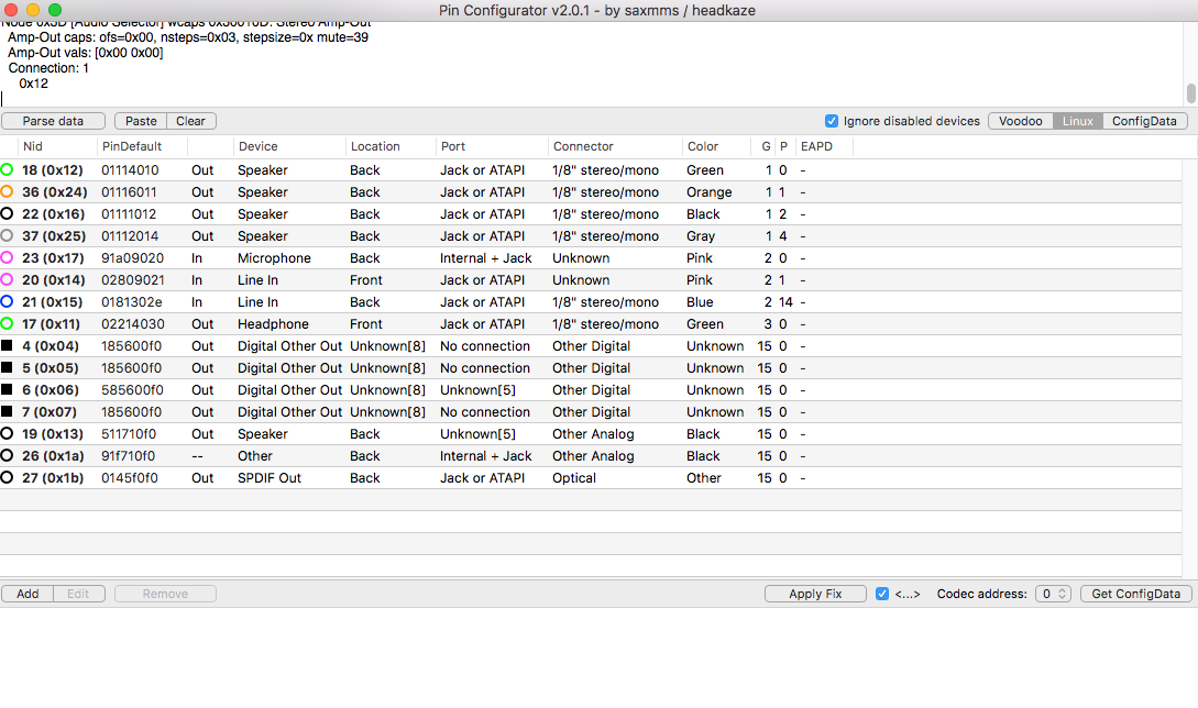

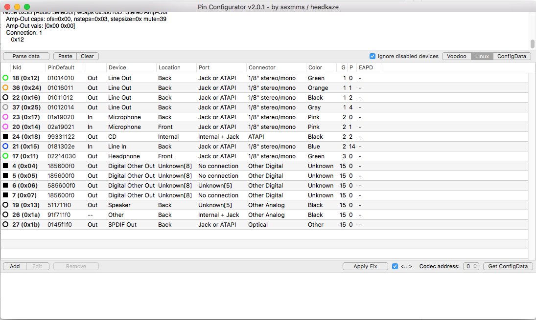

here is an example from real Mac layout=10
two speakers can have the same Group G=4 with different P=0 and P=1
i think there is no need to modify these data at all, codec defaults are OK for most cases
Color and location (front/back) seem to be "cosmetic" only, they do not modify any functionality

@Rodion2010 thanks again for your feedback. I have changed the verb sanitize rules.
Can you please try Pin Configurator v2.0.1 and let me know if it works correctly now?
Current verb sanitize rules:
  1. Remove 0x411111f0 / 0x400000f0
  2. Remove CD at INT ATAPI
  3. 71c - Index should always be 0 (No need - Rodion2010)
  4. 71c - Group should be unique (No need - Rodion2010)
  5. 71d - Set all Misc to 0 (Jack Detect)
  6. 71f - Front Panel change Location from 2 to 1 (Cosmetic only - Rodion2010)
  7. 71e - Line Out must be set to Speaker for Headphone autodetect to work correctly (Rodion2010)
  8. 71e / 71f - First Microphone Port set to Internal + Jack / Connector set to Unknown (Enables DSP Noise Reduction - Rodion2010)
  9. 71e - Second Microphone Device set to Line In / Connector set to Unknown (Ext Mic doesn't work on Hackintoshes - Rodion2010)

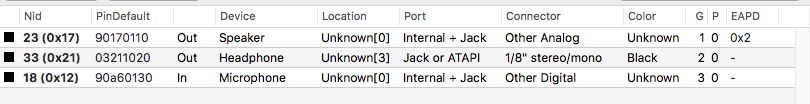

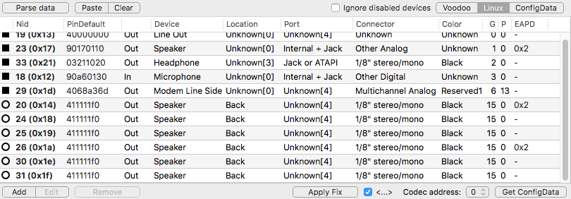

This is codec dump ALC256 from Acer Swift 3 (SF314-54G). Yes, if you read the codec Dump, we can't see device Fixed Internal Mic and Jack External mic. And with this app, we can only see Internal Speaker and Headphone. No other device output, i think we can activate internal mic or external mic with try another Node ID

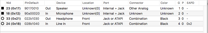

exactly it could reduce time , but still few things you still have to do manually
 old vs new both seems fine
1629821599_ScreenShot2019-02-10at12_42_51PM.thumb.png.dbc8a4f73f42844702b9627c912573d9.png
your codec_dump is strange no mic nodes there
Share this post
Link to post
Yes, it's from acer swift 3. Dumped from Linux Ubuntu
