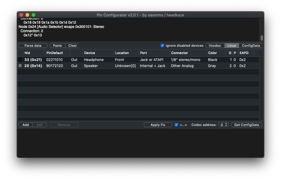

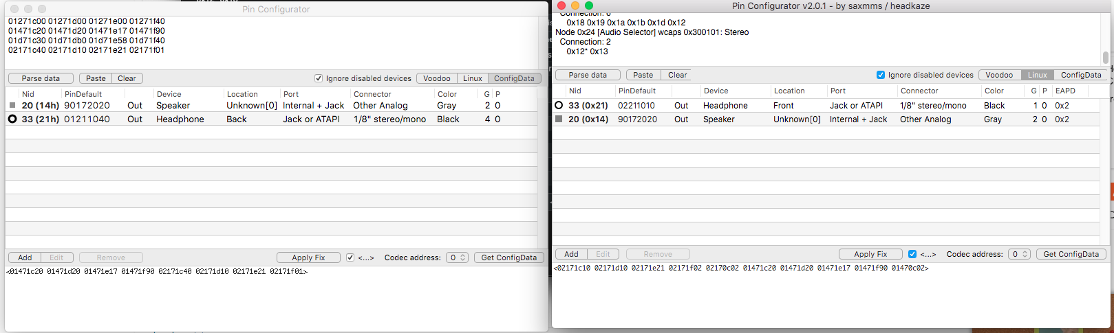

Hello!
I have a HP Probook 440 G5.
I followed an3k-s thread, because I have the same CX8200 Chipset. My Jack audio is not working, but the built in microphone to the headphones are working. (It's a standard headphone what I got with my phone)
I tried placing the kexts generated by you, in the EFI/CLOVER/kexts/Other folder, then restarting my laptop. But No change in the output devices.
Currently I have working Internal Speakers/HDMI audio, Internal Microphone/Headphones microphone.
Following this command, I got the following output.:
log show --predicate 'process == "kernel" AND (eventMessage CONTAINS "AppleALC" OR eventMessage CONTAINS "Lilu")' --style syslog --source
Security policy loaded: Lilu Kernel Extension 1.3.1 (Lilu)
(kernel) AppleALC:     alc @ alc-layout-id was not provided by controller at HDEF
Following this: https://github.com/acidanthera/AppleALC/wiki/Supported-codecs It also has my chipset listed.
Edit: https://github.com/acidanthera/AppleALC/releases
I replaced Lilu.kext and AppleALC.kext with the newest version available. But I still have no audio on my headphones. When I plug it in it does not recognise it. :(
I have also Linux system installed, it works there.
What did I miss or how can I solve the issue?
Thank you in advance.

You need CodecCommander.kext in Library/Extensions and use SSDT.aml or custom info.plist of codeccommander to set Pin Widget of your External Mic
