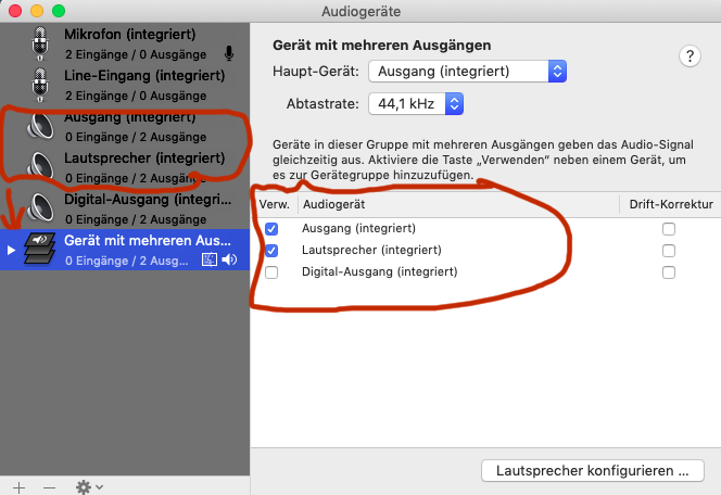

On 2/3/2019 at 6:08 PM, RayperZ said:
Is it not possible to have the tweeters and the speakers play together?
Yes
go to Utilities / Audio Midi Setup
Create with + "Create device with multiple outputs"
Choose and connect both internal speakers here!

6 hours ago, MacPeet said:
Yes
I've already did this, but I can't control both volumes at the same time, everytime I need to adjust them manually and individually, so I prefer to use speaker only and keyboard shortcuts too because the tweeter is recognized as headset or external speaker when something is plugged in in audio jack, so with the Multi-Output device I've this little issue...
I'll continue to study AppleALC patching and try it by myself while I wait for someone that help me before i become crazy. :wacko:

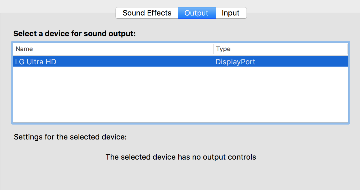

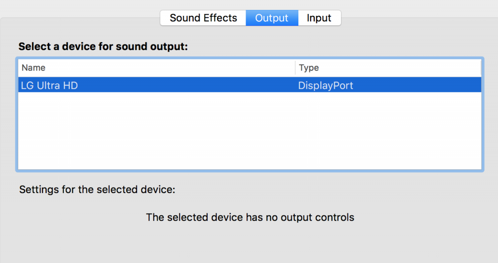

Hello, I use the latest lilu and AppleALC for my ALCS1220A, motherboard is Asus ASUS TUF Z390-PLUS GAMING (WI-FI). I can only see the Display port in Output. I can't use my headphone. I have tried layout 1,2,3,5,7, no luck.
Clover/ioreg/kextcache/codec dump as attached.
Thanks very much.
Thanks very much.
sldaniel.zip
Your codec is 0x10ec0b00 then it's ALCS1200A not ALCS1220A.
Check supported layoutID in AppleALC.kext, use latest AppleALC.kext and post the result (IOREG output)

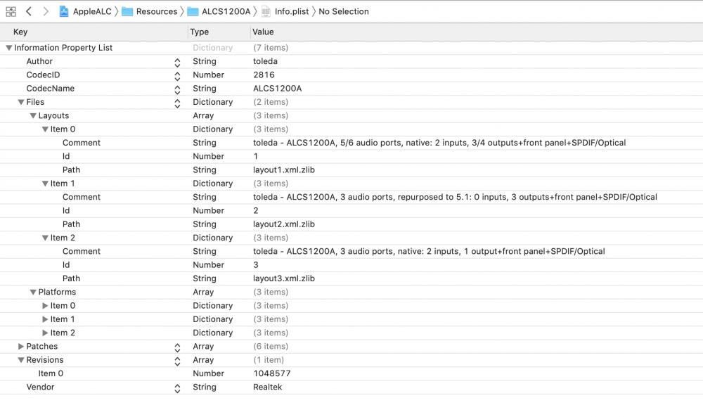

ALCS1200A is supported. Need to fix WiKi. Don't have time unfortunately:(
Share this post
Link to post

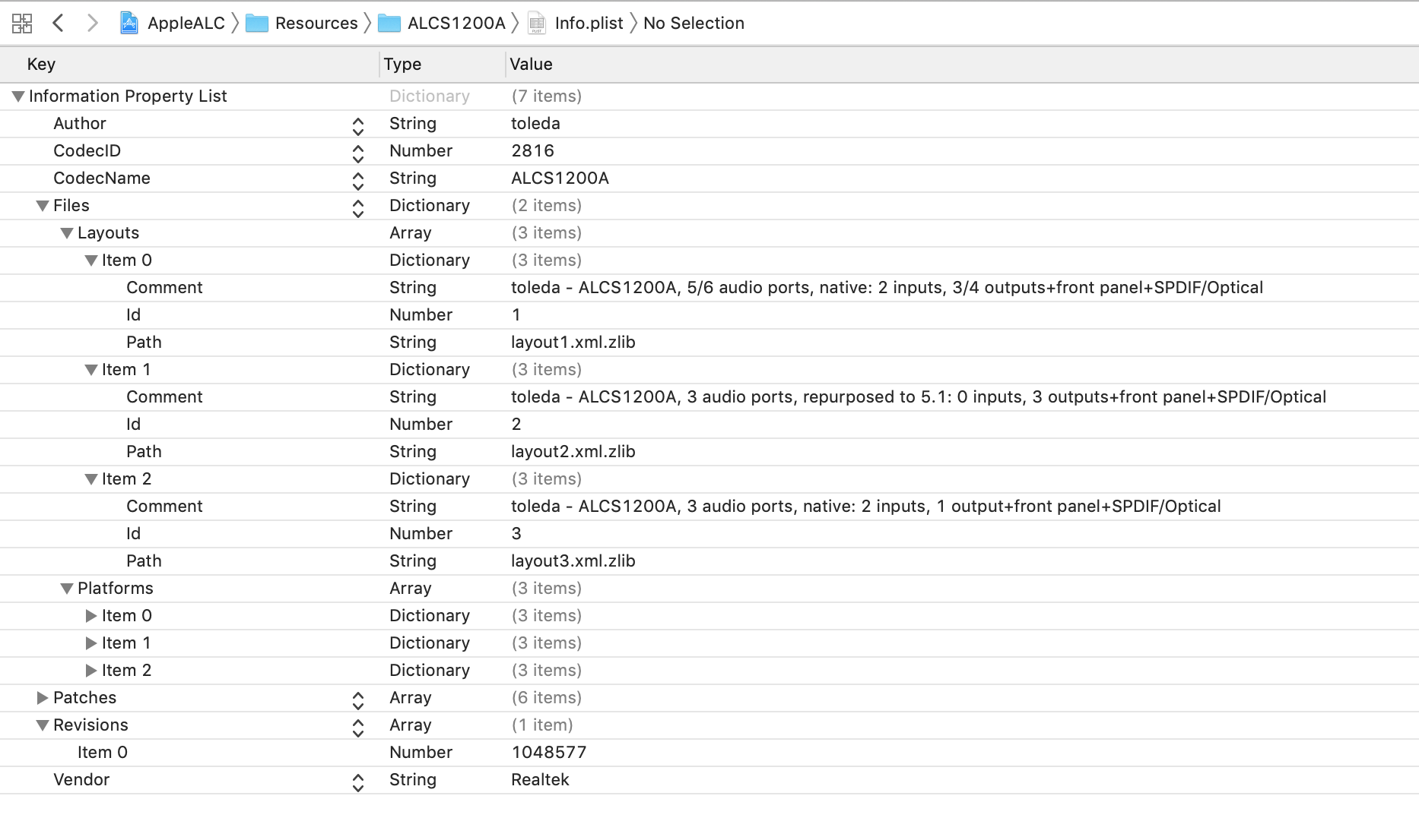

Yes, I thought it's not supported and after i see the Resource foldler I found the ALCS1200A. Now it works perfectly. Thanks very very much!

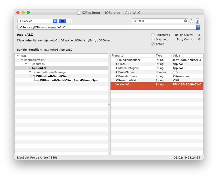

On 2/5/2019 at 2:27 PM, Andres ZeroCross said:
You still used 1.3.5 of AppleALC. Try to use version 1.3.4
Tried what you recomended but i still have no sound. In the meantime i got my codec dump from linux dont know if that helps
codec_dump.txt
IORegistry.ioreg
