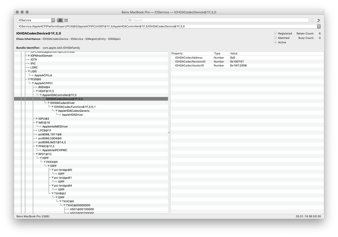

14 minutes ago, an3k said:
Used the attached AppleALC.kext and set layout-id 21: No External Output or Input but Internal Audio Out / In works as before: layout-id21.ioreg.zip

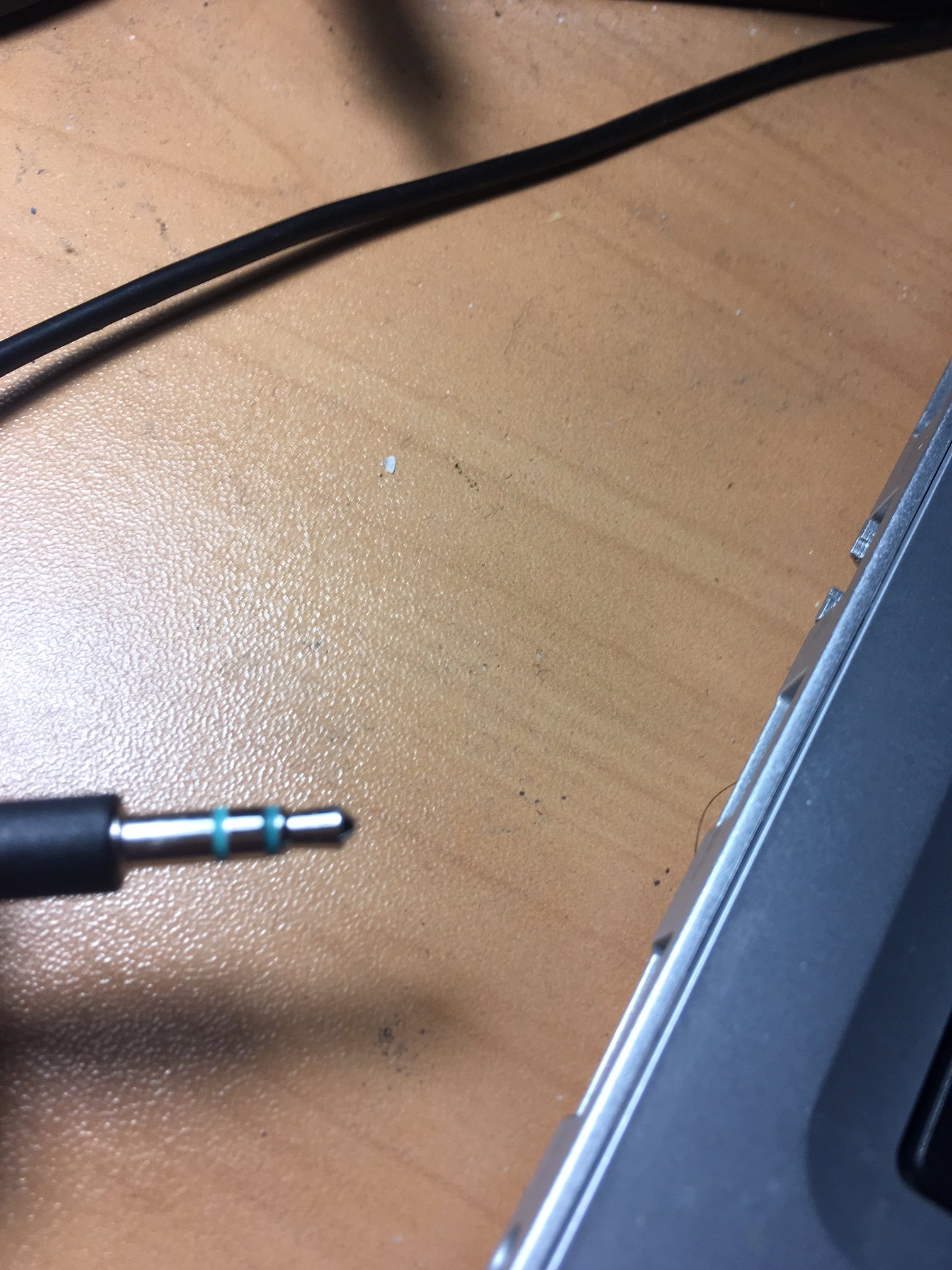

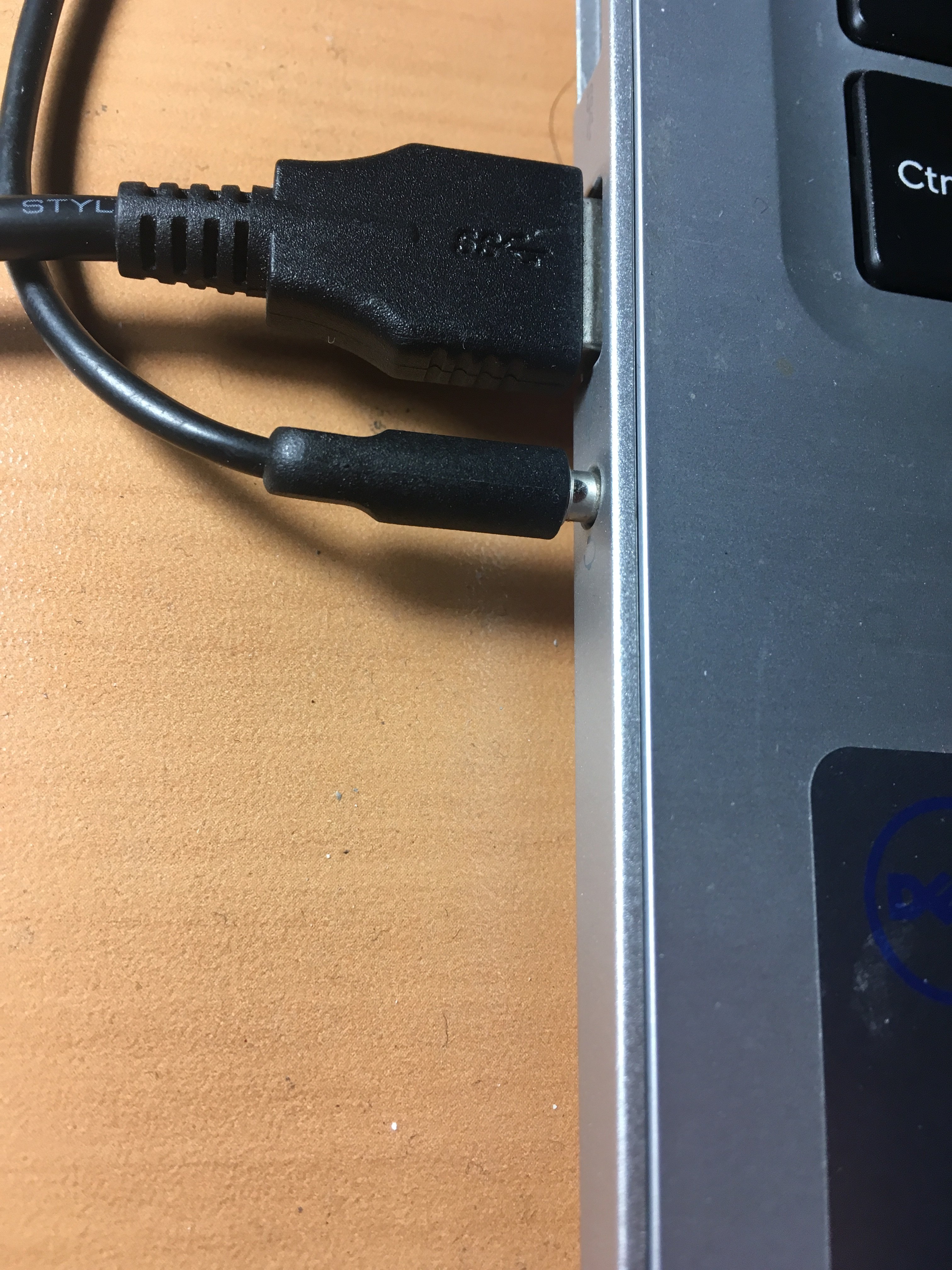

when it is "loose" there is sound.
I i plug it all the way sound is lost.
Take a photo of your jack connector.
Sent from my Mi Note 2 using Tapatalk
Share this post
Link to post
Same thing happens with my iphone earpods.
