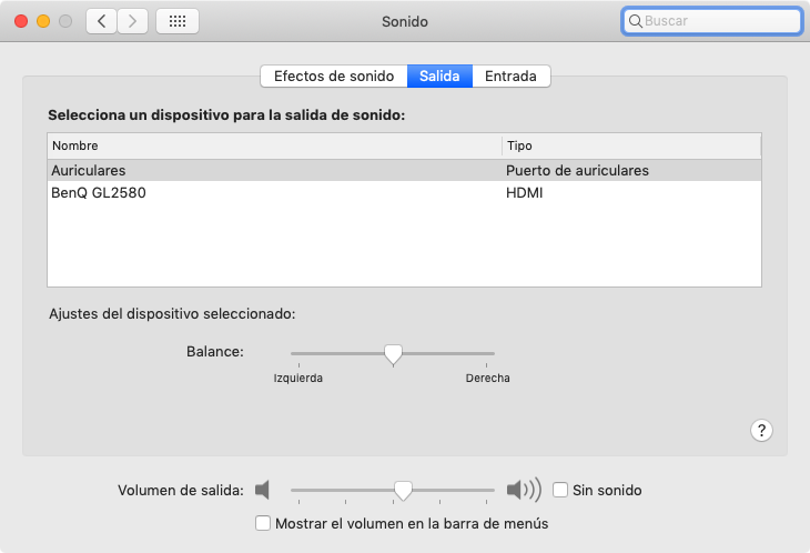

Yes , I tried all. 5,11,13,28 and 56.
All have the same problem. Audio from heaphones is lost after sleep.

12 hours ago, etc said:
The result is the same, no sound at all. When layout works, I hear a snap from the speakers when login screen appears. I don't hear it now.
UPD: Even layout #98 doesn't work, no sound either.

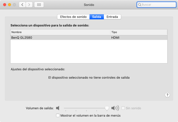

Now I have this file, can you to be worth?
In preference panel only I have HDMI. Thk for your help :)
STX.zip
Share this post
Link to post
STX.zip
Your files is useless for me
1. Where is your IOREG Output?? Upload your IOREG,, use IORegistryExplorer.app and save the output
2. Where is codec_dump.txt??? Use live linux to dump your codec info, you will get Codec_dump.txt from it
Share this post

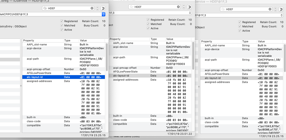

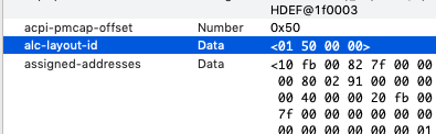

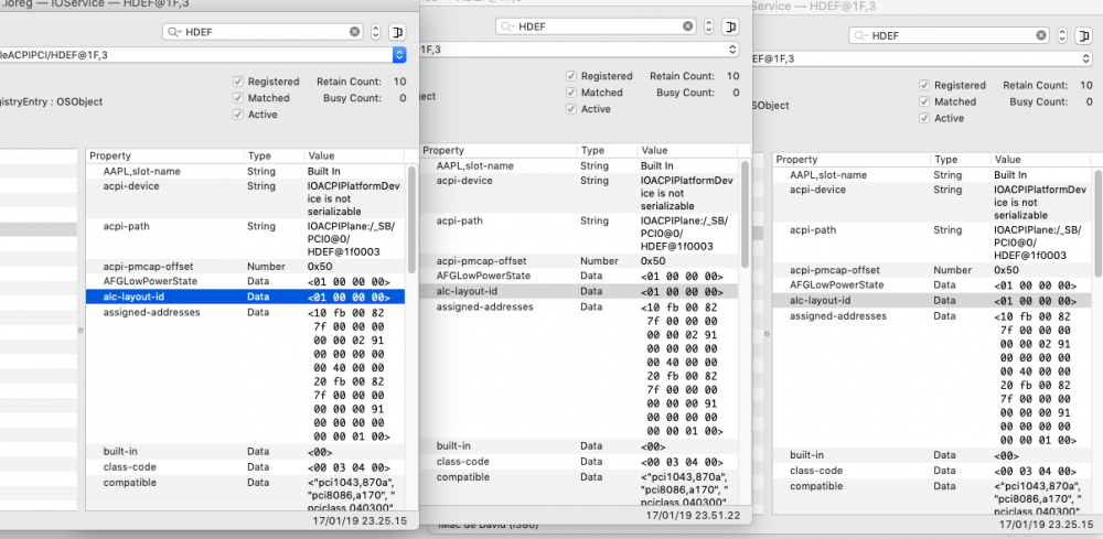

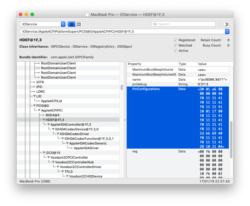

15 minutes ago, Andres ZeroCross said:
You put wrong value for HDEF. It should <15 00 00 00> for LayoutID = 21.
Use this config.plist, reboot and check your audio
Same problem nothing work except HDMI
MacBook Pro.zip
Share this post

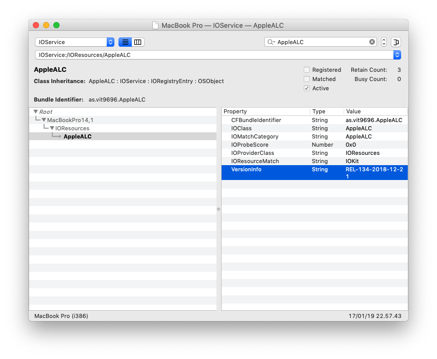

MacBook Pro.zip
Strange,, your IOREG show another Pinconfig. Did you really use my AppleALC.kext above???
Your IOREG show that you use AppleALC.kext version 1.3.4. I gave you 1.3.5.
Edited by Andres ZeroCross
Share this post
Link to post
2 minutes ago, Andres ZeroCross said:
Étrange, votre IOREG montre un autre Pinconfig. Avez-vous vraiment utilisé mon AppleALC.kext ci-dessus ???
This one , Yes!
AppleALC.kext.zip
Share this post
Link to post
3 minutes ago, paulopina said:
This one , Yes!
AppleALC.kext.zip
Your IOREG show that you used 1.3.4 of AppleALC.kext, You use wrong file or duplicate kext in your system
Just put and move all additional kext to EFI/CLOVER/Kext/Other. Don't touch Library/Extensions and System/Library/Extensions. Please use my AppleALC.kext above and Latest Lilu.kext
Share this post
Link to post
Just now, Andres ZeroCross said:
Votre IOREG indique que vous avez utilisé la version 1.3.4 de AppleALC.kext. Vous utilisez un fichier incorrect ou un kext en double dans votre système.
Yes, you're right
I put your kext in L/E, but i forget to erase from clover the release one
Share this post
