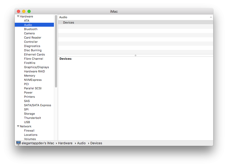

Thank you so much! but still won't work. please see the IOREG attached. And I've also attached an IOREG file using voodoo, and I hope it could help?
With voodoo, the sound card is ok, however HDMI sound won't work. please see attached screenshots.

Don't forget to open DPCIManager.app and take a screenshot at Status TAB. I need to verify your AUDIO and IRQ Problem from there

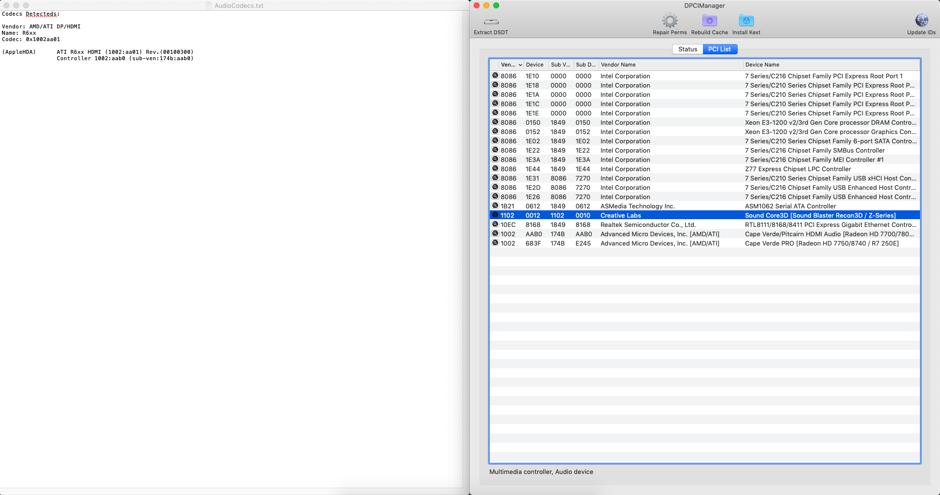

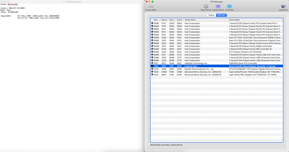

I attach a screenshot where there is a comparison between audiocodecs.txt(runme.app) and DPCImanager(PCI List+Status)

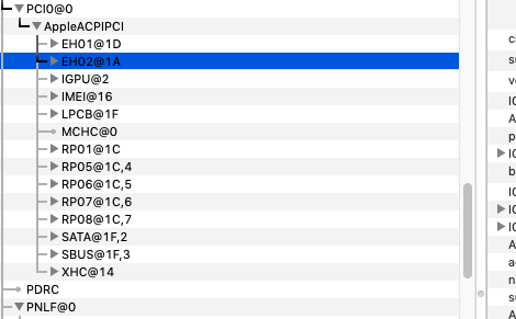

I don't see HDEF device in your IOREG, or device with same address. It's probably because you disable High Definition Audio from bios.
And property for HDEF need to be modified,, i modified it for you. Do this to make your audio work

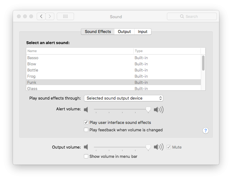

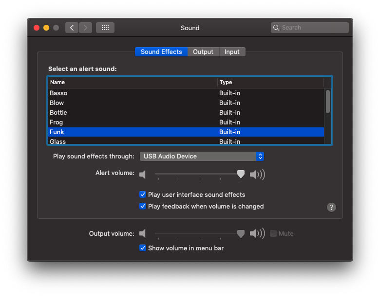

Thanks Andres! the sound card still works and Fn/mute also triggers mute. But differ audio to separate device still not.
More interesting is, it seems only matters the volume +/- effect sound. i.e.  setting "effect sound" to internal speaker works within the panel switching different sounds and also e.g. emptying trash can, but if use  Fn=>volume+/-, the effect sound goes to external speaker!
really strange.
Share this post
Link to post
Fn volume up + down is not sound effect. :)

PS: What's EH02@1A?
Owwh,, so your CA0132 is add on AUDIO CARD?? not Built-in ones???
