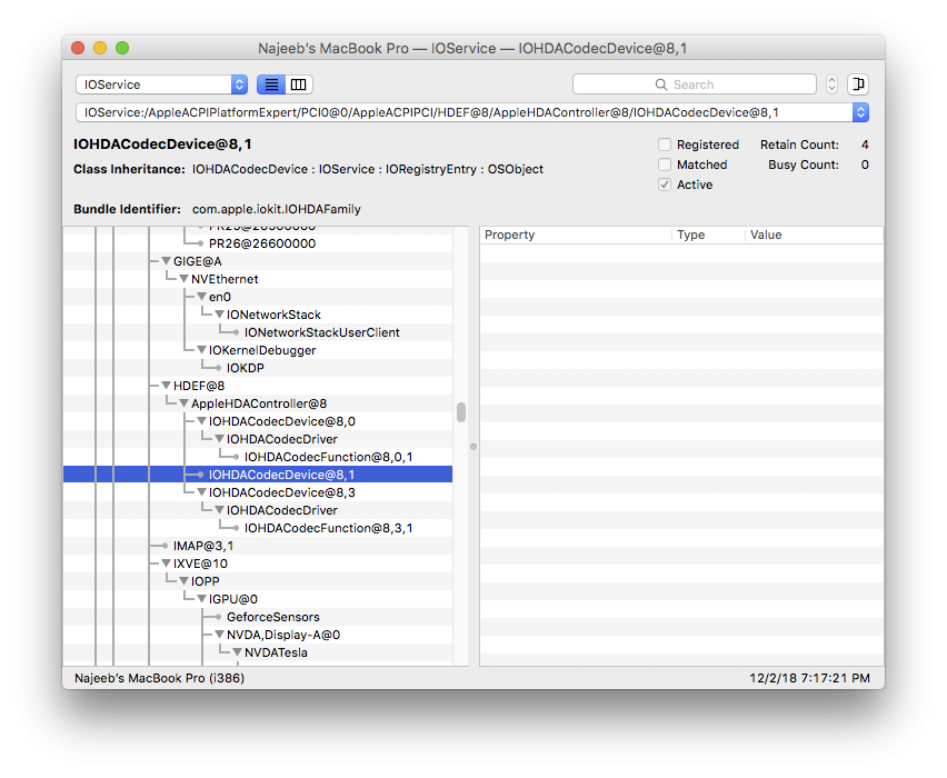

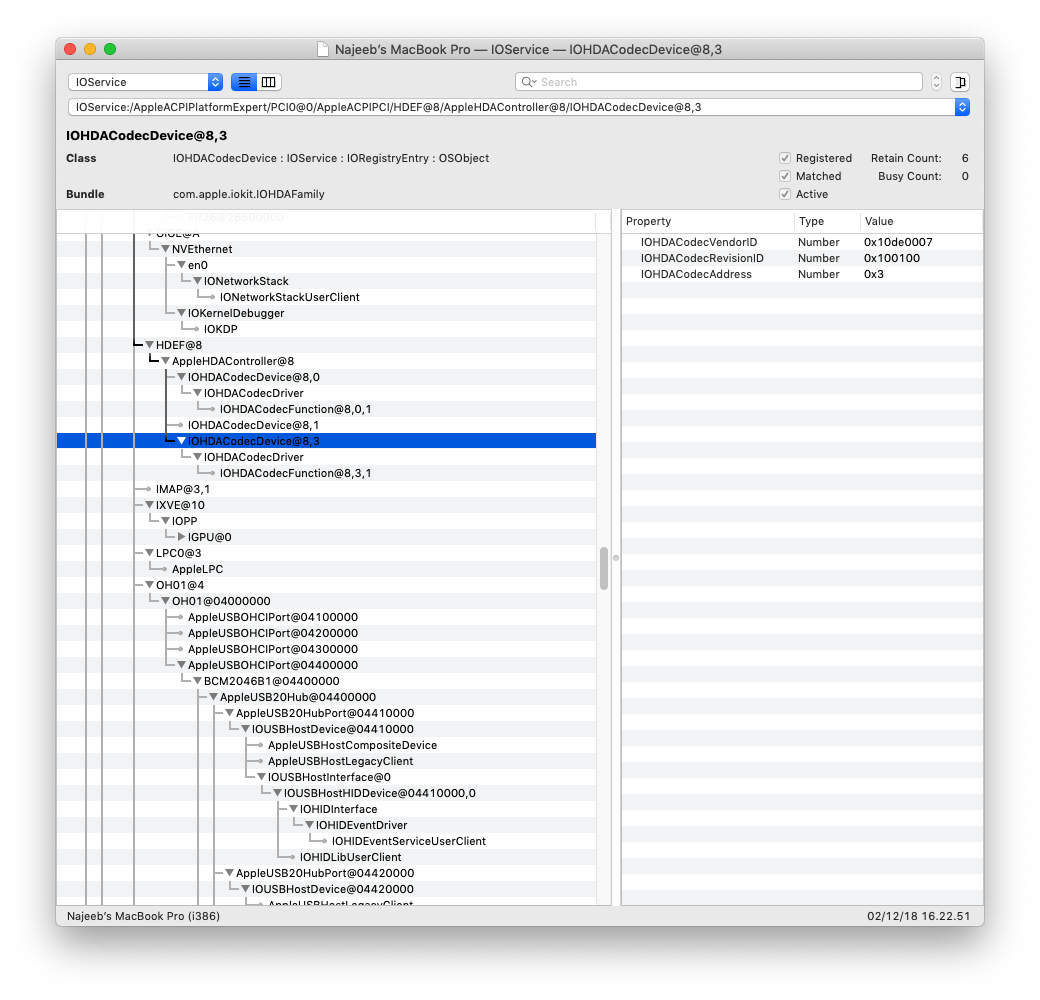

On 12/1/2018 at 4:34 AM, najeeb_anwer said:
Re: DPCIManager, why is there a NULL Codec in the list. I have not seen that before when I have used DPCIManager.
Attached is the output of RunMe.app
Send me Najeebs-MacBook-Pro.zip
use this DSDT.aml. REmove your old DSDT.aml in CLOVER/ACPI/Patched

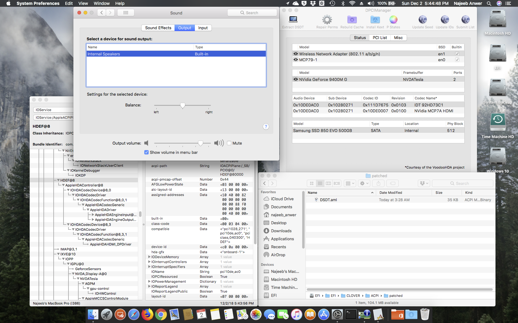

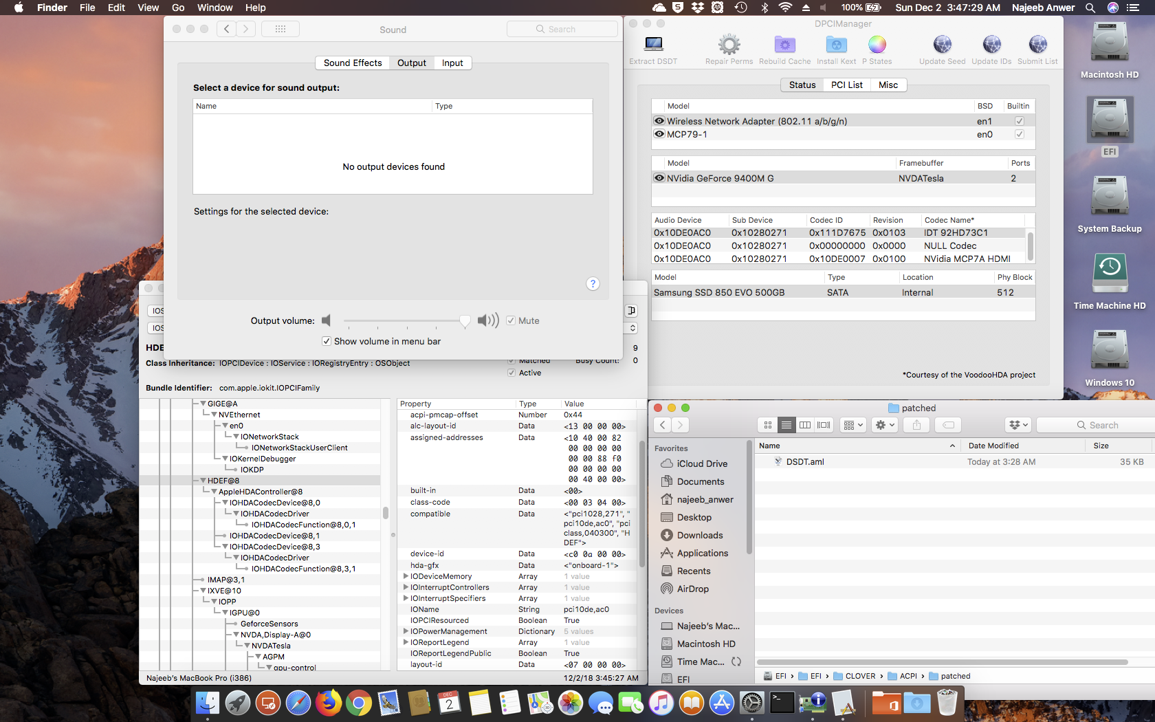

There is something wrong with the attached DSDT.aml. The system will not boot if I put it in CLOVER/ACPI/patched. Also, I cannot open it with MaciASL:
I should mention that I did get working audio without this new DSDT and without making any changes on one of my previous boots, so the problem appears to be sporadic.
When the audio worked, the only codecs shown in DPCIManager were the IDT 92HD73C1 and the NVidia HDMI. There was no NULL Codec - that appears to be the problem that causes AppleHDA.kext to exit.
It's your dsdt, not new one. It's only change about _DSM Properties for HDEF.
Not Boot because missing dependency with oem ssdt, or wrong config.plist configuration.
Before of this, you boot succesfully with this dsdt, so it mean you make "change" to your system config.plist and maybe patched.

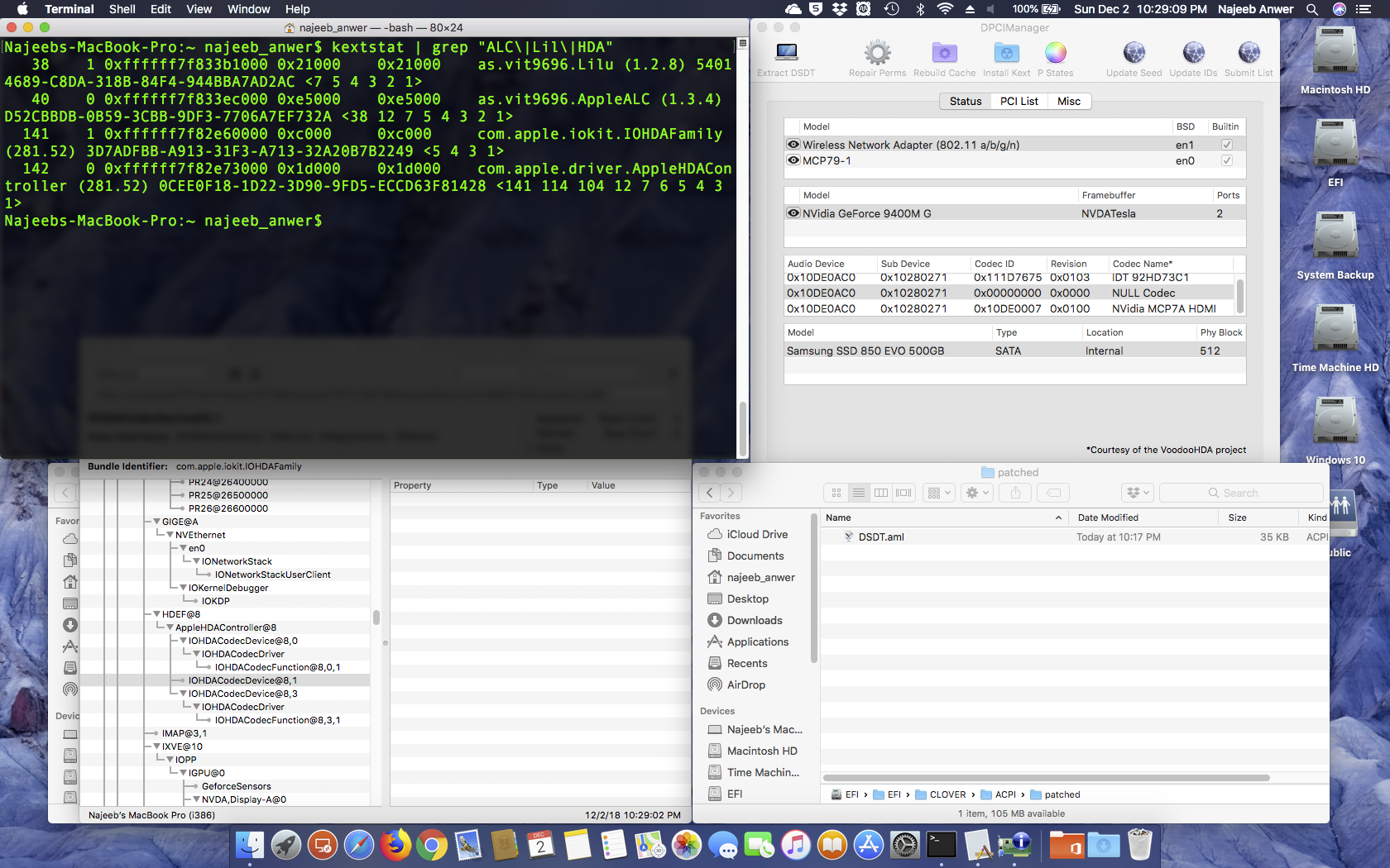

19 minutes ago, Andres ZeroCross said:
use this DSDT.aml
Still no audio. I believe it is because of the "NULL Codec", which is causing problems for AppleHDA and causing it to exit.
Anyway, it's almost 4am here and I'm going to sleep. I'll get back to this later. Thanks for your continued help on this.

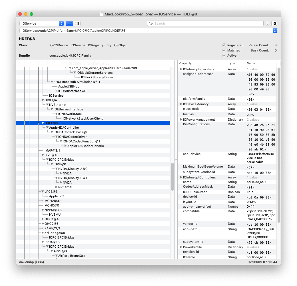

It's a Dell XPS M1340 with a NVidia motherboard chipset MCP79. It is almost identical in specs to Apple MacBookPro5,5 (2009).

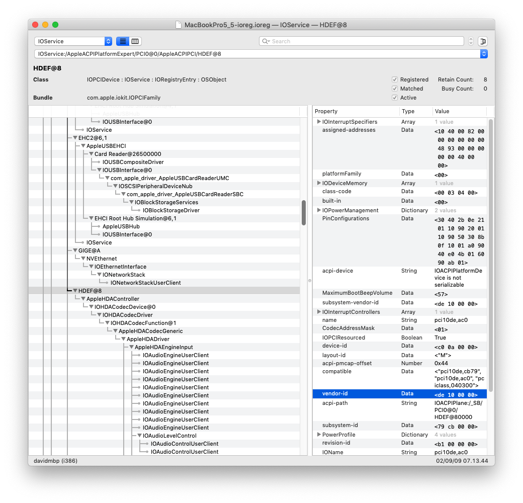

Attach ioreg before going to sleep

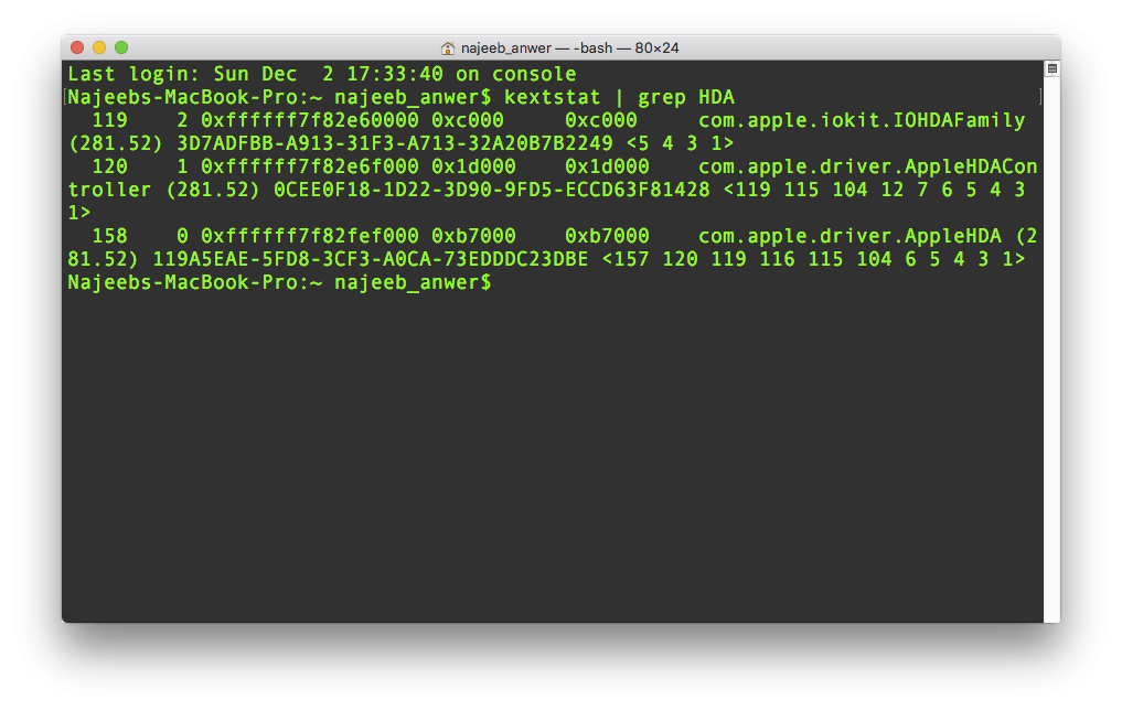

I think applealc try to attach HDMI audio in HDEF,,, it's look i need to set no-controller-inject to HDEF
