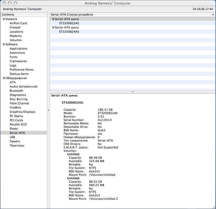

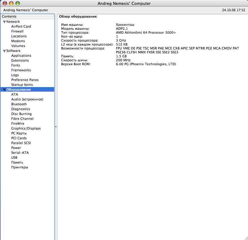

This pics from my Hackintosh... :D
For any questions in PM...
Best regards Hamlo from Russia
