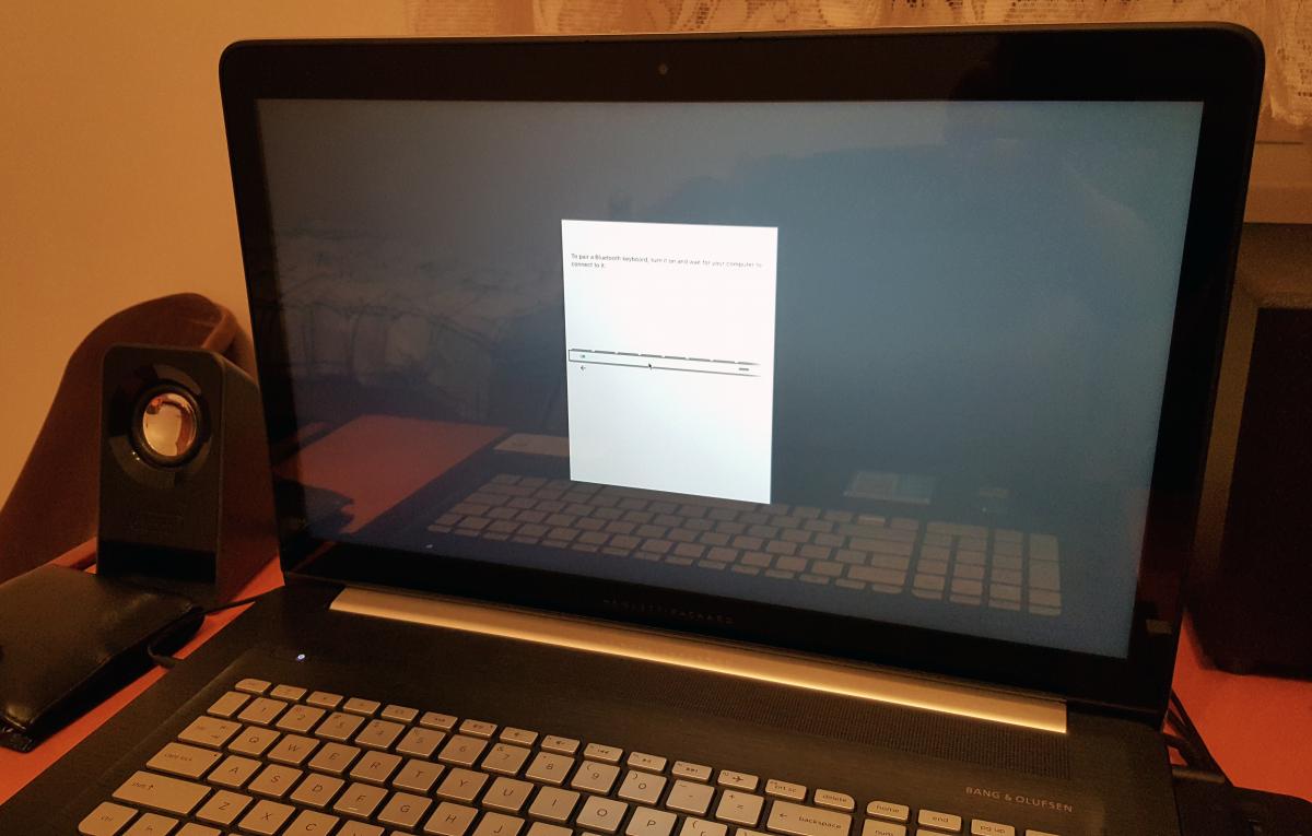

ionutzm05 Posted December 15, 2015 Author Share Posted December 15, 2015 Ok guys. Great progress here! I actually booted up to the installer screen without an issue. The only problem right now is that at this stage the installer won't detect my touchpad and my internal keyboard so I have to use external ones. If I boot up without any USB peripherals connected the installer brings up some animations with a mouse and a keyboard. After connecting a USB mouse I get a message telling me to connect a bluetooth keyboard. Since I don't have one I can't get past this screen but I'm sure from now on everything will work great. Tomorrow I'll buy an external USB keyboard so I can move on with my install (I heard that I also can put some PS2 kexts in the installer USB but I don't want to mess with these anymore if there is an alternative). Here are some of my notes until now: Intel HD 5500 is not a issue anymore if you upgrade to the latest BIOS version available on HP website (128MB DVMT memory is not a problem for El Capitan) You must use HFSPlus.efi and not VBoxHfs.efi in EFI/CLOVER/drivers64UEFI/ and you must replace OsxAptioFix2Drv-64.efi with OsxAptioFixDrv-64.efi in the same folder. I used an alternative method to create the bootable USB for El Capitan (can't write the name here, just find another alternative) that works much better than Clover OS X El Capitan USB utility (I just couldn't boot to the install screen by using this utility, I think it has something to do with Clover config). If everything works great I will make a guide on how to install El Capitan on this notebook but for now I have to get an USB keyboard . Here's a photo (sorry for the bad quality) to prove my progress. Link to comment Share on other sites More sharing options...
mnfesq Posted December 15, 2015 Share Posted December 15, 2015 I have encountered this but I use RehabMan's VoodooPS2Controller.kext. When I get to the point that it wants me to connect a mouse and keyboard, the cursor actually moves and there is an arrow I can press to get me past the mouse and keyboard prompts. If you are using a PS2 kext but can't get past the mouse and keyboard prompts, you can use a USB mouse and keyboard. Once you get past this, you go into the Bluetooth preferences and uncheck the boxes to prompt you to connect a mouse/keyboard when none are detected. OS X will not detect your PS2 trackpad/keyboard even when they are functioning. Hope this helps. BTW - pretty laptop. Mine is aluminum with black back-lit keys. P.S.- My El Cap installation is so stable that I have OS X on my mSATA SSD and Windows on my HDD (which I upgraded to a 7200 rpm I TB drive.) I rarely use my Windows installation and instead use Parallels to run Windows 10 but keep all my data for Windows on the Windows drive using Tuxera in OS X. In my second HD bay, I have another 1 TB 7200 rpm drive that I use to store my OS X data (mostly videos and music.) 1 Link to comment Share on other sites More sharing options...
ionutzm05 Posted December 15, 2015 Author Share Posted December 15, 2015 Awesome. Thanks for the info. I'm still going for the USB mouse and keyboard combination until I get over the install. Will post more when everything is running as it should . P.S. Envy 17t-3200 looks really amazing, close to a real MacBook. 1 Link to comment Share on other sites More sharing options...
