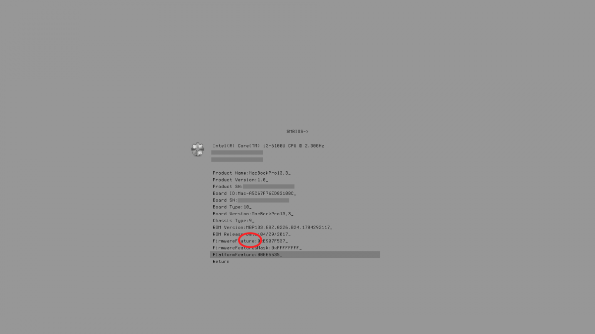

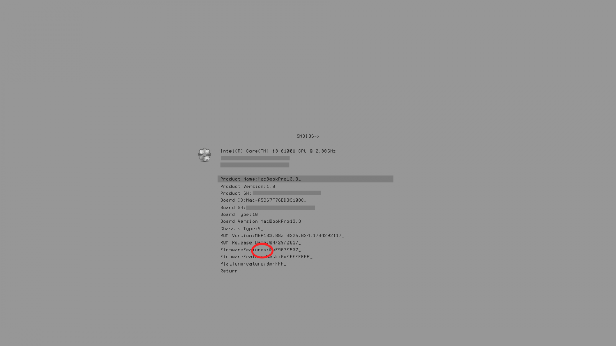

@Slice
i updated clover source.
i tested source with users during 4 days.
no problem.
PMheart added ML/MAV/YOS/EL debug kext inject code.
i added code. included my source files
but once i disable debug ML/MAV/YOS/EL
Because it causes more many boot times(search code has many) than before. to reduce boot time, just commented search ML/MAV/YOS/EL kernel debug.
sorry my english
updated list
-platform data
-kabylake gpu
-framebuffer informatio
-added APFS load info
-can read FirmwareFeaturesMask in gui with use FirmwareFeaturesMask in config.plist
-gathered FirmwareFeaturesMask, PlatformFeature. will can easily deal value(maintainance)
-fixed fakecpuid
-cleaned up code.
-etc
sourceforge i don't have exprience commit in sf.. apianti gave me r/w permission. it's hard for me than github. :rolleyes:
always thanks in advance.
removed file to avoid confusion.
i just edited files by fred's report.

Hi Sherlocks
A little error in setting.c
  Prop = GetProperty (DictPointer, "FirmwareFeaturesMask");
  if (Prop != NULL) {
    //gFwFeatures = (UINT32)GetPropertyInteger (Prop, gFwFeaturesMask);
    gFwFeaturesMask = (UINT32)GetPropertyInteger (Prop, gFwFeaturesMask);
    DBG ("FirmwareFeaturesMask: 0x%08x\n", gFwFeaturesMask);
Fred

Hi Sherlocks
  if (Prop != NULL) {
Fred
So, what it should to be? The correct one Sir.. thanks..  :)
Share this post
Link to post
Hi Sherlocks
  if (Prop != NULL) {
Fred
eagle eye thanks fred :)
