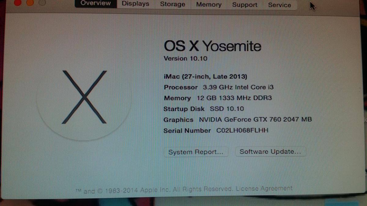

Hello to all,
First off I would like to say that I did away with Clover, didn't like it too much in 10.9 and didn't want to use it here either. Chameleon is just as good if not better...People have their opinions.
Audio: ALC892
Ethernet: Realtek 8111
Wi-Fi: Native Macbook Card on PCI conversion.
Yosemite was not that hard to install on my system as Mavericks was a breeze. I used a 16 GB flash drive created from the mac store app on my 10.9 installation.
I wanted to install Windows 8 at the same time on my SSD so I backed up desktop/downloads/documents/applications. If you have time machine I wouldn't worry too much about this.
Installer USB in 3.0 port did not work until I installed the kext (post-install).
I had to change my SMBIOS.plist in the /Extra folder on the USB to a iMac 14,2.
Boot Flags to reach the installer:
(Thanks to all the forums I tried everything and only this worked)
-v -f GraphicsEnabler=No npci=0x2000 kext-dev-mode=1 PCIRootUID=1 -xcpm
Also worked: nv_disable=1
I did get "still waiting for root device" a lot, cured it with -f and without npci=0x2000 don't know how but it worked.
Once installed my business partner erased my flash drive on accident so I had to remove my SSD and hook it up to a macbook to install chameleon onto it.
Edit* I pulled out one stick of 4 GB today and put an 8 GB stick in giving me 12 GB {RAM}. On boot with my normal boot flags, -v GraphicsEnabler=No -f
it kernel panicked right after the sound loaded. Tried some other combinations but would boot without any graphics (monitor flashing no input). Tried -v VBIOS=Yes -f -xcpm and worked like a charm.
Graphics Drivers I'm using for the GTX 760 2GB
Full QE/CI
CUDA Driver: 6.5.18
Web Driver: 343.01
