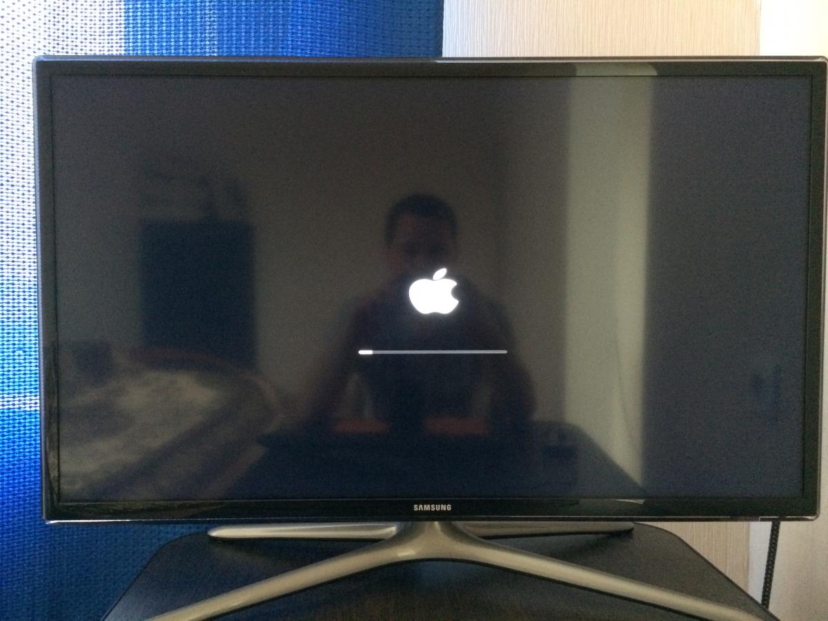

1) How to get screen resolution 1920x1080 on Clover & boot logo. By boot logo: black screen + apple (flattened) + progress bar. I use LCD TV as a monitor.

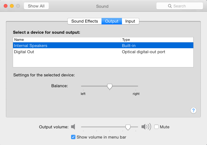

2) I use AppleHDA, need help to make the sound hdmi.

about the hdmi audio u need dsdt edition
and a proper applehda for ur alc

Clover can take care of the HDMI audio with its built-in DSDT patches (AddDTGP_0001, FixHDA_8000, NewWay_80000000, AddHDMI_8000000). Which audio output do you want to enable, Intel or GeForce?

I want enable hdmi audio on GeForce.

About the audio, it looks fine on Clover's side, you're injecting the layout and appropriate DSDT fixes. Perhaps the problem is on the driver's end. Can you upload an ioreg and DSDT dump? Have you tried with Toleda's patches? They're easier than ever since version 2.

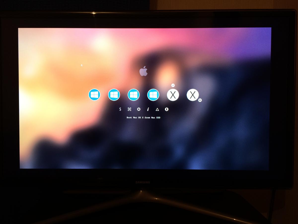

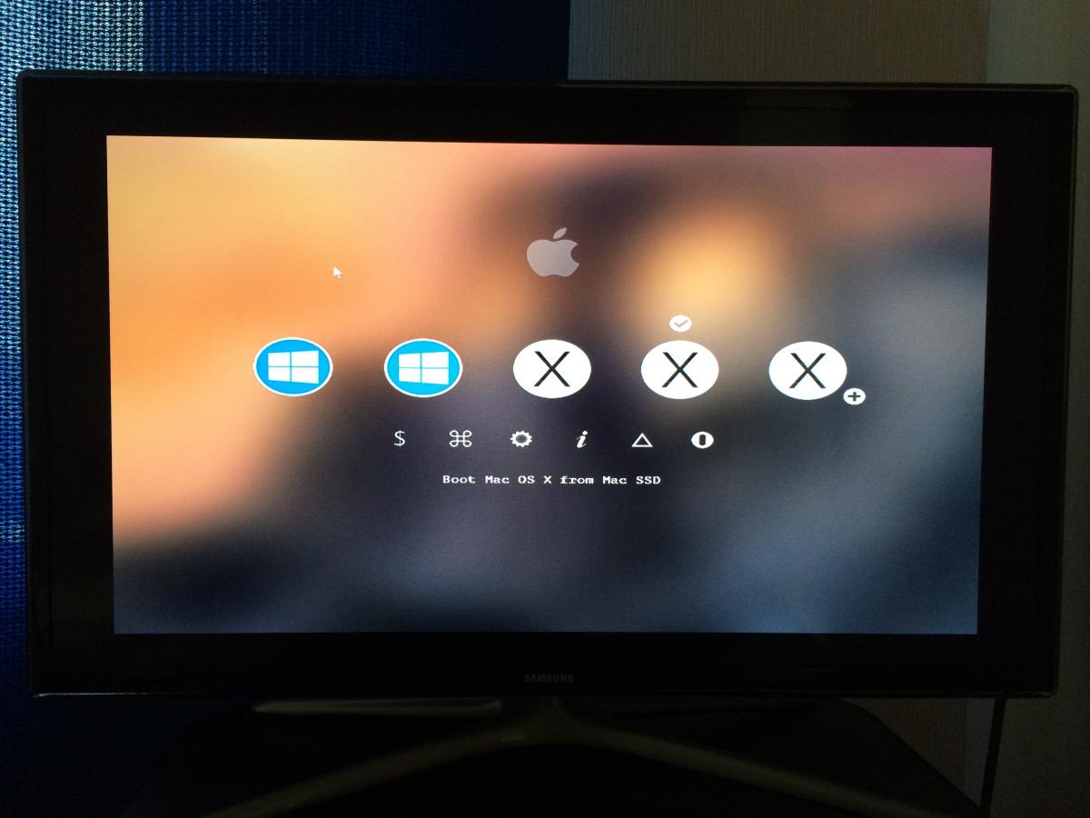

Thanks, i get EDID in Windows and inject it with Clover. Resolution screensavers Yosemite remained the same, icons and boot logo changed (they now seem to look right). The result on the photo. I tried to enter the PatchVBios (http://www.projectosx.com/forum/index.php?s=30211347b052ea140670975ef6522d9b&showtopic=2562&st=2840&p=22683&&do=findComment&comment=22683), the result remains the same.
By the way when loading Clover, information about Clover 1920x1080 resolution.

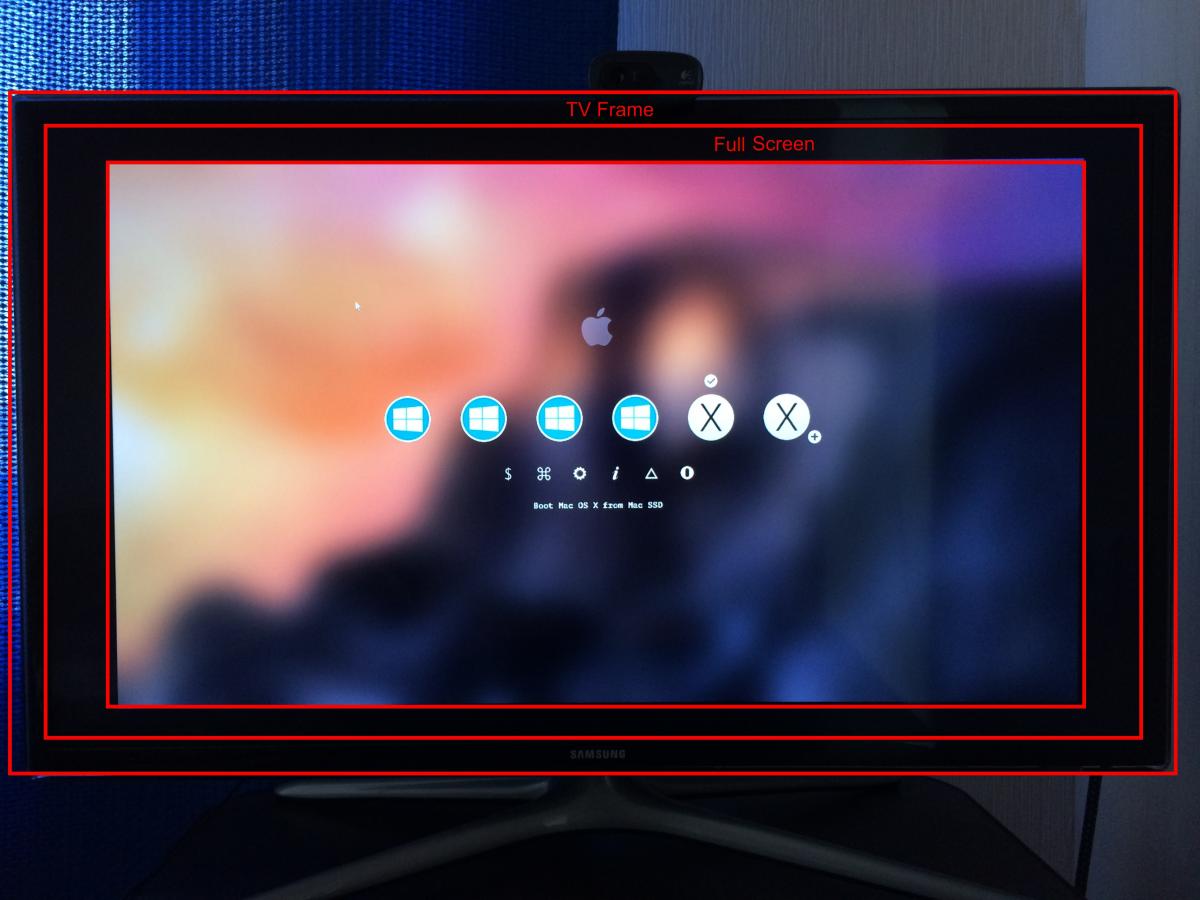

Resolution is still not the entire screen, not a full hd. I made ​​a new picture and designated frame.

That issue is on your TV's side, I get the same on mine. You just need to set the proper scaling for it to be fullscreen but it will later brake the desktop's own scaling (does in mine) forcing you to use the underscan function making it look like {censored} so I just prefer to leave it like that. It works fine after all.
EDIT: I still can't understand what's wrong with the HDMI audio, the necessary patches are in place so it only leaves me to question the audio kext functionality. Can you try to restore the original AppleHDA and run Toleda's patcher? It's really easy since version 2.0, you just need to run it, answer a couple of questions and it does it all for you. Get it here (the part titled cloverALC/Clover patched).
I agree and leave. Especially since it's not so important. Now I use a timeout = 0.
I use this http://www.hackintoshosx.com/files/download/4058-updated-to-dp6-applehda-1010-dp-yosemite-alc887/ for DP4.
Thanks, i have original AppleHDA, try this patcher or maybe try this http://www.hackintoshosx.com/files/file/4176-audio-alc-clover-8858878888898928981150/ ?.
