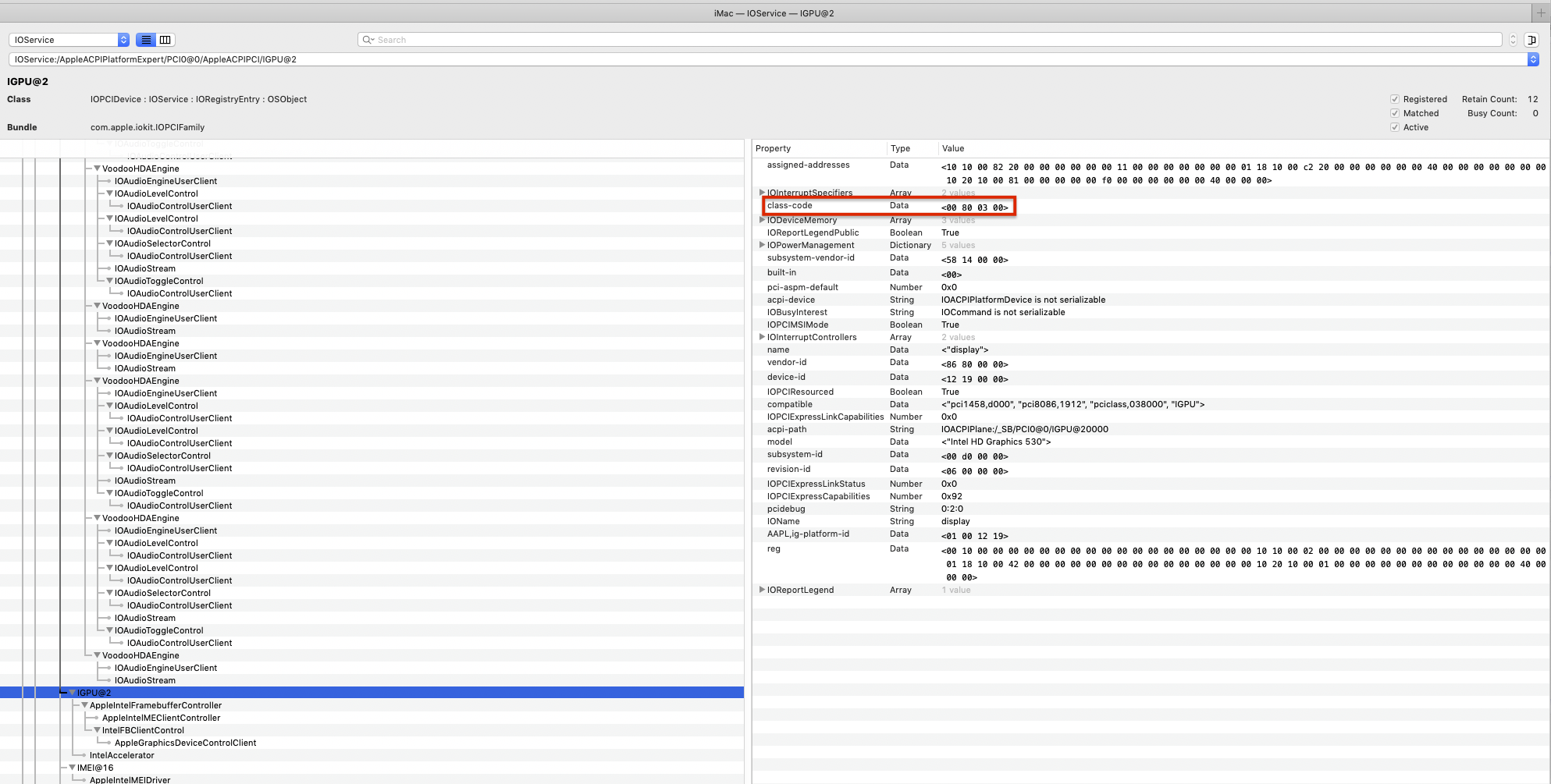

17 minutes ago, vector sigma said:
vclist actually exclude any doesn't have a class-code other than 00000300 and I didn't remember what I do in HWMonitorSMC2, but I think the IGPU has another one, why is not listed.
should be there anyway, check your class-code
This?

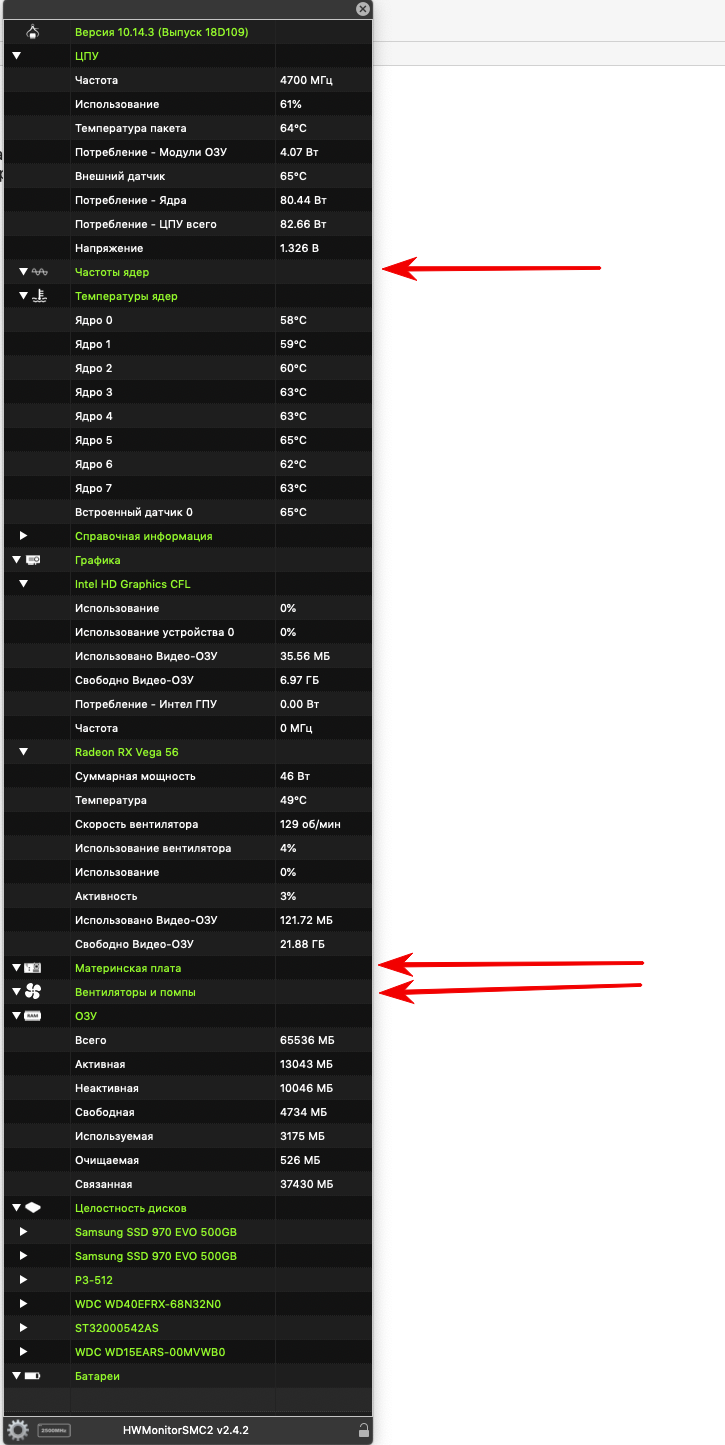

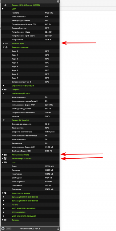

Good day.
I assembled a computer with such a complete set. https://docs.google.com/spreadsheets/d/10Xz0XP6VxcxInDUzrv9r5judqZ7OO5OzYBF14-eMucI/edit
I do not show the frequency of the processor cores, does not show the speed of rotation of the fans and the temperature on the motherboard.
What you need to do to make it all work.
Share this post
Link to post
3 hours ago, AKlion said:
Good day.
Hi, in order to having all the missing sensors you have to install:
  • ACPIMonitor.kext,and edit your DSDT to make it work (otherwise don't expect it to work)
  • install IntelCPUMonitor.kext if want see single frequencies for each core.
  • only one of ITEIT87x.kext or PC8739x.kext or F718x.kext or W836x.kext (depending on what you have) to have LPC sensors. This require you to edit the Info.plist of the kext chosen to show right information (search for @Slice's posts about instructions).
  • RadeonMonitor.kext if you want some additional stuff about your video card. But I'm sure that if you go into the app preferences and mark "Use IOAccelerator monitoring GPUs" enough sensors will show up.
Share this post

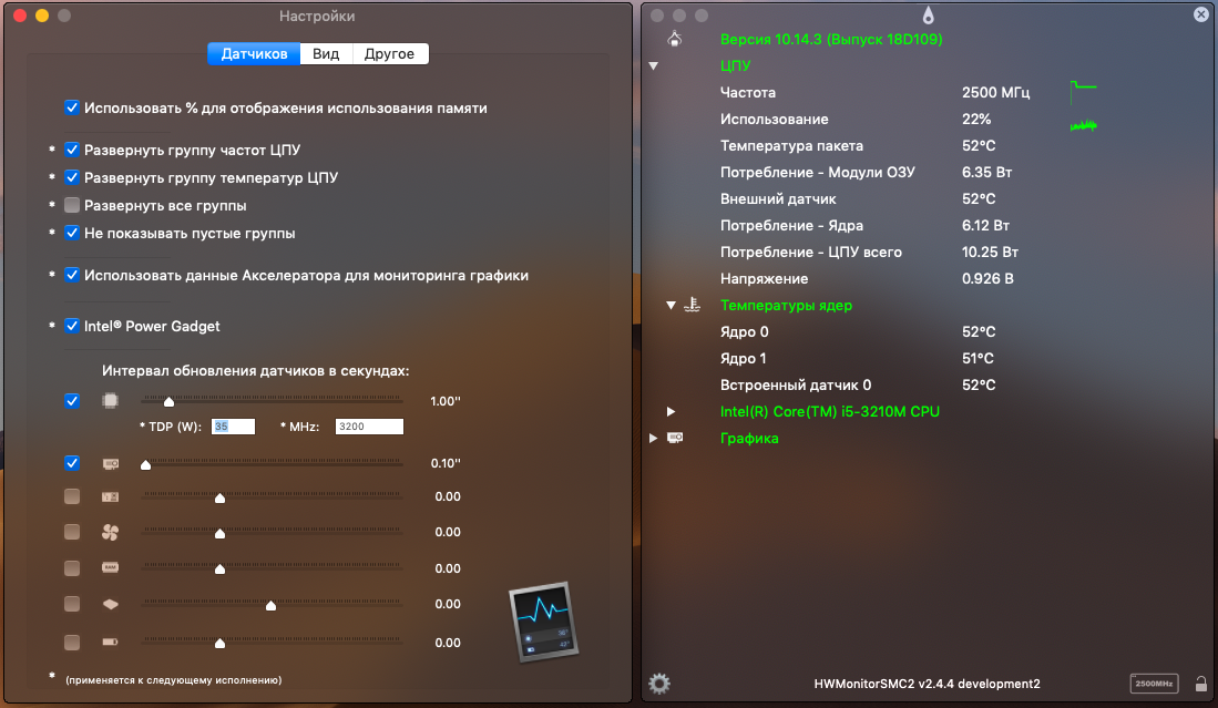

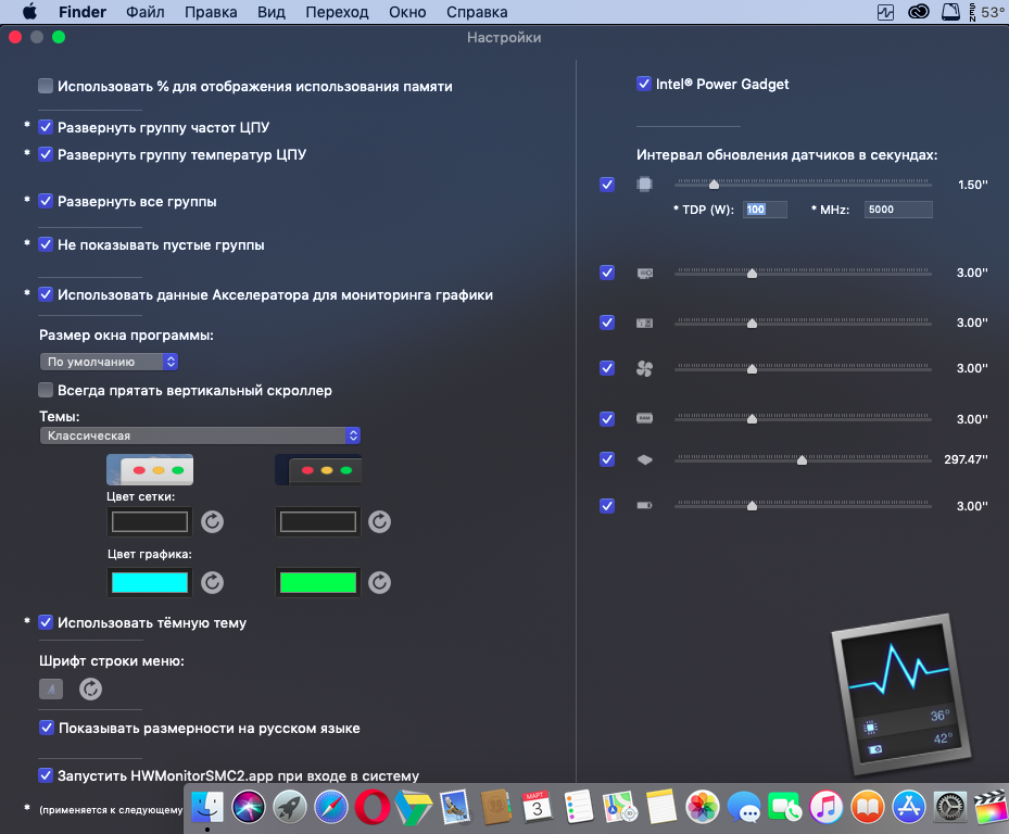

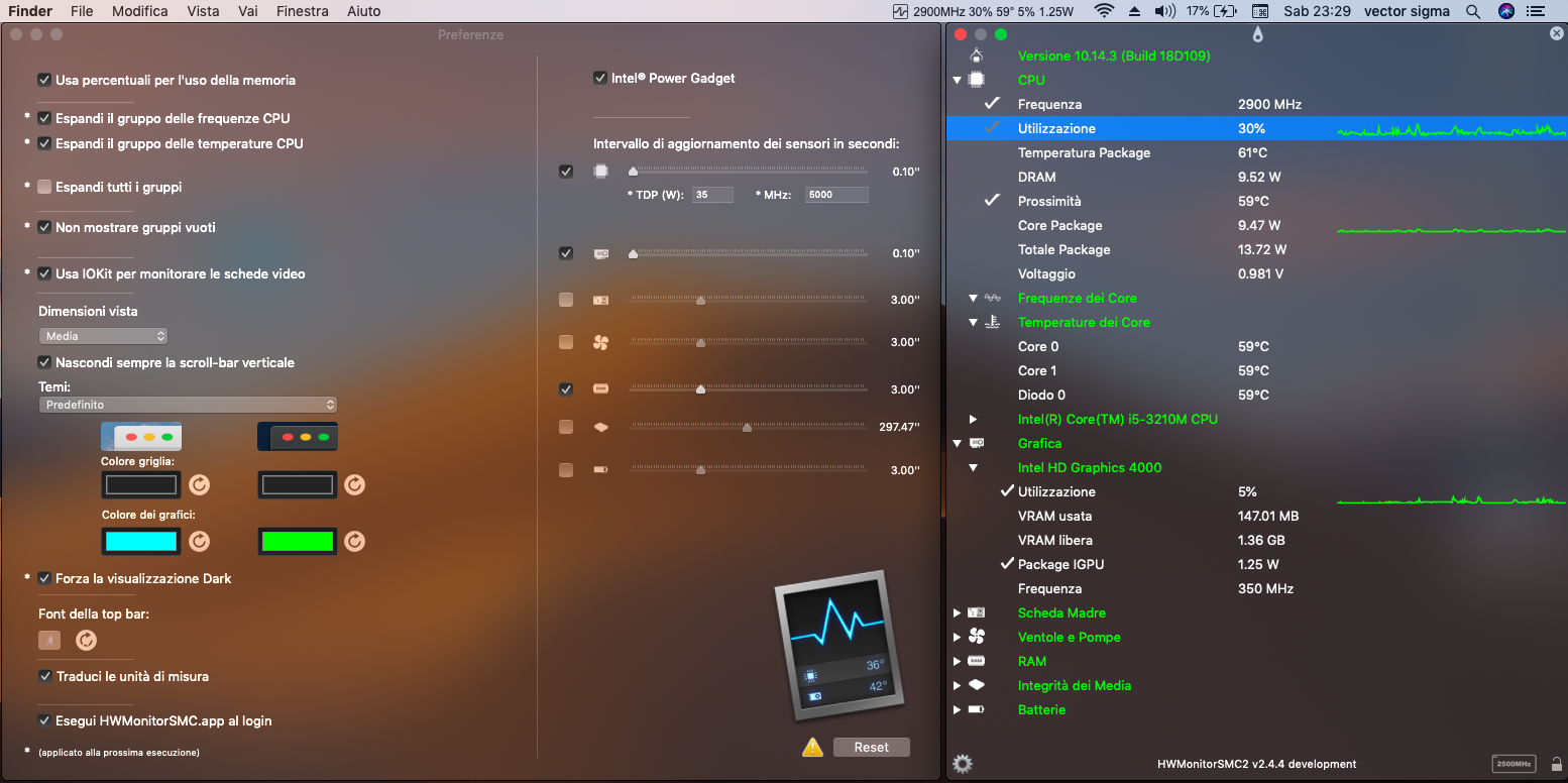

Hi all, finally I had the time to update the app with new functionalities:
GPU detection:
New GPU parser that should take care of all GPUs in the system, no matter if external GPU. Anyway tested an egpu only with Sir @losinka , hope will be ok.
GPU dump:
create a directory called "HWGraphics" into your desktop. When the app starts (not during is running) a dump with a snapshot of the IO will be created for each card in the system inside the mentioned directory.
Interface:
General improvements for the interface, i.e how the dark or light appearance is detected and updated. Tested only in 10.14 and 10.13 and honestly I don't know how behave in 10.12 and 10.11 since I no longer have them.
Top bar string Font and size:
Now the top bar string can be customized with the desired font and size in real time (Preferences)
Colors
The grid color can have a custom color. Probably someone already tried that in one of the betas made some time ago but this time you don't have to restart the app since is on the fly. You can set a color for the light mode and one for the dark mode.
The same for the plot line (charts)
Themes:
Themes are the same, but now the default one is blurred without any grid. The old Default with grid and alternated colored rows is now called "Classic" and is ready to be selected.
You can now change theme in real time and see the difference immediately.
Size of the view:
you can now choose between 3 level:
normal (as always)
medium
large
all is applied on the fly. If you have a high resolution display you will prefer an higher size of each row of the outline.
Full screen:
the detached window can now go in full screen.
Sensors excluding:
You can decide to exclude groups of sensors you don't are interested in... by deselecting them in the preferences. Require a restart of the app.
Intel Power Gadget bugs:
Probably you can experience, like me, that the app refuse to show the sensors because of an IntelPoweGadget crash (that happens for Intel app as well). When this happen the only way I found to make it working again is to repair permissions and rebuild the kernel cache and after a reboot will start to work again.
So if you want to use HWMonitorSMC2 anyway just create a file or a directory called "HWIgnoreIPG" into your Desktop and the app will work without using IPG.
Reset:
added a button to reset the preferences to its original state.
Update:
the settings window is now smaller and uses tabs:
new:
old:
Spoiler
1783867310_Schermata2019-03-02alle23_29_31.thumb.png.ce99026859c10784026e9b5beead4e2d.png
HWMonitorSMC2_v2.4.4_development2
let me know
P.S. some translations may need to be updated
Edited by vector sigma
new update
it is a good idea to make some hwinfo, hwmonitor and hwsensors dumps in Windows and/or Linux
you will see there exact model of your Super IO chip and number of available sensors
Share this post
