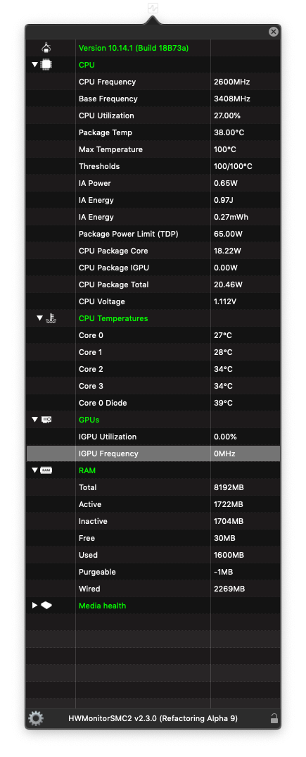

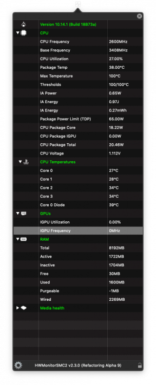

And this is screenshot of the HWMonitorSMC2 Alpha 9
Andres’s iMac.ioreg.zip
Edited by Andres ZeroCross

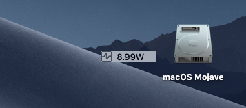

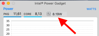

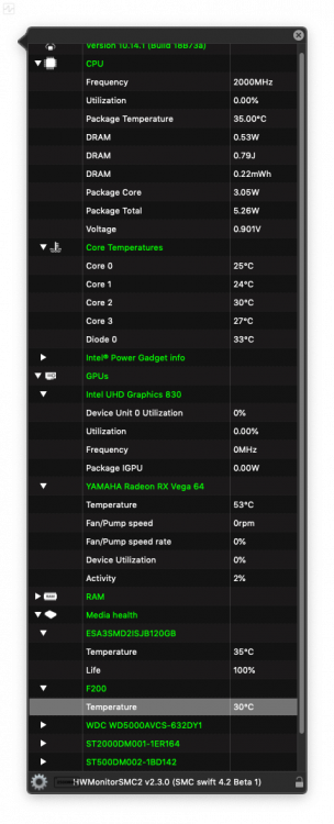

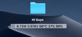

New app promoted to Beta:
  1. Added new translations in Russian by Andrey1970, Italian and English by me.
  2. Added check for Intel Power Gadget: cpu must be Intel (Lol), family 6, model > 42, i.e >= 2nd generation of "Core" models. Xeon models 42, 46 and 47 are supported as I see that they can work (anyway SMC keys if present will be entirely read).
  3. Moved CPU Package IGPU inside the GPU group. If the IOAccelerator's monitoring is turned on that key will be added inside the Intel sub group.
  4. Tried to fix pulsations of the text in the top bar. Need a confirmation.
  5. New: instead of display sensors in the top bar, you can now display a gadget that you can place where you like. This gadget is always on top of other windows... so that you can now compare, run programs or make a test stress cosily observing the value you need. see the pictures:
1.png.a4bf19c452f3b4604b6fcd806ddbf79f.png2.png.9d3feecaa0104cd77d38b01ae8c6649f.png3.png.c22f075a324284990d36092fd83bbf76.png4.png.78f138f3da72004d197c1ab2fbb87ea3.png
Let me know.

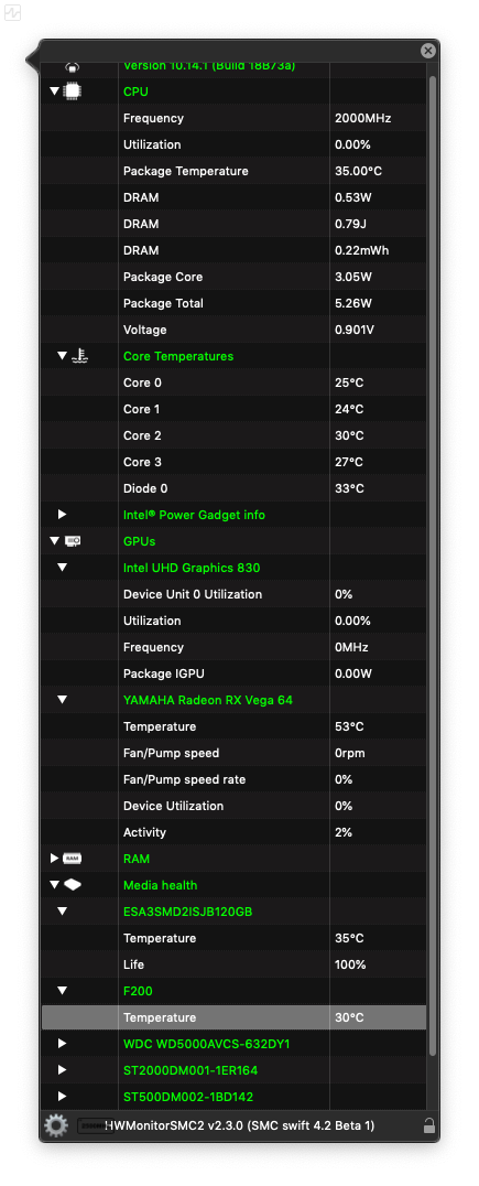

Working good,, but my SSD (Fujitsu F200) still not get health status
Share this post
Link to post
25 minutes ago, Andres ZeroCross said:
Attached..
Thanks I'll take a look tomorrow
Sorry I really did not found any specification for that. Can you show me a dump from Windows where I can take a look on the attributed used for the values you are looking for?

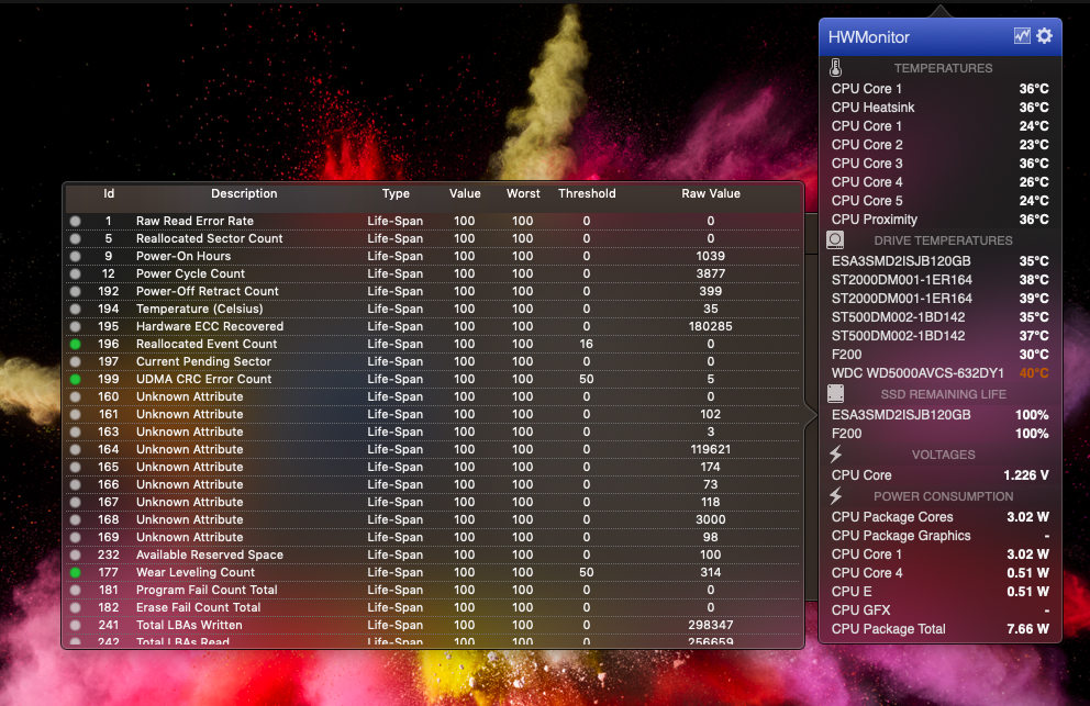

11 minutes ago, vector sigma said:
If I knew it, I would not have asked you :wink_anim:. Usually they are under "vendor specific data" that for ATA/SATA any Vendors can place where they like since the standard allow that (allow even to omit them).
Anyway, most of the programs that dump smart attributes usually publish the attribute for temperature, life etc.. just find one.

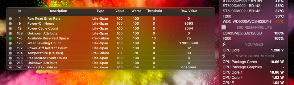

Just for your information, this screenshot from HWMonitor from FakeSMC
A. This is for ESA3SMD2ISJB120GB (Life percentage is detected with HWMonitorSMC2 too)
A. This is for Fujitsu F200 (Life percentage is not detected with HWMonitorSMC2)
I think id 173 from F200 (Wear leveling count) is as reference for life percentage,, many SSD use id 177 as Wear Leveling Count. Sorry, just my opinion
 IGPU Packages does not change the indication.
It is not necessary to remove IGPU Packages when IOAccelerator's monitoring is turned off.
Most likely a bug because of it.
Sorry  but, this surely is not from FakeSMC: S.M.A.R.T in macOS is a library embedded with the OS itself and the only way is to query the dedicated driver, no need to reinvent the wheel ;).
Anyway It is a losed war. If you know where they are you can read it, otherwise there are tens and tens of ssds who no one knows where to look because these values aren't mostly never published. The attribute 173 (not 177 which is already taken into account) is really uncommon from the rest of the world and in fact I have my doubts that HWSensor can read S.M.A.R.T from every ssd in commerce, and as far as I know he cannot read S.M.A.R.T from NVME while HWMonitorSMC2 can :wink_anim:.
Try that: HWMonitorSMC2.app_SMC_swift4.2_Beta2.zip (may be the need of more attempts if some bytewise is needed)
