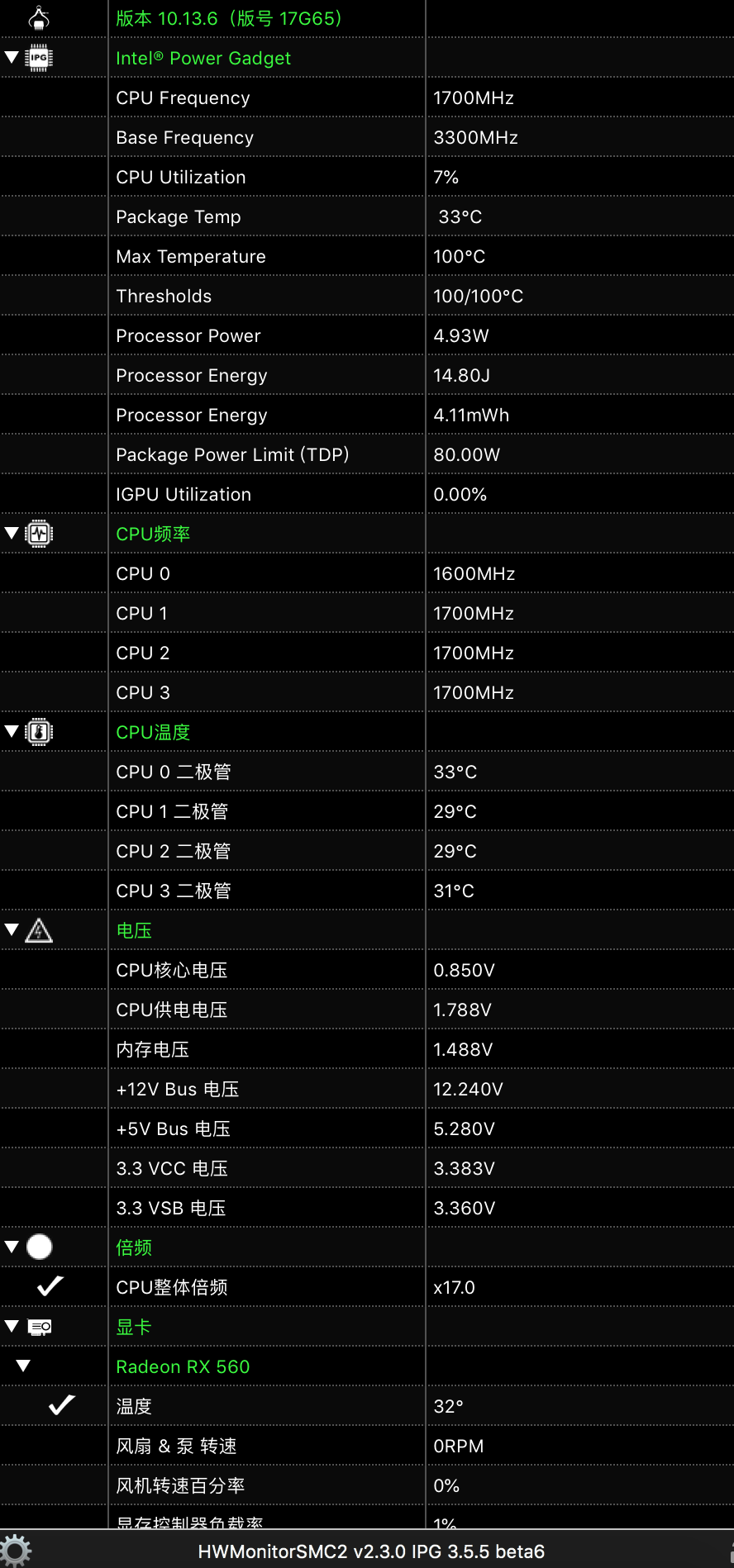

@thenightflyer, please try that: HWMonitorSMC2.app_beta5.zip (a doubt that this is cause by the localization system), let me know
I compiled source from github but i only get "HWMonitorSMC2.app version 2.3.1. Did you put the source for Beta 5 at Github???

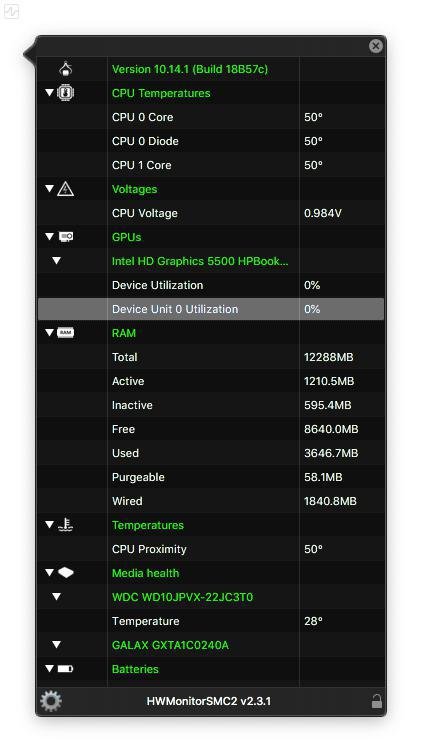

Nice sensor with VirtualSMC.kext version 1.0.1

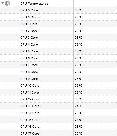

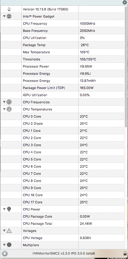

30 minutes ago, fabiosun said:
here you can see also other results with HWsensorSMC2 old and new release with Virtulasmc on the left
Fakesmc on right part of my image
Yep, I had never seen Hex values with G and H (missing cores)
Quote
TCGC
TCHC
:hysterical:... just because they aren't. Il'' fix it.

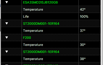

Btw,, My F200 is SSD too. But Life value is not shown. Any clue???

6 minutes ago, Andres ZeroCross said:
Thanks for the response, maybe i should wait for new plugin for VirtualSMC.kext. again, thanks very much
Sent from my Mi Note 2 using Tapatalk
Here I can help. Mechanical hard drives do not have a life to read, so you'll never see it. This happens also with some old ssd, and also some unknown ssd, that, because any vendor can set the life attribute in any places in a sub structure called "vendor specific data" inside the 512 bytes of the S.M.A.R.T atrributes. Therefore it is not guaranteed that Life will always be displayed even for them.

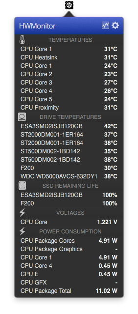

Owh, but i am pretty sure life value is shown with FakeSMC.kext and plugin. Do you think this issue is related to plugin of FakeSMC.kext too??
image.png.c0f27aace7f6c77d7fd70707adb5e363.pngI use HW Monitor with VirtualSMC.kext and plugin (not FakeSMC.kext). See this
Also my Galax SSD is not shown status of life (my notebook) :)
I don't think this is due to the SMC keys, but from S.M.A.R.T instead. As I said the app should know where to look for the life attribute, and your F200 then is an SSD... unknown at least for me. Can you point me to the data sheet of that disk?
Fujitsu F100 = https://www.fujitsu.com/hk/Images/F100-SSD-datasheet.pdf
Galax 240GB Gamer series : http://www.galax.com/en/ssd/gamer-series/galax-gamer-ssd-l-240gb.html
Sorry i can't search data sheet for GALAX, just official site :)

No luck finding it, but I'll take into account to let you dump the smart attributes with a test version of HWMonitorSMC soon.

6 hours ago, fabiosun said:
less of usual..but maybe new one cores appear (16 and 17)
new function I created was bad:
- (NSString *)smcFormat:(int)num {
  if (num > 15) {
    for (char c = 'A'; c <= 'Z'; c++) {
      int i = (int)c - 55;
      if (i == num) {
        return [NSString stringWithFormat:@"%c", c];
  return [NSString stringWithFormat:@"%d", num];
corrected:
  if (num > 15) {
      if (i == num) {
  return [NSString stringWithFormat:@"%.1X", num];
should work now.
HWMonitorSMC2.app_IPG_beta6.zip
