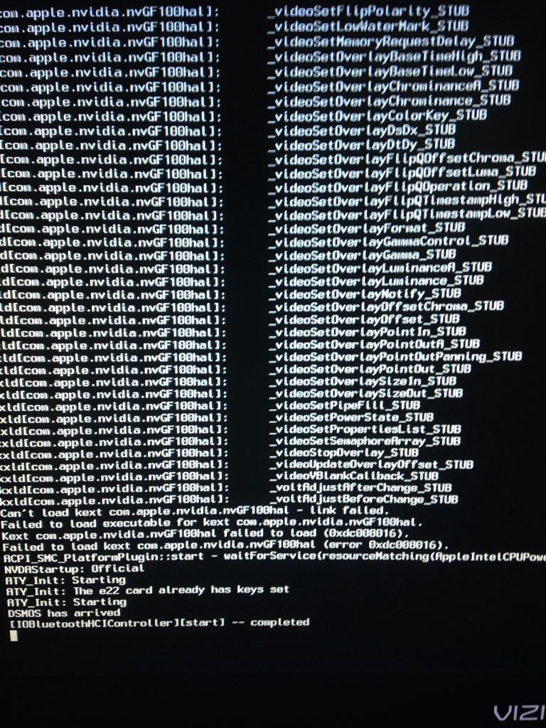

Nehalem32 Posted June 20, 2014 Share Posted June 20, 2014 Hi, my Hackintosh with iATKOS ML2 began to freeze on occasion after I installed the 10.8.5 Combo update. At first I thought it was Chrome causing it because it kept happening when I clicked on text boxes, but then it began to start happening just by doing anything. So, I took a look at console and I'm still not sure what's causing it. Here's the log of it before I rebooted: http://pastebin.com/D3yWZGbN My Build: CPU: Intel Core i3 2100 GPU: NVIDIA GeForce GTX460 MB: ASUS H61-M LX3 R2.0 Startup Flags: GraphicsEnabler=Yes -v Link to comment Share on other sites More sharing options...

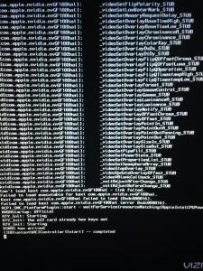

Nehalem32 Posted June 20, 2014 Author Share Posted June 20, 2014 I removed those kexts and it worked. Then I installed the NVIDIA kexts and now I am unable to boot. Here's a picture of where its stuck at I replaced the kext with the old one and it boots. However it won't let me past the login screen. Link to comment Share on other sites More sharing options...

Nehalem32 Posted June 20, 2014 Author Share Posted June 20, 2014 The GPU, NVIDIA GeForce 460 I went into Safe Mode and reinstalled those kexts just to be sure and I used the PCIROOTUID stuff but I'm still stuck at the same startup like in the screenshot I posted I also turned off GraphicsEnabler but it's still yielding the same results from the screenshot Link to comment Share on other sites More sharing options...
Gringo Vermelho Posted June 21, 2014 Share Posted June 21, 2014 This is why retail installs are better. With distros you never know what you get, and if you don't try to find out, then you run into surprises like this. Don't use two video injection methods at the same time! Remove Netkas' ATY_Init.kext, it's conflicting with GraphicsEnabler. Boot in safe mode and install the nvidia web drivers for 10.8.5 so that you get rid of any iatkos modified nvidia driver files, looks like something is terribly wrong with NVDAGF100Hal.kext Link to comment Share on other sites More sharing options...
