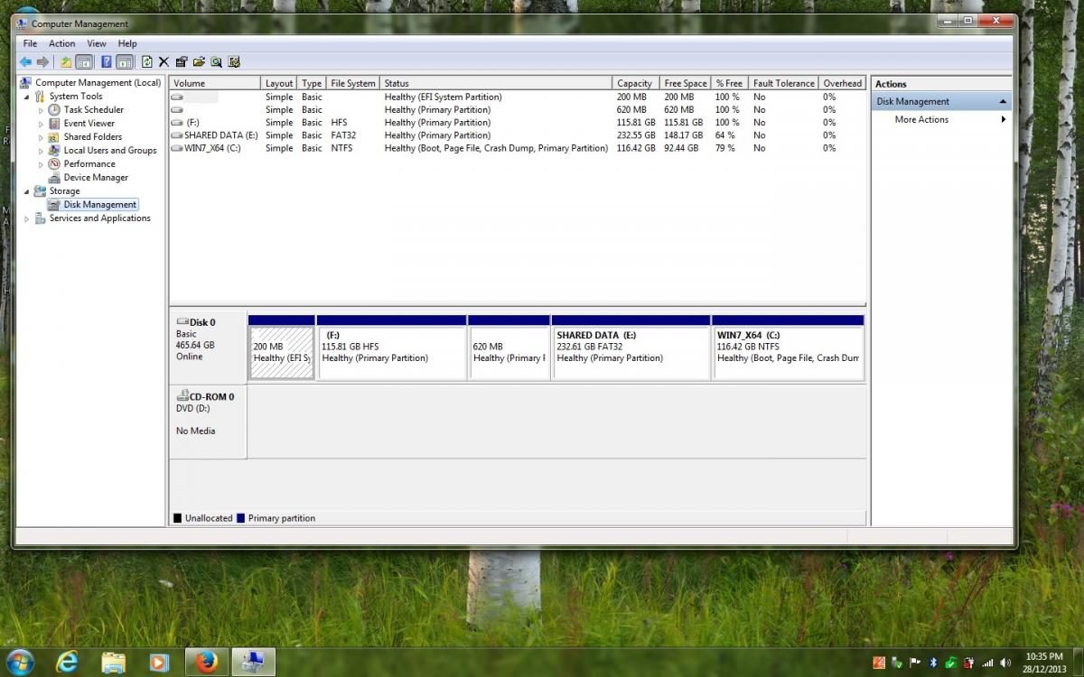

fusion71au Posted April 6, 2014 Share Posted April 6, 2014 Try Recovering the Windows Bootloader with EasyBCD - follow instructions under "Type1" repair to write Windows boot code to MBR. Also how to create a USB recovery drive and fixing the MBR manually: bootrec.exe /fixmbr bootsect.exe /nt60 all /force EditThe instructions above are applicable if you have Windows 8.1 installed under a legacy MBR or hybrid MBR partitioned hard disk. As kyndder mentions in post #6, if you have UEFI installed Windows in your machine, simply setting your BIOS firmware to boot UEFI only will ignore chameleon's boot files and boot through Windows bootmgfw.efi directly ---> faster boot. You can check with Windows Disk Management: UEFI Windows will have an EFI partition on the hard drive while legacy Windows has a "System Reserved" partition eg my UEFI Windows 7 has a 200MB EFI partition 1 Quote Link to comment Share on other sites More sharing options...
