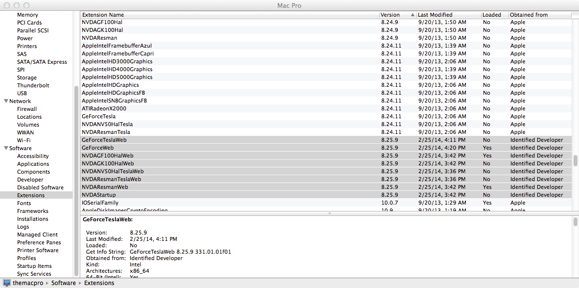

It's a nvram issue. The menu checks nvram for the nvda_drv argument. If it's not there it assumes the default drivers are loaded.
Check the Extensions section in System Profiler. If GeForceWeb is loaded instead of GeForce then you're on the nvidia drivers
Share this post
Link to post
Interesting, Geforce Web is loaded, and GeForce is not so it looks like I'm on their drivers.

Yeah you're on the web drivers then. The menu isn't finding the nvda entry in your nvram so it's defaulting to showing the OS X drivers as loaded.
The GPU clock thing is in nvidia's hands. At least patching the OpenCL framework prevents undue wear and tear on the card in the meantime.
