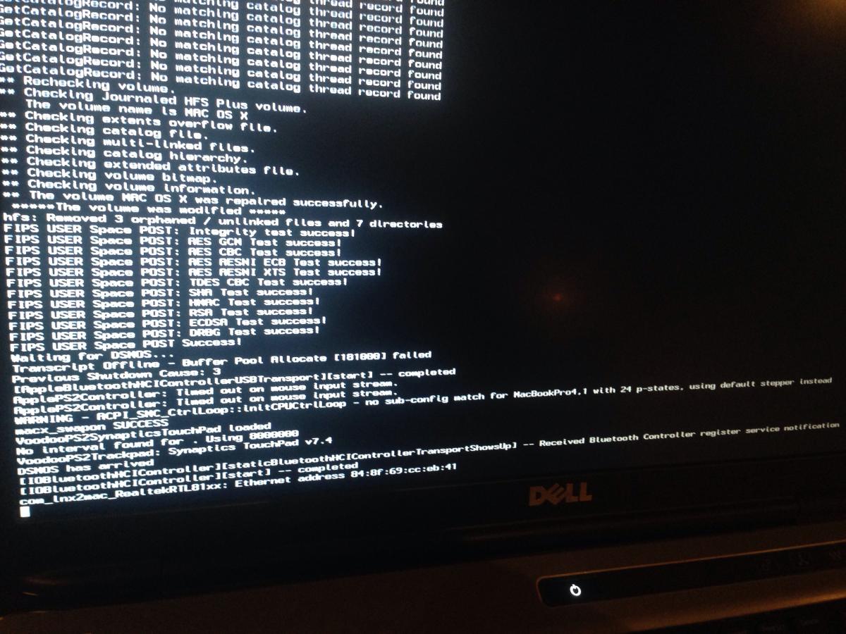

dave20v Posted January 23, 2014 Author Share Posted January 23, 2014 added that line into org.chameleon and im booting with -v just to see whats happening it boots but im noticing a SNB Framebuffer did not show? and even tho I'm wanting 1920x1080 im only getting 1280x1024?? in about mac it says graphics is 64mb shared? im using the mac mini 5,1 profile as macbook pro 8,1 doesnt boot Quote Link to comment https://www.insanelymac.com/forum/topic/295479-dell-xps-17-l702x-i5/page/2/#findComment-1987872 Share on other sites More sharing options...
Pimentel Posted January 23, 2014 Share Posted January 23, 2014 HelloIn here a guide to enable your graphic: http://olarila.com/forum/viewtopic.php?f=28&t=2193I never have HD3000 graphic, i always use dedicated(Nvidia), so i don't have much knowledger about how enable Intel HD3000... The guide teach everything, you'll need read to undestand. Good Luck! Don't forget about power management IT'S VERY IMPORTANT! Quote Link to comment https://www.insanelymac.com/forum/topic/295479-dell-xps-17-l702x-i5/page/2/#findComment-1987876 Share on other sites More sharing options...

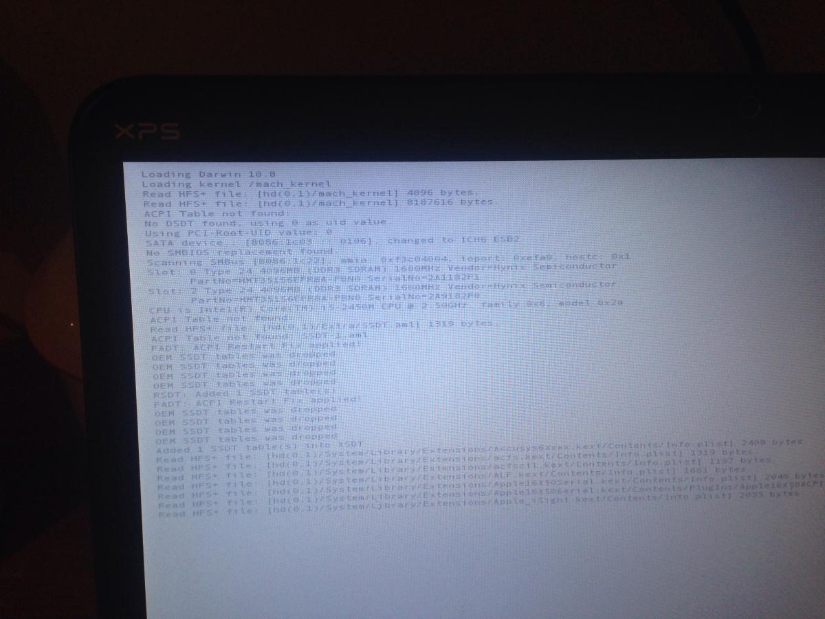

dave20v Posted January 23, 2014 Author Share Posted January 23, 2014 yeah i followed that guide to power management but not sure its done right! on startup using -v i notice at the top says dsdt not found and something to do with ssdt using oem? what is the snb frame buffer all about? also i did the sound text but thats not working Quote Link to comment https://www.insanelymac.com/forum/topic/295479-dell-xps-17-l702x-i5/page/2/#findComment-1987880 Share on other sites More sharing options...
Pimentel Posted January 23, 2014 Share Posted January 23, 2014 HelloAll you need do is generate your SSDT via command and some adjusts....Put these commands in terminal(to generate SSDT)and after, if terminal want, you need put your Max Frequence and Max TPD of you CPU, you need see these values in here: http://ark.intel.com/The values that have in guide is only a example(i7 2600)you need put you own values, values of your CPU Rename ssdt-pr to SSDTAll things are explianed in there... don't forget patch AICPUPM-------------------------------------------------------------------------------------------Like i said.... i never used HD3000, so you'll need read to undestand... sorry but with graphic acelleration, you need follow this step alone.-------------------------------------------------------------------------------------------Sound isn't work? Did you tried VoodooHDA? what's your codec? Quote Link to comment https://www.insanelymac.com/forum/topic/295479-dell-xps-17-l702x-i5/page/2/#findComment-1987893 Share on other sites More sharing options...

dave20v Posted January 23, 2014 Author Share Posted January 23, 2014 just ran AICPUM and when i put perl AICPMPatch.pl/System/Library/Extensions/AppleIntelCPUPowerManagement.kext/Contents/MacOS/AppleIntelCPUPowerManagement it says permission denied??? Happy ive done the SSDT correctly with pikes script and rename in extra folder sorry forgot sudo! right think thats all done correctly how do i know if its done right and way to check? Quote Link to comment https://www.insanelymac.com/forum/topic/295479-dell-xps-17-l702x-i5/page/2/#findComment-1987904 Share on other sites More sharing options...
Pimentel Posted January 23, 2014 Share Posted January 23, 2014 Hello sudo help me in many cases sudo perl AICPMPatch.pl /System/Library/Extensions/AppleIntelCPUPowerManagement.kext/Contents/MacOS/AppleIntelCPUPowerManagement patch sudo perl AICPMPatch.pl /System/Library/Extensions/AppleIntelCPUPowerManagement.kext/Contents/MacOS/AppleIntelCPUPowerManagement --patch after udpate cache.... Quote Link to comment https://www.insanelymac.com/forum/topic/295479-dell-xps-17-l702x-i5/page/2/#findComment-1987916 Share on other sites More sharing options...
