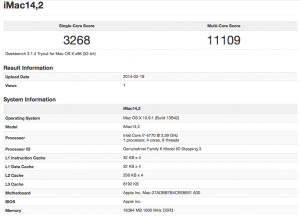

slave-zeo Posted February 19, 2014 Author Share Posted February 19, 2014 2/18/14 7:07:43.000 PM kernel[0]: MSRDumper PStatesReached: 8 34 35 36 37 38 I get this with MSRDumper.kext, so it looks like the freq scaling is working. Just thought id share it. Link to comment https://www.insanelymac.com/forum/topic/294057-dell-xps-8700-haswell-system-109-mavericks/#findComment-1995381 Share on other sites More sharing options...

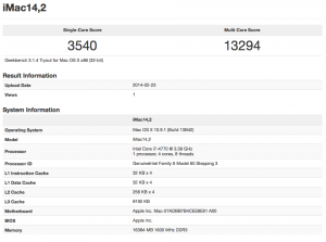

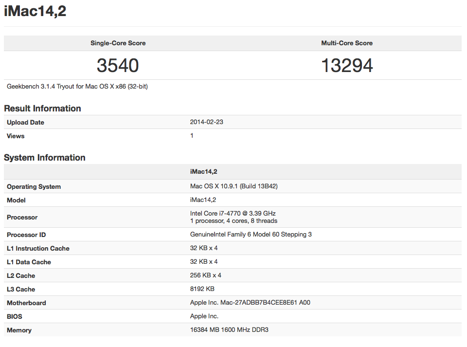

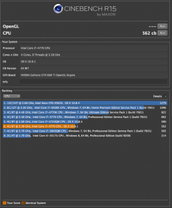

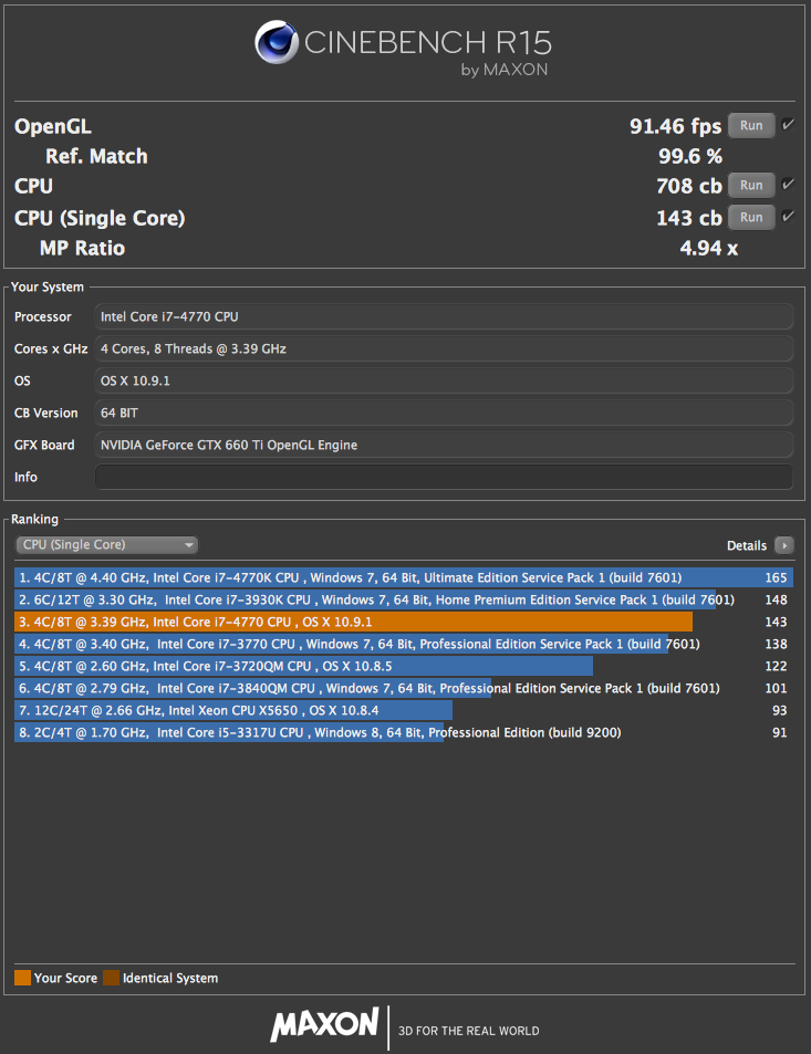

slave-zeo Posted February 23, 2014 Author Share Posted February 23, 2014 I re-ran Cinebench with nothing else running (as it suguests) and this is what I came up with, 708cb. For reference, I get 750cb in windows 8 on this same computer. So it's not that far off. Same goes for Geekbench 3 32-bit. I managed to squeeze out 13,294. I can't remember what I got in Geekbench under Windows for comparison, but it was very similar in the low 13k range. Link to comment https://www.insanelymac.com/forum/topic/294057-dell-xps-8700-haswell-system-109-mavericks/#findComment-1996688 Share on other sites More sharing options...
