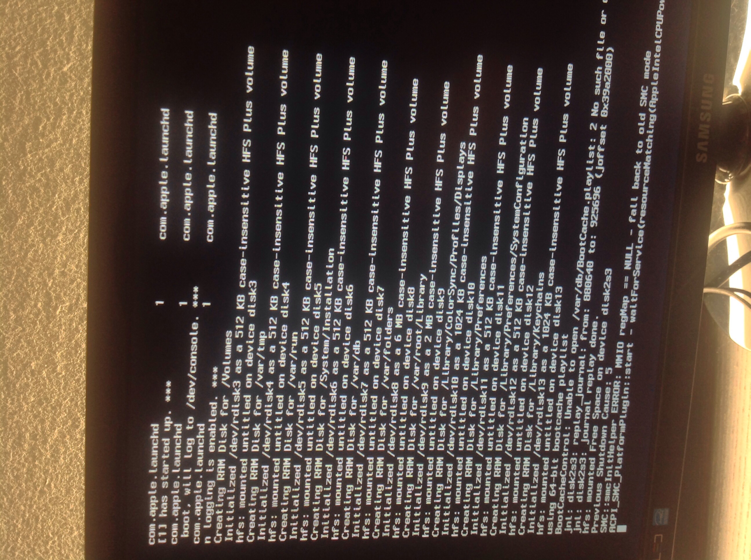

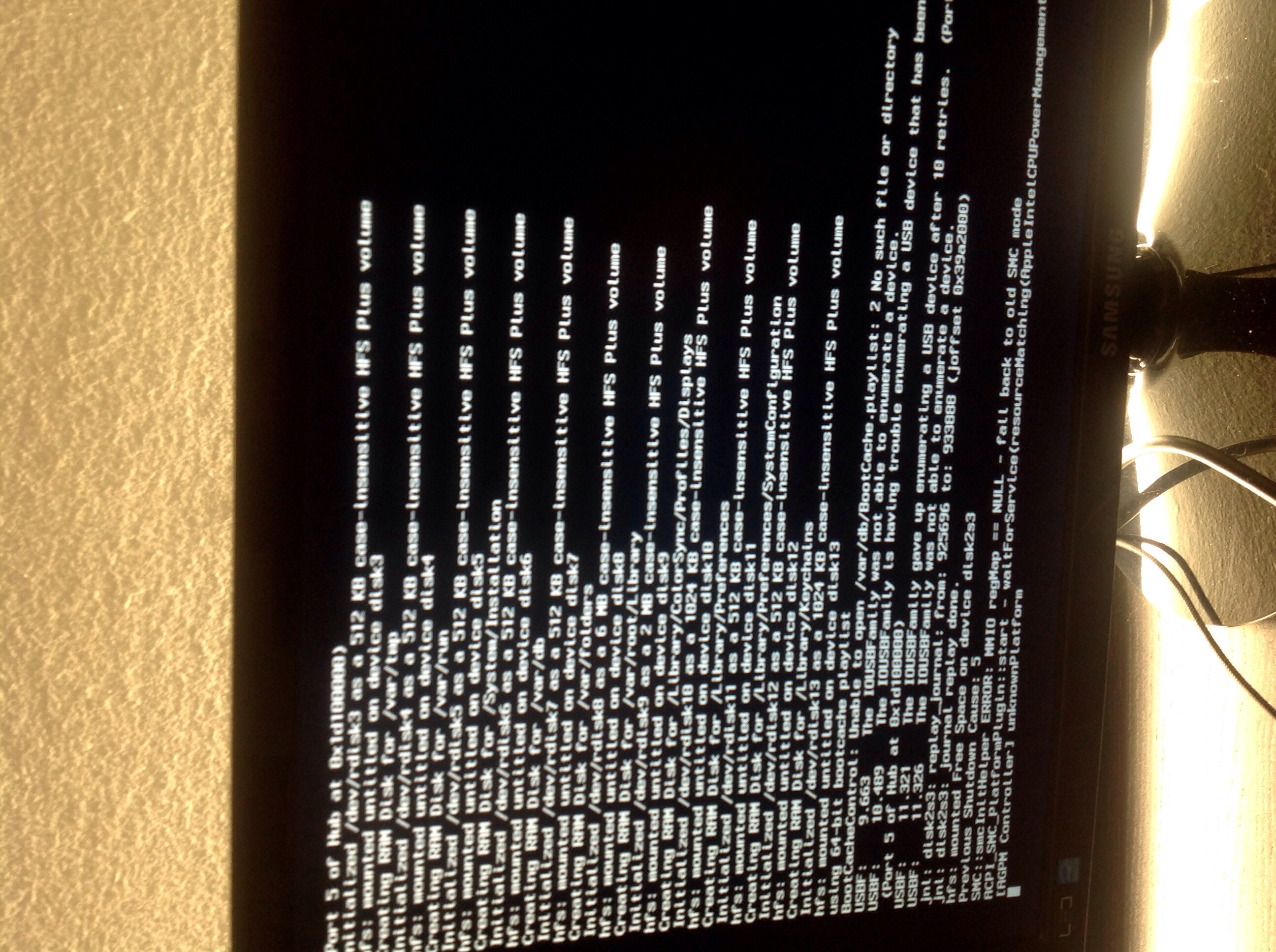

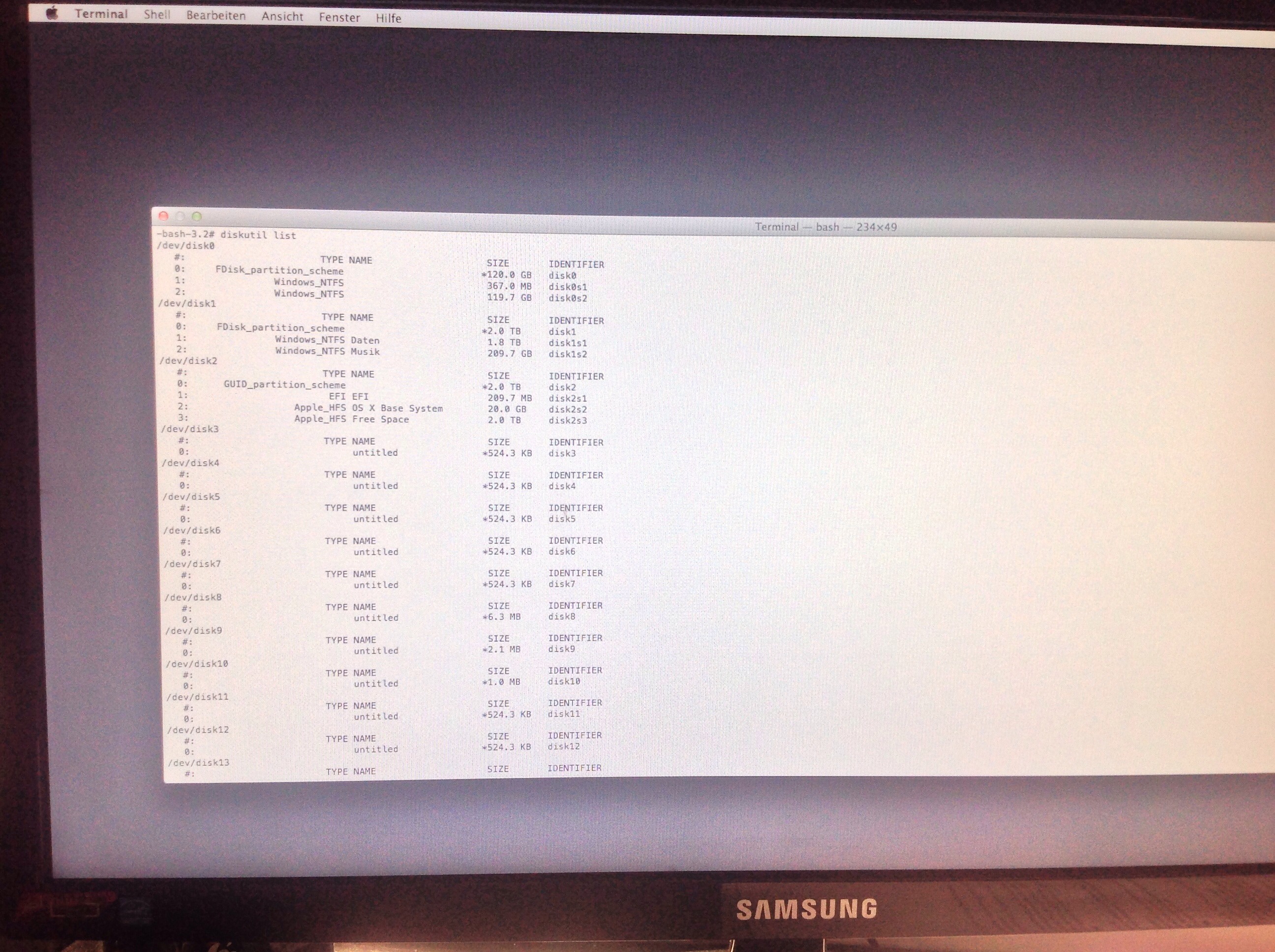

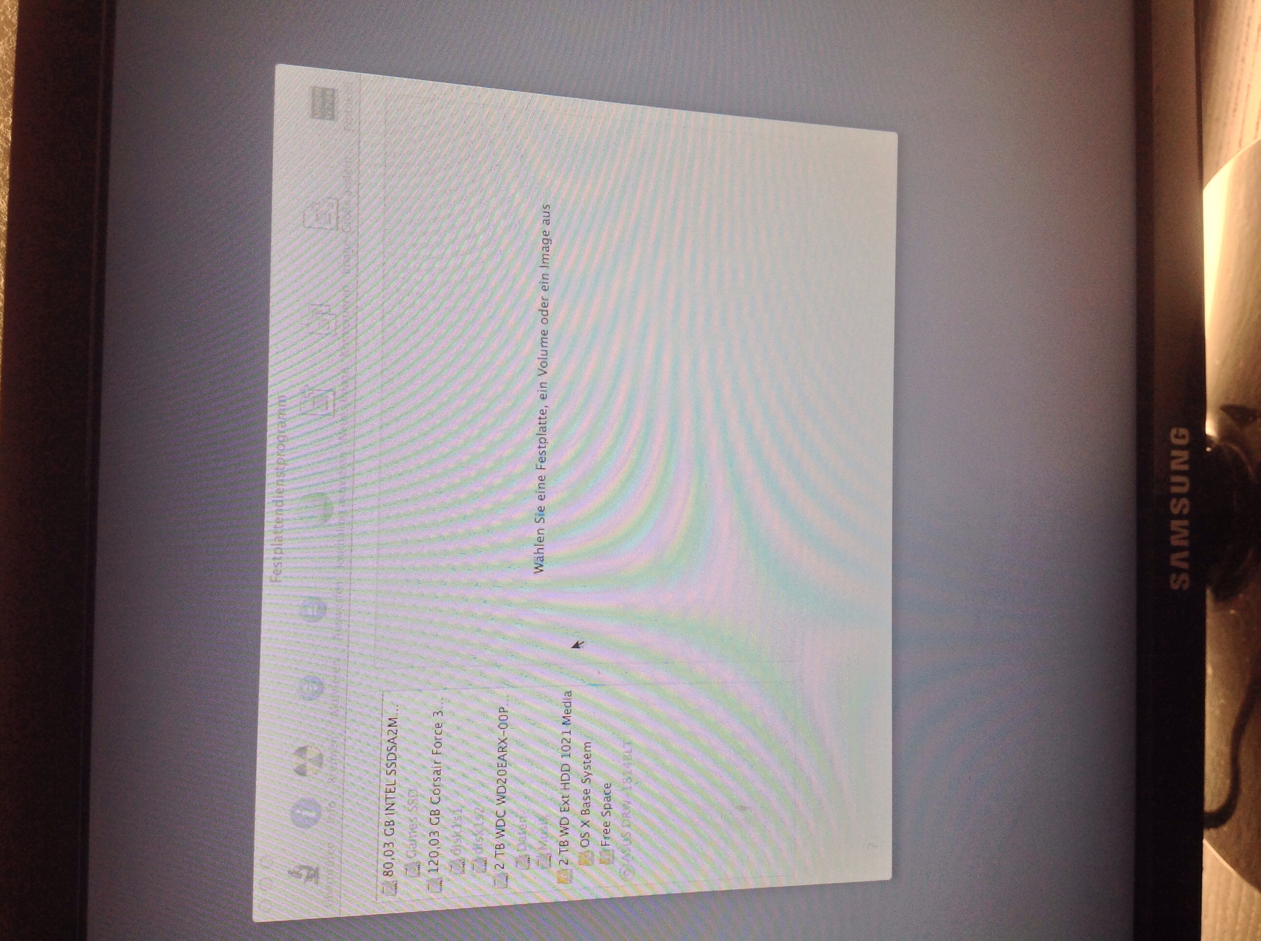

n6n43hix Posted October 25, 2013 Author Share Posted October 25, 2013 so, i've tryed it with the 2 partitions now, and it worked. then i booted de osx install with -v and first it showed me a ton of different errors. i cant remember them all, is there a way to get a log of those? now my screen is standig at the position in the screenshot, i can hover trough both screens with my mouse and the rainbow wheel is spinning for about 10 mins, but nothing happens :/Booted with -v -x, now it works.. edit: {censored}, the installer don't shows my intel ssd as destination for the installation.. what i'm gonna do now? i think i must prepare it for the installation, format as mac hd or so? edit2: found the hd tool in the installer at top. that shows my corsair and the wd drive, but still no intel ssd :/ edit3: restarted the system, taked a screenshot of the last errors with my ipad. edit4: done a 'diskutil list' in the terminal of the installation.. screen below. one ssd is missing :/ on boot pressing f8 it shows my intel ssd.. maybe there is a problem because on that ssd it has a 200mb partition with bootinfos for win8? Link to comment Share on other sites More sharing options...
rlf Posted October 25, 2013 Share Posted October 25, 2013 In BIOS, set SATA to AHCI. On the motherboard, you have 3 hard disk controllers. The connectors are blue, grey and red. Move the Intel SSD to a different color, perhaps the same color as the Corsair. The red connectors probably won't work until you install another kext. Link to comment Share on other sites More sharing options...
n6n43hix Posted October 25, 2013 Author Share Posted October 25, 2013 AHCI Mode was always on. My SSD's are both on the grey connectors, i swapped them - no change. swapped ssd with wd hdd on the blue connector - still no change. Link to comment Share on other sites More sharing options...
rlf Posted October 25, 2013 Share Posted October 25, 2013 I don't know what to tell you. There is something about the Intel SSD that OSX just doesn't like. If you want to experiment, you can install OSX to the 1.98 TB Free Space partition. Or if you want to keep some of that 1.98 TB for data, you can resize the 1.98 TB partition and create a new partition. Link to comment Share on other sites More sharing options...

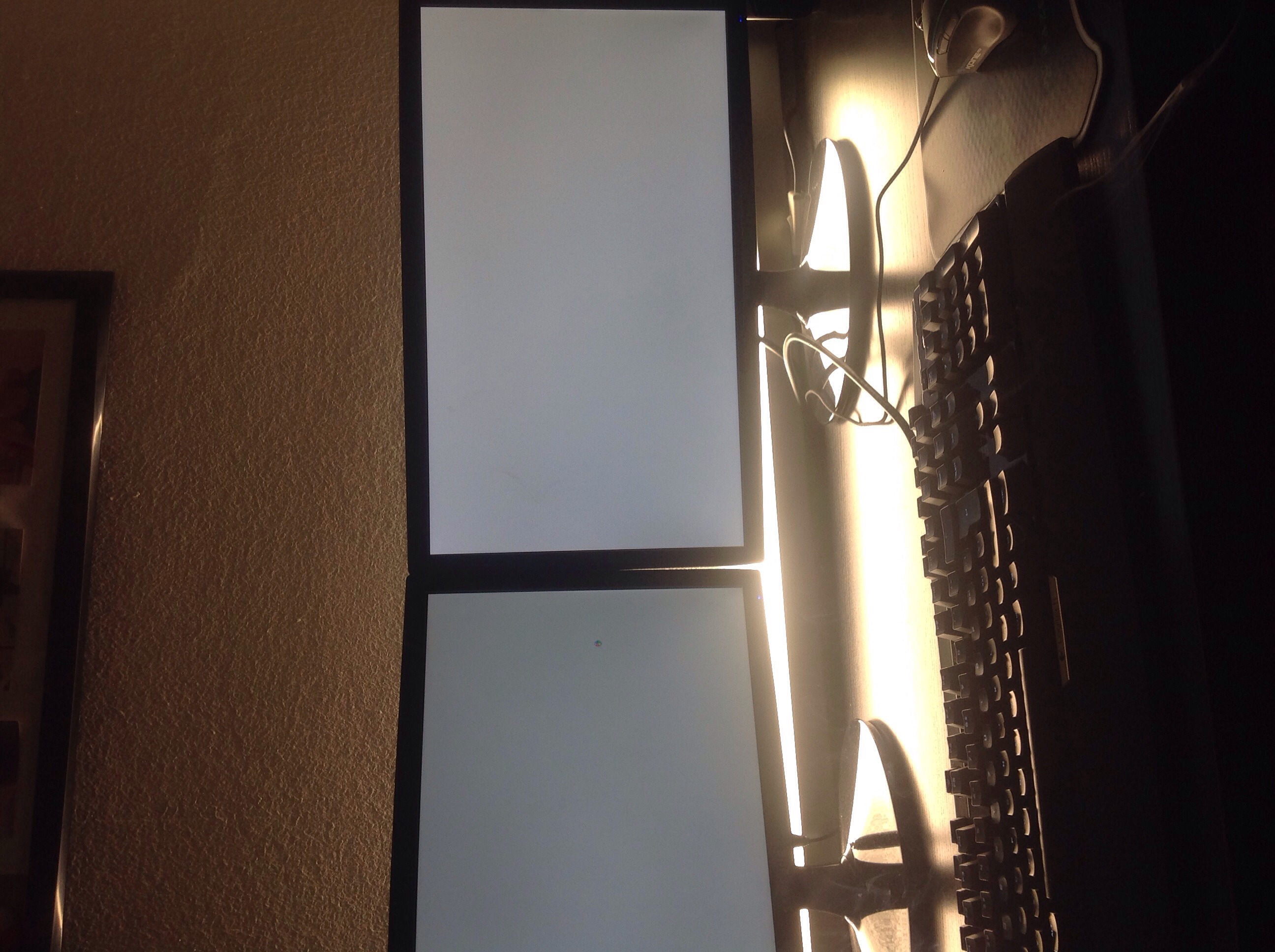

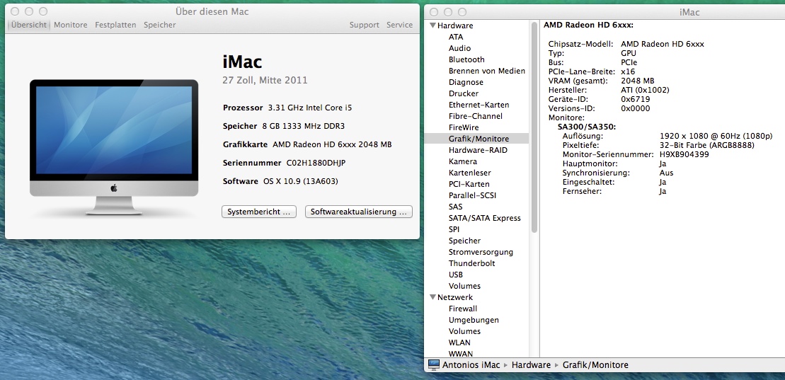

n6n43hix Posted October 26, 2013 Author Share Posted October 26, 2013 Hey i managed to install the .kext file for the network, so now i'm writing in this forum from my osx system So, for now, my graphics don't work like i wish, its all very slow and looks like {censored} wenn i open anything. Whats the solution for this problem? I boot in verbose and safe mode, if i don't, it boots so fast and the screen turns white so i never could read the errors getting there. Are they logging anywhere? Cheers! Edit: and only one screen is working, the other one is completely white Edit2: i don't manage to install the boot loader on my hdd, because in finder when i wanna copy the 'extra' folder to my drive, i'm not able to find the hard disk Edit3: solved the finder problem xD Link to comment Share on other sites More sharing options...
rlf Posted October 26, 2013 Share Posted October 26, 2013 You do not have a good video solution. The HD6950 has problems with OSX that have never been solved. It was hoped that Mavericks would be better, but it doesn't seem so. There has been a partial solution that works in Mountain Lion but is unknown whether it will work in Mavericks. It involves substituting some old ML kexts, booting with the onboard graphics and then when booted, switching the HDMI cable from the onboard graphics port to the HD 6950. This gives full resolution but no hardware acceleration. You have several problems. Your onboard graphics are HD 2000 which are not very compatible. The kexts are old and might not work on Mavericks. You are driving two monitors rather than one. You can read about the fix on this page, 4th posting down: http://forum.netkas.org/index.php/topic,1845.390.html The link to the kexts: http://www.mediafire.com/download/aachen140zb1acv/ATI_HD_6950.zip Link to comment Share on other sites More sharing options...
